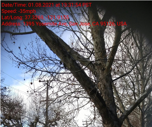

Step 1: Download OmniPreSense App
The app provided is located here. It says it works on any Android phone or tablet which supports USB OTG (On the Go). USB OTG lets the phone or tablet power the device connected to it, in this case the sensor which doesn’t draw much power. However, it does seem to draw enough that you should have your phone/tablet fairly charged up, say 40% or more.

Step 4: Connect Sensor to Phone
Next connect the USB OTG cable to the phone followed by the USB micro cable to the sensor. Make sure the USB OTG cable is connected to the phone side. Even though the combination is a USB micro to micro cable, you can’t plug them in the other way, or it won’t work.
Download the app on your phone and start it. You should see the flashing green light on the sensor and with a hand wave again you can see numbers reading on the phone. The app shows the readings but with my setting they go by very quickly so hard to tell what is the real speed. Fortunately, there’s a max speed measured reading. Assuming the golf ball is the fastest thing moving in front of the sensor then the max reading will display the golf ball speed.
