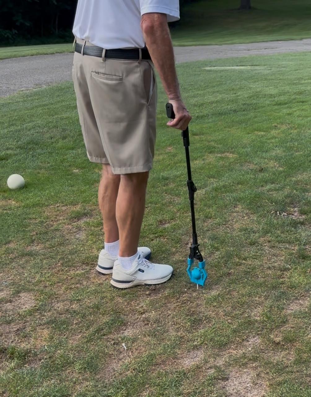

Many senior golfers and others with physical limitations have trouble bending over and placing a tee with a golf ball upon it in the ground on a golf course tee. Also, golfers with hip or knee issues cannot bend over to place the tee without a lot of pain. The need for a simple golf tee helper is apparent.
There are some commercial tee aids available that range in price from $50 to $200. I thought I could come up with a cheaper solution using a low-cost Grabber Reacher pick-up tool readily available for between $10 to $12. The grabber tool was modified to accept 3D printed closing arms with a golf ball/tee cup-like holder attached.

As described before, the right and left closing arms were printed to fit over the remaining 1-inch stubs of the Grabber Tool jaws. It was a very snug fit but there was still a little movement when the Grabber grip was squeezed tightly. I decided to glue the modified closing arms in place so there was no movement at all.
I used an epoxy 2-part glue system called “ClearWeld” made by J-B Weld. As you can see from the photos, I mixed the 2-parts together and then applied the epoxy to the inside of the “soft box” attachment housing on the end of the closing arm. I pushed each closing arm as far as it could go on the Grabber jaw stubs and temporarily placed the golf ball/tee cups in place. I then clamped close both golf ball/tee halves with a golf ball and tee in place. I used a rubber band for this purpose until the epoxy glue was set.
Step 5: Attaching Golf Ball/Tee Receptacle Halves to the Closing Arms
I tested the placement of the closing arm peg in each of the four cylinder holes on the back of the golf ball/tee cup shaped half. I found that when the closing arm peg was centered over the midpoint to lower half of the golf ball, the ball was held very secure when the Grabber grip was fully squeezed, but the tee seemed to have a lot of play and wobbliness. This did not work well when trying to place the tee in a hard and dry tee box.
It turns out, the lowest attachment hole that was applying pressure to the tee when the Grabber grip was squeezed, worked the best for tee placement. The golf ball was still held secure but the greater closing force to the tee area allowed the golf tee placement helper to lock the tee in place so the tee could be seated in dry and thinly mowed tee box ground.
The peg and hole attachment design was very snug between the back of the ball/tee receptacle and the closing arm. Just for good measure, I used common super glue to make the attachment permanent on both closing arms.
Step 6: Testing the “Golf Tee Placement Helper”
I tested the golf tee placement helper on a couple of different golf courses. See the attached videos. It seemed to work quite well; even when placing a tee in a dried out and hard tee box.
If the ball does fall off the tee as you loosen the grip, the tee placement helper can be used as a grabber to pick up the golf ball and sit it on the tee you just placed in the ground.
When not in use, the golf tee placement helper can be folded and placed in your golf bag or cart.
