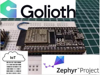

Introduction: Golioth.io | IoT Platform Series #3 (Part 1)
Golioth is an IoT platform that provides cloud services for embedded devices. Enabling everything that our devices need from the cloud, including device messaging, security, updates, analytics, and more.
They chose the Zephyr Project™, as the basis of their first embedded offering. Zephyr is an open-source, safe, secure, and flexible RTOS under the Linux Foundation. We offer the Golioth SDK - built on top of the Zephyr SDK - which we can use to quickly bootstrap an IoT application.
Hardware components
Adafruit HUZZAH32 – ESP32 Feather Board×1
Software apps and online services
Zephyr Project Zephyr RTOS
