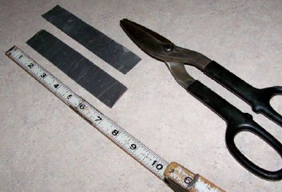

Step 1: Start Making the Antenna
Cut two strips of thin sheet aluminum 1 1/8 inch (3 cm) by 6 3/4 inches (17 cm). I considered cutting the aluminum from old soft drink cans. To get the needed length I would have needed to cut down the side and across the bottom. Do that if you have no other sheet aluminum.
