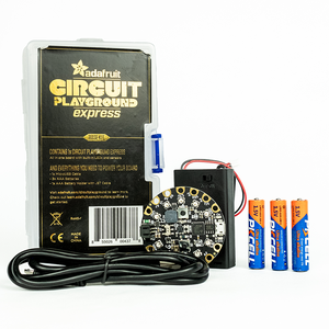

Hardware components :
  • Circuit Playground Express Board
  • ESP8266 ESP-12E CH340G
  • Micro USB cable
  • Battery cartridge + 2 Batteries

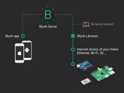

Website:
Adafruit Circuit Playground Express (Cpx)
Blynk IoT platform
Integromat website and services
Arduino IDE
Software + apps :
  • Blynk app
  • Integromat
  • Arduino IDE

Blynk
Download the Blynk App from Google Play.
Sign up to Blynk via the App.
You create a Blynk account after downloading the app.
This account is separate from the accounts you used for the Blynk Forums if you had one previously.
We recommend that you use a valid email address, as it will simplify things later.
A Blynk account is used to save your projects and enable access from multiple devices from anywhere.
After you have successfully logged in, create a new project and choose the right board (MKR1000).
Click to create.
The authentication token will be sent to you and also shown in the settings of your project.
A new number will be generated for each project you create.

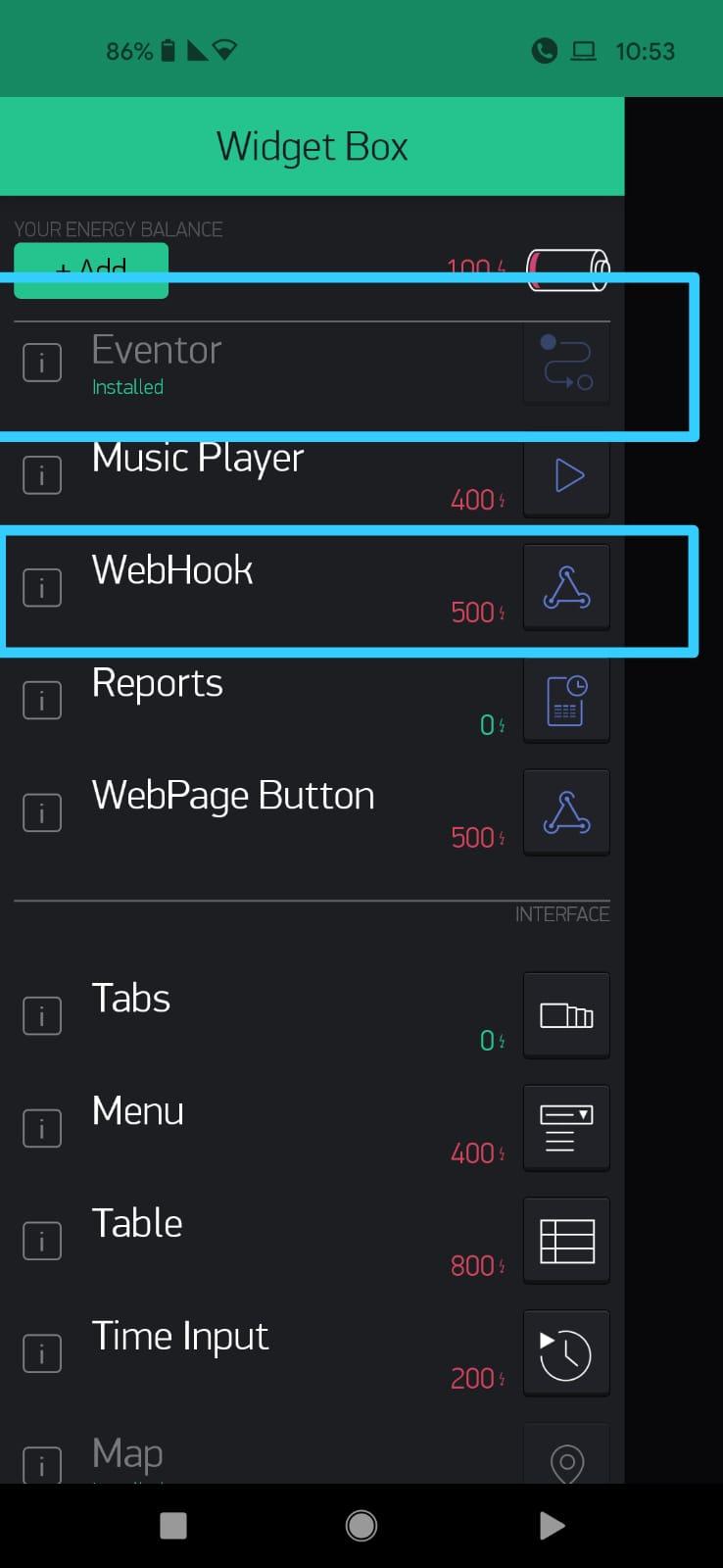

The canvas is empty, click anywhere on it to open the widget box. Here are all the available widgets.
Widget Settings - Each Widget has its own settings.
Tap on the widget to get to them.

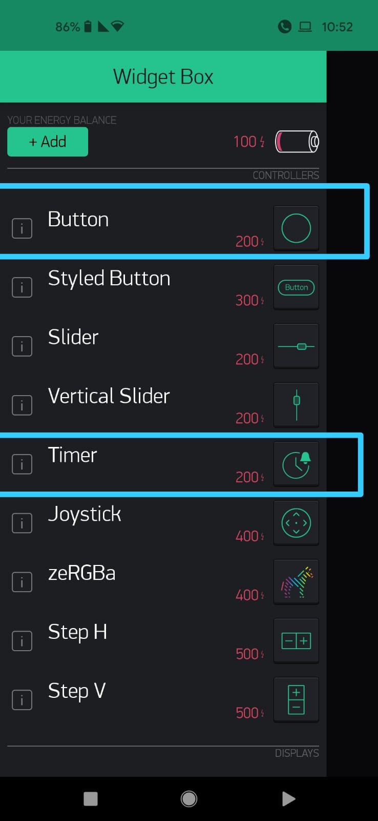

Step 2: Widgets We Will Make Use Of
Controllers:
  • Button
  • Timer
Displays:
  • Value Display
  • Gauge
  • LCD

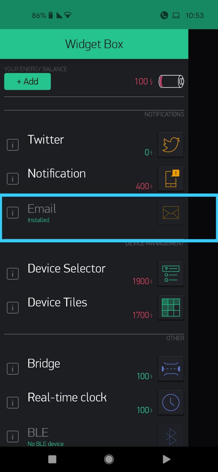

Notification:
  • Email
Other:
  • Eventor
  • WebHook

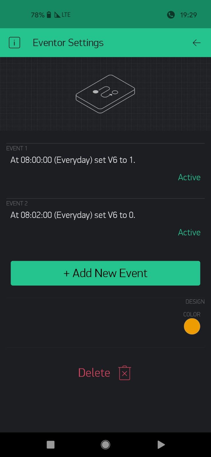

Step 5: Wake Up With the Cpx Alarm Clock: (Blynk + Cpx)
Blynk:
I added two widgets: Button and Eventor.
Eventor set with 2 events - At 8:00 AM it will turn on virtual pin V6 by setting it to 1, which activates the wake-up alarm.
At 8:02:00 AM it will turn off virtual pin V6 by setting it to 0.
Button: set for Virtual pin V6 and switched to switch mode.

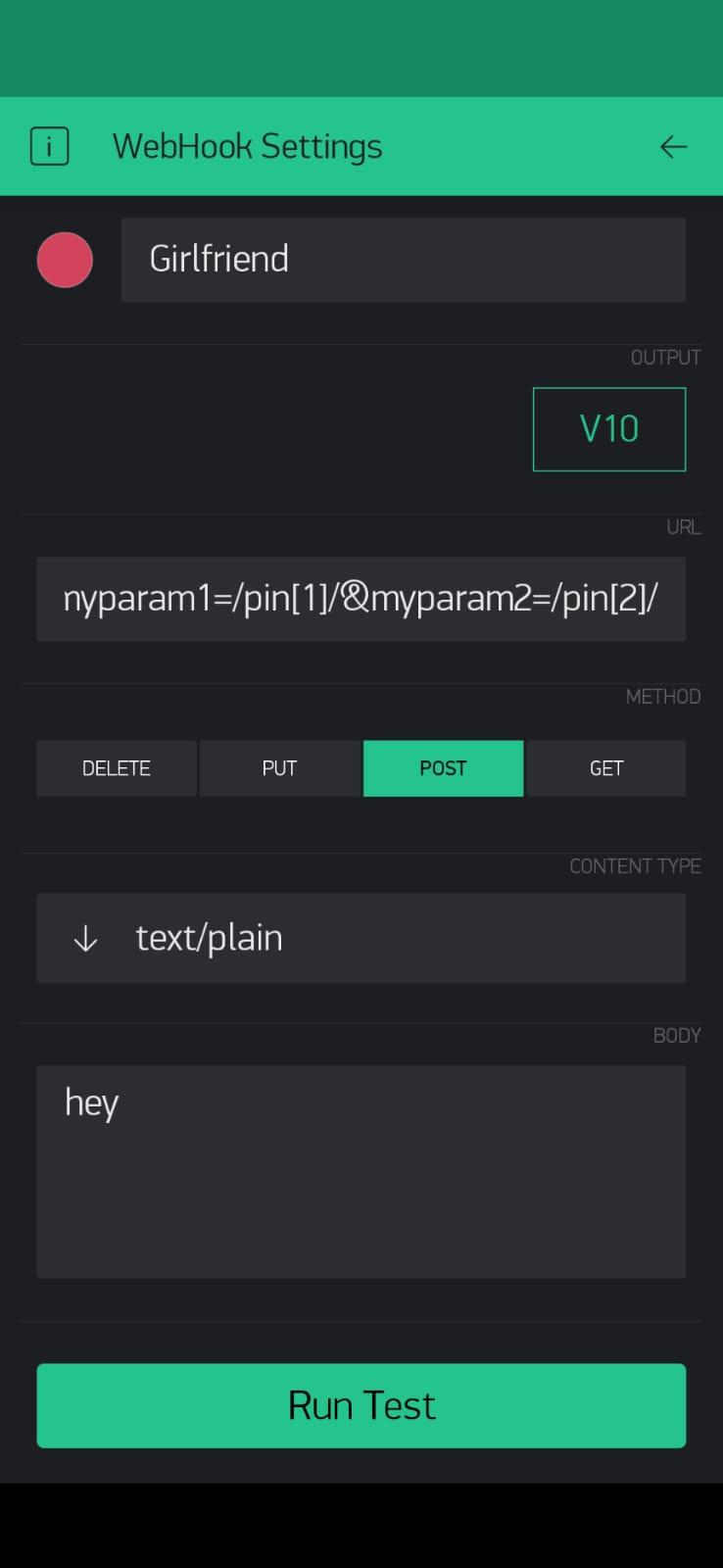

Step 6: By Flipping the Cpx 180 Deg, a Good Morning Message Is Automatically Sent to Your Girlfriend From a List That You've Already Created: (Blynk + Cpx + Integromat)
Blynk:
I added one widget: WebHook - named Girlfriend.
WebHook set to pin V10, and The Method is "POST" with a content type of text/plain and Random Body for example: "Hey".
Code:
I created 3 Strings (string1, string2, string3), each string contains a different message to your love.
The Strings values will send throw "Blynk.virtualWrite" to pin V10 just if Cpx will rotate 180 deg,
and if so, the WebHook widget will turn on and HTTP request will turn on Integromat.

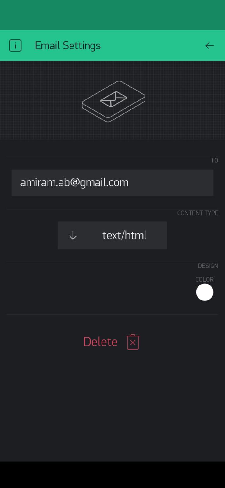

Step 7: Every Morning Take Cpx Out of the Window and Find Out the Temperature Outside, Cpx Will Tell You What to Wear Based on That: (Blynk + Cpx + Integromat)
Blynk:

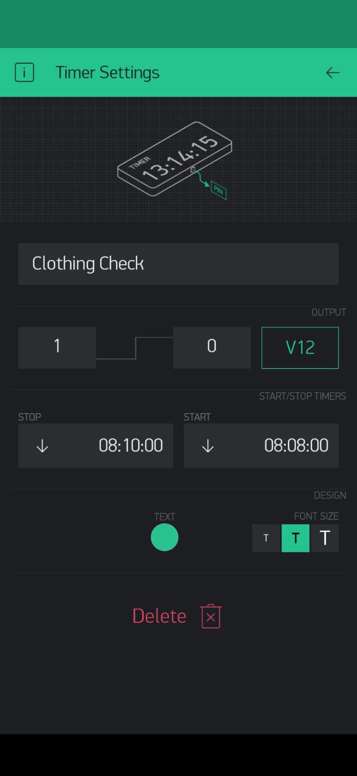

I added 2 widgets: Timer named "Clothing Check" and an Email widget (sets with my own Email address).
Timer set to pin V12, Start time: 08:08 AM, Stop: 08:10 AM.
Code:
I wrote the function "BLYNK_WRITE(V12)" that will trigger at Timer Start time.
This function checks the temperature in Celcius and then checks 3 cases and acts different dependence the case. if the temperature equal to or higher than 28 deg so the case "Hot" starts.
if the temperature between 23 degrees to 28 degrees so case "Middle" starts. Any other result will handle by case "Cold".

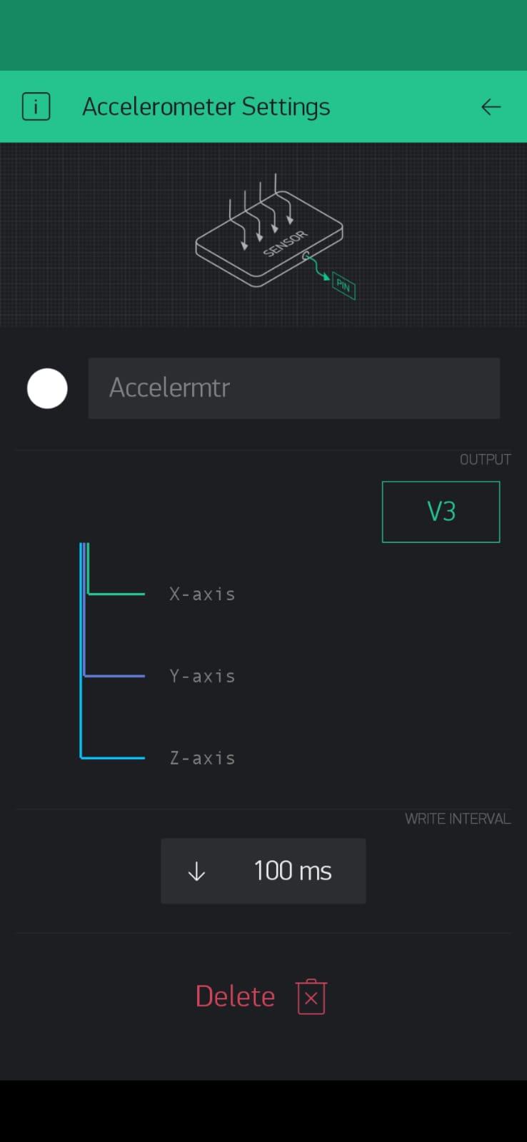

I added the Accelerometer widget from the Smartphone Sensors section and set it to pin V3. I also added Meditation Webhook.
The accelerometer widget lets the user control the three axes of the Smartphone accelerometer. For this project, just the Z-axis was used to determine when the phone was flipped or not.

I wrote the function "BLYNK_WRITE(V3)" that will be triggered when the user rotates the smartphone 180 degrees.
In that case "Blynk.virtualWrite(V5,99)" starts, this function sends value: 99 to pin V5.
Additionally, the Cpx pixels will blink in sorted order, making a rainbow wheel effect.
If the user flips back the Smartphone "Blynk.virtualWrite(V5,100)" starts, this function sends the value: 100 to pin V5.
Additionally, the Cpx pixels will turn off.
