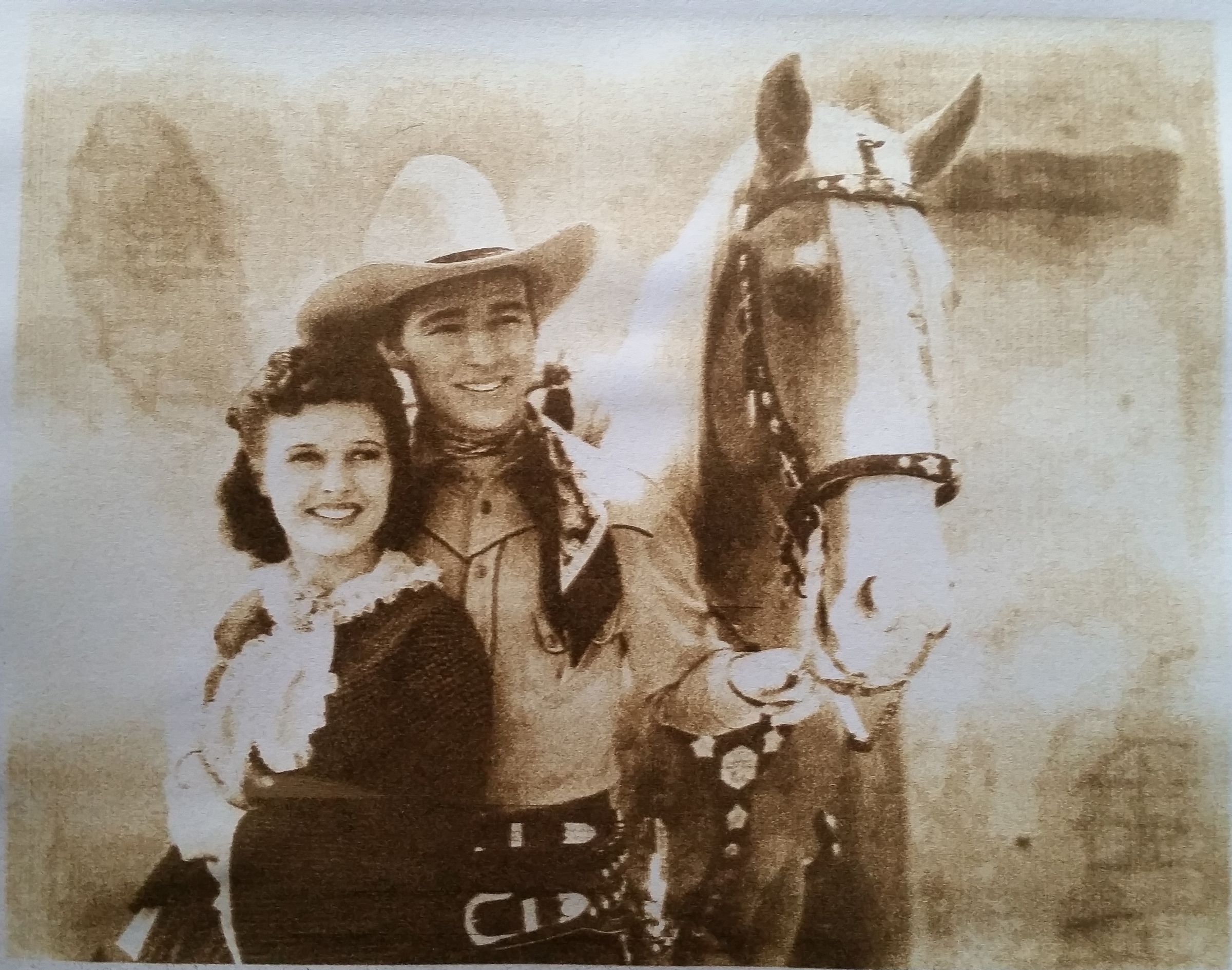

Info on the above images:
The pegasus was engraved on cheap, 3mm plywood - not a good choice LOL
My niece was engraved on plywood too but with the original Turnkey release and before the full 8 bit support was added.
And the old movie image with Billy the kid was engraved on Arakaria wood with the latest firmware mods.

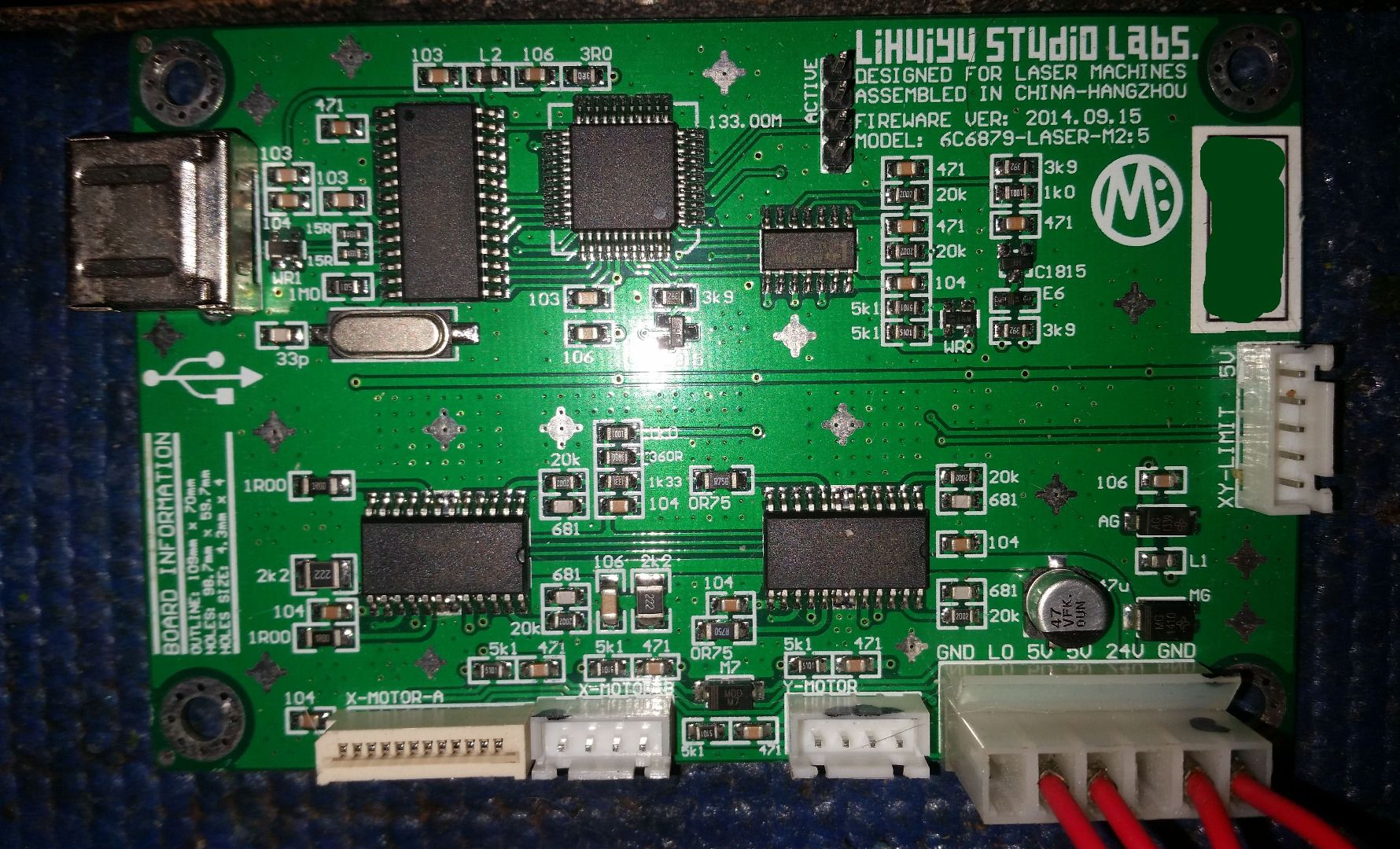

Step 3: Ripping the Old Machine Apart, Well Sort Of...
At first I decided to take a lot of pictures for this step so every little detail is covered.
Then the reality hit me by letting me know that there are several variations of the hardware out there :(
So I will try too keep it really simple....
Disconnect power and USB!!!
The original controller has to go out, same for the laser power supply.
The controller is mounted with 4 screws - take them out including the spacers and washers - if you find washers...
The power supply is mounted with 4 screws towards the inside on the machine, in some cases it might be mounted to the floor instead.
There might be a short cable channel or just cable ties used to sort the wires, get all wires loose without disconnecting them so you take out the power supply and controller with all cables attached.
Important!!: Now take a permanent marker and mark all connectors and sockets so if you have to re-connect you will be able to know where and in which direction!!
Check your pic so you are certain you see all details you need!
Disconnect all cables from the controller, it should be one plug with 4 wires going to the power supply, two 4-wire connectors for the stepper motors and one 3-wire connector for the endstops.
Put the controller, dongle and software somewhere safe.

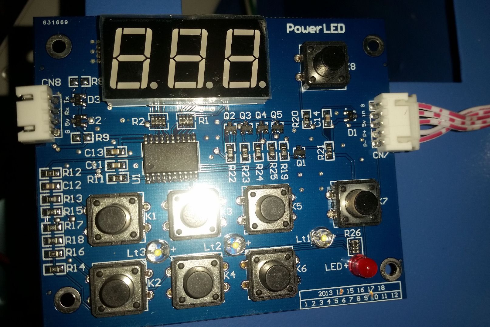

Slide out the power supply if not already done to get access to the control panel above.
If you have problems getting to the 4 nuts holding it use a small ratchet and 7mm socket instead - I tried for 30 minutes to break my fingers until I realised the ratchet was right next to me.
Once you have the panel out take another pic of the connectors there - just in case...
Disconnect the panel from the laser power supply.
Here you either have a flat ribbon cable or similar plugs like used on the stepper motors.
Check the images from my hardware for comaprison - I will refer to them later again for the wiring of the Arduino.
As you can see the vital wires are all clearly marked on the circuits boards to make it easier for us ;)

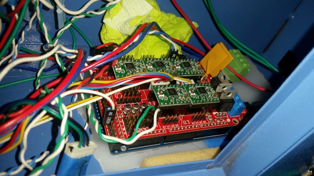

To continue please prepare your RAMPS board so it can cater for 24V.
Check the Wiki page, in the power section you will find the location of the D1 and D2 diodes - D1 needs to be removed!
The two big, yellow plates are polyfuses and we need to short them with a lenght of wire so the board can handle the 24V properly if not done you might encounter random disconnections.
If you want to keep them for safety reasons please replace them with 30V types.
Now it is time to connect everything - I won't bother too much at this stage to make proper mounts an such as I still plan do some further mods to be covered in another Ible.
Please use the images from the last step as a reference, your internals might differ a bit but the basics are still the same, even if yours has a analog meter.
On the ramps board you need to check under the drivers if the jumpers are set correctly for 1/64 microstepping!
As it is the maximum these cheap drivers support you can put all 3 jumpers in there.
Dending on you skills and material at hand you will either use connectors or solder the wires without the right connectors directly - either I will only refer as "connecting" in this matter.

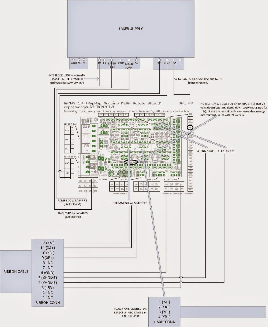

Check this nice diagram Dan Beaven made as a reference:

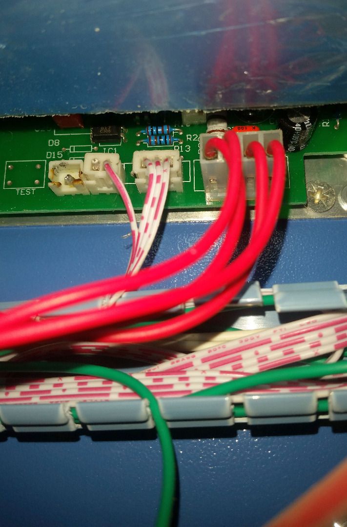

In my case there was no ribbon cable at all, just two identical connectors for the steppers, which caused me a bit of a headache at first.
To spare the headache use the above image a s a reference and do this:
The big cables between controller and PSU are the power supply, start with them and disregard the wire on the "LO" connction - you only need 5V, 24V and GND.
Only if your Laser power supply does not offer a PWM control you still need the power adjustment and the analog meter - plus make some minor changes in the firmware (documented).
Next connect the Laser fire and PWM signal wires - if your PSU is different check the circuit boards for the corresponding connections and use them.
Now do the stepper motors and if you have a ribbon cable for motor and endstops follow the above diagram, otherwise plug the motor in and prepare the endstop or cable to cater for pull up resistors.
If you are unsure about this step check this Wiki for the wiring details of the resistors.
Connect the endstops to ramps board, 5V and GND - it does not matter which 5V terminal or ground terminal is used here.

We now can cut in a proper way and also do raster engravings - but what about true 8bit engravings of greyscale images?
The above was done with a slightly modded firmware and the Gcode generated with Image2Gcode - the guys at vicious1.com did a great job with the tool.
But to get the best results from a CO2 cutter I had to make some slight changes.
If you are interested in quality engravings on your chinaware then check this Ible out - everything you need is there ;)
For the above image I had to do quite a few testruns as the target was a sheet of copy paper!
Size of the engraving is 65mm wide and 56mm high.
Engraving time: 26minutes.

Here is a video showing the machine engraving a photo.
Sorry for the bad quality but it is a pain to get proper focus through the orange lid - have to replace it with a clear one.
Here is an imaged engraved at 7200mm/min, size is 240x180mm, material: paper.
Time to engrave: 62minutes
