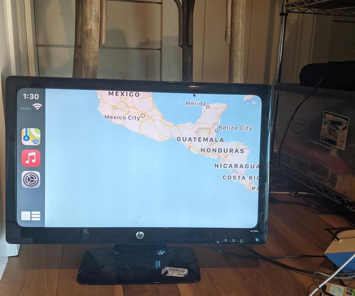

This is a great project if this is your first time with a Raspberry Pi. I'm only 9 and it's my first tech project and it was a fun and simple way to start! My Goodwill GUI shows the weather, time and date, to-do calendar and swaps photos in any format you like. Everything but the Raspberry Pi was bought at our local Goodwill store.

Hook up your Raspberry Pi and open DAKboard.com on your browser. Then create a free account or you can do the four dollar package where you can make a custom GUI board. After you sign in, you will get a screen like below. Then hit My Predefined screen or My Custom Screen if you paid.
Then this will come up and you can customize every thing on the board or if you paid you can do the GUI version on your display then hit view screen.
Then your screen will come up.

Step 6: And Here Is the Finished Product!
My mom loves it because we have a farm and she needs to stay on top of the weather all the time. I hung it in our den so when she has her coffee in the morning she can watch the pretty photos and see what weather is coming. My next step is to load her farm photos so that we can watch images of our own farm play all throughout the day! My total spend on this project outside the Raspberry Pi was only $30. It was my first ever tech project and I had so much fun!
