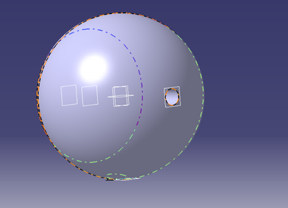

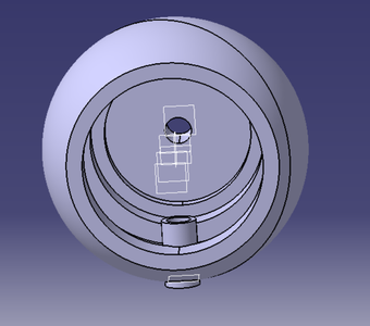

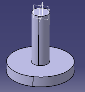

Step 1: CAO on Catia
We designed the 3D models of the eyeballs using Catia V5, as well as the parts used to attach the servomotors to the eyes.
