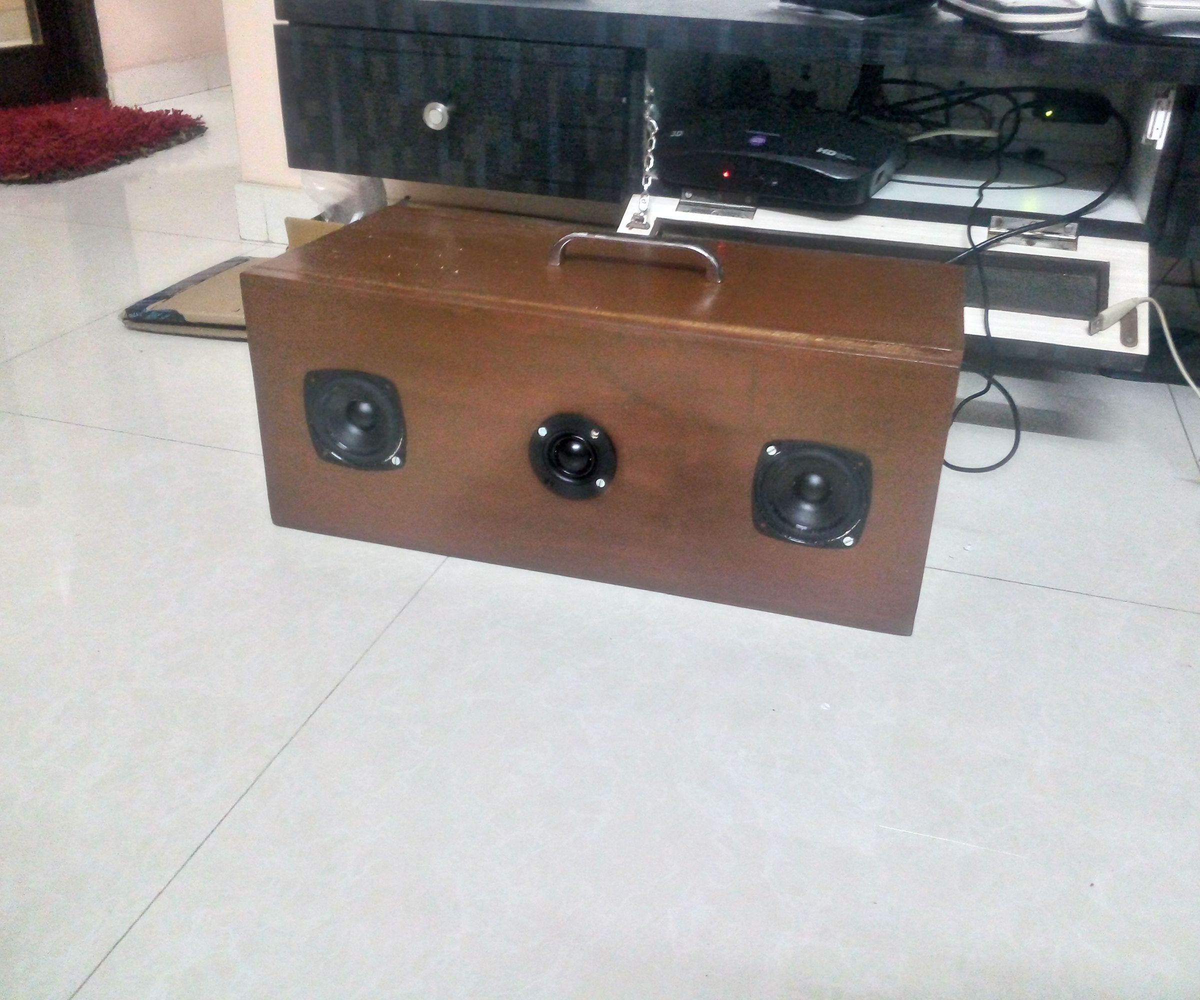

Step 4: 3d Printed Case
The attached image i got it printed , i have placed the pi , and a speaker inside this. it works great :)
