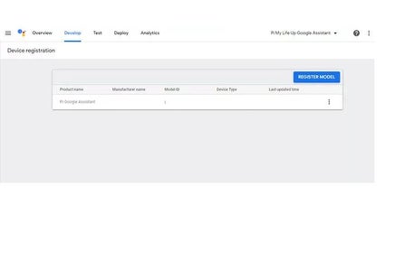

Now back in the other tab where you created the project, scroll down to the bottom of the screen.
You should see some text saying, “Are you looking for device registration? Click here“.
All you need to do to proceed is to click the “click here” text.
You will now be taken to the following screen, click the “Register Model” button to continue.
