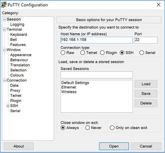

To begin work on your Pi, you have a few options, the first is to just plug the Pi into a monitor and add programs through the terminal, but this can be a little tedious. What I do and would suggest for anyone is to access the Pi through SSH, which basically means that you are using a computer to access the Pi from your home network. Something to consider is that SSH only provides the terminal, there is no GUI, but this should not be a problem.
As a side note, there is a virus going around the internet known as Mirai, and it infects IOT devices, such as the Raspberry Pi when they are open to the internet and still use the default password. Because of this the Raspberry Pi foundation disabled SSH access by default in the latest OS release. I still have an old copy, so I have used that one to start with SSH enabled, and from there immediately change passwords and update the OS from the terminal. They claim that there is a way to enable SSH by placing a file titled ssh in the boot directory, and that will tell the kernel to turn it on, but I have not figured it out. This means that you may have to connect it to a screen, at least to enable SSH access in raspi-config. For those of you who want to use a SSH client, I use PuTTY, which you can download by clicking the link below
https://the.earth.li/~sgtatham/putty/latest/x86/p...
You access the Pi through this program by inserting the Pi's IP address , which can usually be found in your router configuration page, or by running the command ifconfig in the terminal, and then clicking Open. It will warn you of some stuff, but it is your Pi, so you can click yes. Make sure to change the default password immediately if you are using this method.
