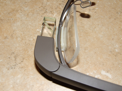

This project contains a source file that you can print on a 3D printer. The part you make can be used to mount a lens on Google Glass. The Instrucable also helps you choose the correct lens.
Mounting a lens fixed some problems for me with Google Glass. My right eye (the one that sees the Google Glass display) is very nearsighted. As a result, the Google Glass display was too blurry for me to read, as the optics mimic seeing a larger display at a distance of about 8-10 feet. It should also solve the problem for people whose right eye is too farsighted. I do not normally wear glasses because my left eye is not nearsighted.

The attached GlassHolder.stl file contains the 3D model for you to print. If you use Makerware and a Makerbot 3D printer, I've also included the GlassHolder.thing file, but you don't need it. This part is small and printed easily on a Makerbot 2X printer. I used a 0.10 mm layer height, the highest resolution on the printer, which is probably a good approach since the features are small. I printed it using a raft.
Step 4: Try the Fit
The part has a curvature that will be different from that of the lens and different from that of the Google Glass frame. This slightly different curvature allows the part to grip tightly. But the curvature should be in the same general direction. If the curve is opposite, turn the part around.
The outer slot is for the Glass frame, and the inner slot is for the lens. Try putting the lens into the part (the top of the lens against the part), and then remove it. Then try fitting the part onto the top of the Glass frame.
Step 5: Put It All Together!
Remove the part from the Glass frame. Attach the lens, then attach it to the Glass frame.
