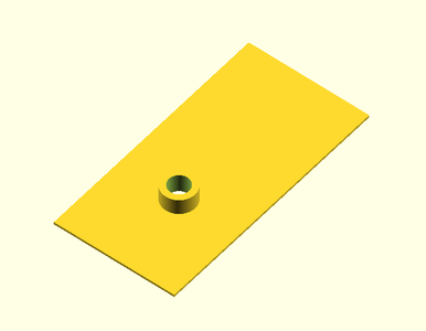

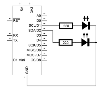

When the face has been printed you can add the D1 Mini, LED's and resistors. Connect the resistors in series with the LED's. Connect an LED to pins D1 and D2 (see schematic diagram). If you want you can use the OpenScad file or the Eye.stl file to create a holder for the LED.
