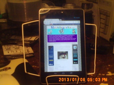

Step 1: First Thing, You Have to Have Is a Stand....
Anytime you have access to a touchpad, palmpad, or the like you have to have your own personal stand to show off your new computing tool. There are many many home made stands that you can choose from Instructables.com has quite a few itself. Whichever one you pick will definitely allow your enoyment of the unit to multiply.

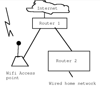

Step 2: You Have Logged Into Your Unit and Changed Your Password, Now What?
Your Nexus 7 is pretty much useless unless at this point. Something you do not want to hear, but the good news is that you can connect it to at least your own home network if you have a router that supports wifi. In fact you will probably want a router that paritions out any wifi devices for the security of the network. Many of your nicer routers do have the ability to set this up easily. Consult your router's manual for details.  If you do not have a router with those capabilities, you can use a two router set up to accomplish the same thing.
The next thing you want to consider is what speed will you connect to the network. If you have only one or two wifi devices, then there is no need to go out and spend a lot of money to upgrade your network to N. G (what most routers support)  will work just fine, A whole new technology is coming out for wireless that will make existing  equipment per se obsolete.
Security in connecting to the wireless network is also important. http://homekb.cisco.com/Cisco2/ukp.aspx?pid=80&vw=1&articleid=19073 has a primer on how to get started with wireless security. Again It will vary from router to router on how to best set everything up. Check the manuals for sure.

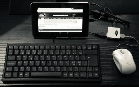

Step 7: Where Do You Attach Anything?
One of the sensitive issues with me about the Android platform is that you have to have the power of the computer gods so to speak to have full access to your Nexus 7. To get full acess to the Nexus 7, you have to do what is known as "root" the device. Root is the equivalent of Administrator on MSWindows based systems. As root or administrator you are the super user of the equipment. In actuallity, You try to avoid being superuser for security reasons. I am not going to get into rooting the device, because how to do it depends on what time it is. (newer versions of the Android os come out all the time and getting root is not standard).
Why did I say that? Most machines allow you to use external storage devices such as thumb drives and portable hard drives very easily. Not so on android devices unless you have root rights. I understand why, but it still kinds of disappoints me. You have to do everything over the network an at times file exchange. of data is Inconvenient.
That leads to the question, in fact how do you connect anything to the Nexus 7? Suprisingly there is a special usb cable called an OTG (on-the go) cable that will allow you to attach hardware such as keyboards, mice, thumbdrives (with root access), printers, cameras and etc. Most local retailers at least where I live do not carry the cable. I ask retorically Why?   You can get the cable on-line fr the major internet retailers for a nominal price. You actually can make your own otg cable without cutting open a cable as some you tube videos suggest. It can be done without all the cable surgery, (update: Fry's now carries the cable).
Almost forgot, Using a wireless based device at some locations is prohibited. You can use the OTG cable to attach a usb to ethernet adapter to connect to their local network. Except for the power drain, I like the security of not have to use wireless.

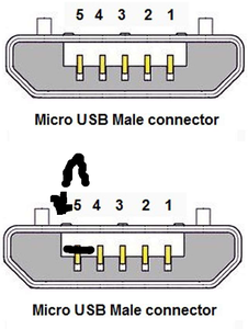

Step 8: Otg Hack.
Notice: do this at your own risk.  Get a professional to help if you are the least bit unsure how to do it.  We are not responcible for and and all issues.  Do not do this on the cable that works with the charger!!!!!!!   Use a separate cable.

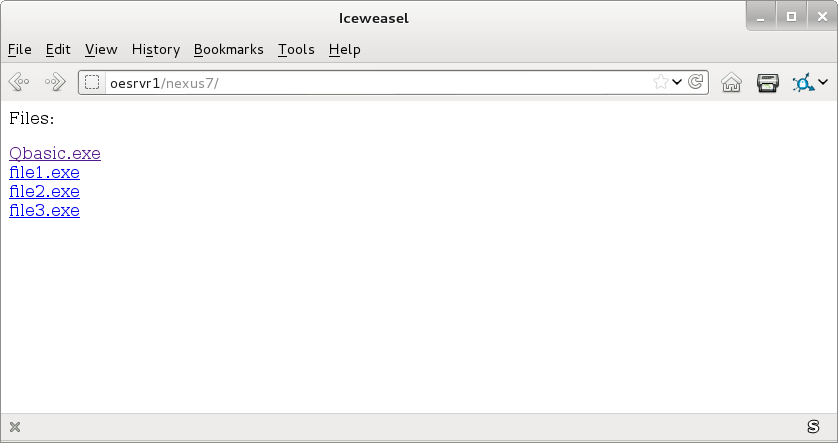

Did not have to, but I made a simple table of contents or index.html  That way it was clear what I really wanted to download. A good idea especially if you have a lot of files in the directory.

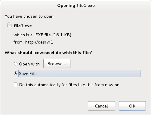

Now to download the files. So I pointed the web browser to oesrvr1/nexus7 if I was using the apache web server.
Just lick on the link... (if using a regular browser, it might look like this:

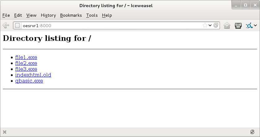

If you are using the quickie python web server without the index.html, it might look something like this. (You would connect to a port (8000) instead of the directory.)
Obviuously this is not a secure method of transferring files. But on your own private network, that should not be an issue if you are careful. The files were easily transfered to the Nexus 7 and I am happily using them now. Did not have to purchase a special app or worry about how to connect to the Nexus 7 with hardware. Which leaves me to say, If you have one or more computers, having a web server just just as important as having a flashlight for emergencies.

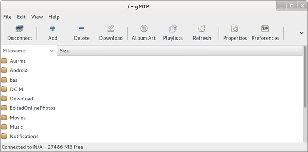

Update:
Under linux gmtp will connect directly to the Nexus 7

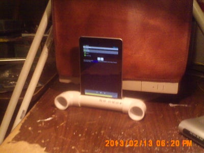

Step 12: Touchpad Megaphone.
Want to increase the sound volume of your touch pad or the like? This is for units that have the speaker on the bottom of the unit.  Try this neat trick. Take a length of about seven inches of one inch diameter pvc pipe. Your size may vary,   Most hardware stores carry pvc pipe, but you might have to get a long piece just to make a short piece. I had about a two foot long piece already,  Cut a groove in the pipe just wide enough to insert your pad. You probably do not want it too tight. You will also need two elbows. I just used right hand elbows as they were a lot cheaper than the slight angled ones. Press the two elbows on each end. Get your music going on your touch pad and insert it. You should more than twice the volume without using any kind of electronics!!
Then there is the updated version..

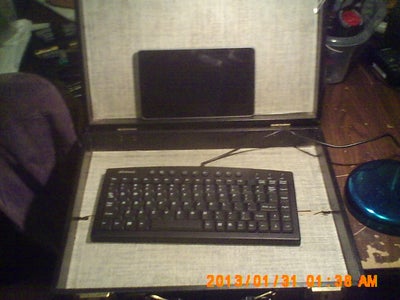

Step 13: The End? Maybe Maybe Not?
Hopefully I have given you enough to make you curious about the Nexus 7 as well as any Android device. A Nexus 7 laptop in the works?  Stay tuned....

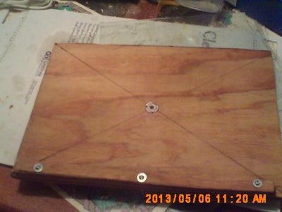

Step 14: Stand Accessory.
Experimental palmtop stand in progress. I could get real fancy with this if I wanted to. Did a light stain of the base using tea and the the liquid from soaking steel wool in vinegar.

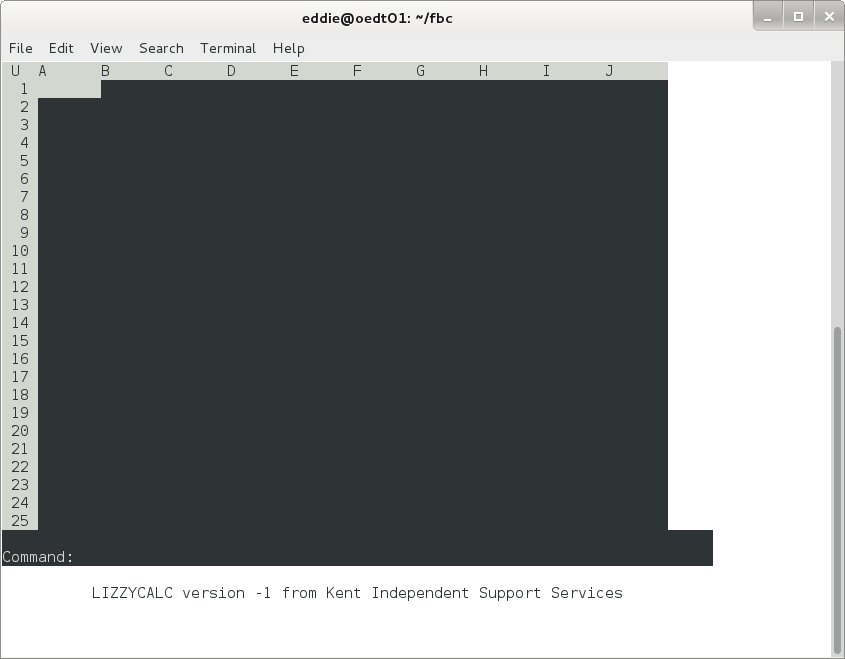

Step 15: Develop Your Own Software Without the Android Development System.
Bad picture, but I ported my little spreadsheet to the Nexus 7 without using the Android development package. Actually I loaded a dos emulator and installed Qbasic. Now I can use all the programs I have written such as a spreadsheet, database, editor, and etc.
