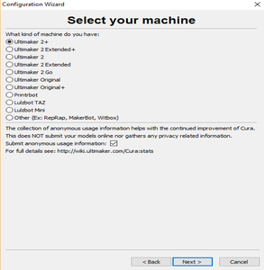

In the workshop we use Ultimaker 2 3d printers, if you have access to a different printer, the steps are almost identical except for the machine setup stage. You must enter the specifications of your machine for this step.

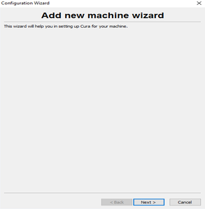

When setting up Cura, you’ll need to add a new machine with the built in wizard. The machines we use are Ultimaker 2’s

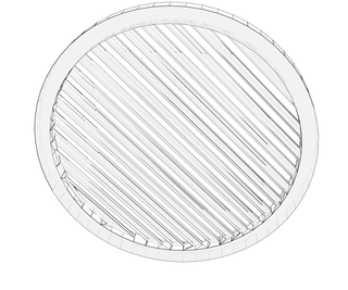

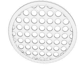

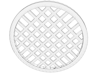

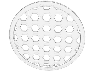

Download the Sketchup files available on this Instructable. You'll only need the '.skp' files for this tutorial, but I have included the'.stl' files too as this is a more standardized format for working with across many CAD programs in case you want to work using one of these packages instead. Open these files using Sketchup. Note, while it isn’t overly important, whenever you open Sketchup you will be presented the option of selecting a template. It is easiest to select one that will work in millimetres, and particularly the 3d printing one located at the bottom of the list of templates. Doing this simply sets the standard units that Sketchup will work with. The coins downloaded from the website are all similar designs, so it is recommended that you take a look at all of them then decide on just one design that you want to print.

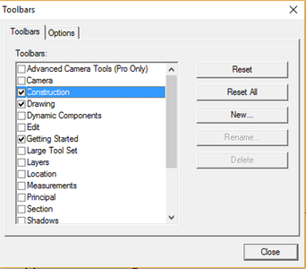

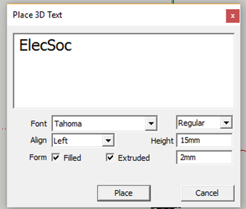

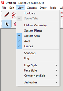

For this intro to CAD we will attempt to write some 3d text that will be placed on the surface of the coin. To do this we will use a feature called 3d text. It may be already available towards the top of your screen but if not you probably need to enable the specific toolbar. To do this click on View -> Toolbars… and enable the ‘Construction’ toolbar. This will add a set of 5 features at the top of the screen. Now select the 3d text feature. You will then be presented with a dialogue box asking you to enter text. This is the text that we will place on the coin. It is recommended that you keep the text as short as possible, your initials would be a good example. This is because the printer will struggle to print the small details if you have a large amount of characters in your text. The text box also has a value labelled as height, this is a measure of how tall the text is, in terms of xy axis. A value of 10mm is a good starting point but this can be scaled later if it is not correct. To make it 3d you need to make sure the extrude option is checked. This will allow you to edit a value field below that of the height field. This is how far the text will be extruded in the z axis. To be flush with the coin it is best to keep this around the 1.5mm mark. Once you are happy with the settings you can hit place which generates the text in the workspace.
