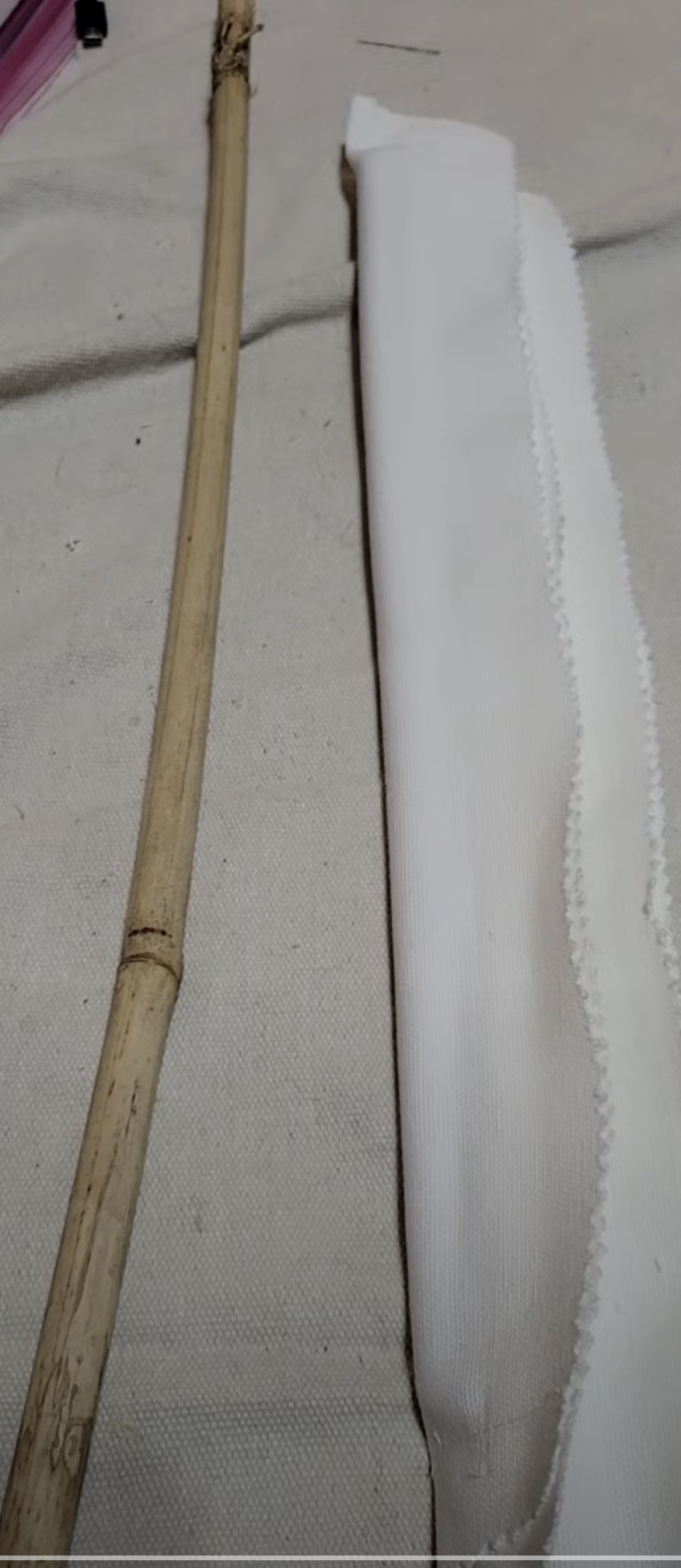

- Wing structure: encased bamboo sticks (2.5 feet) in a fabric casing and sewed inside the wing so that I could direct the wing in any fashion I wanted. Also gave a great edge to the wing so that it didn't flop.
- Made sure there were slits in the wing so that my hands can slip out when ever I need my hands.

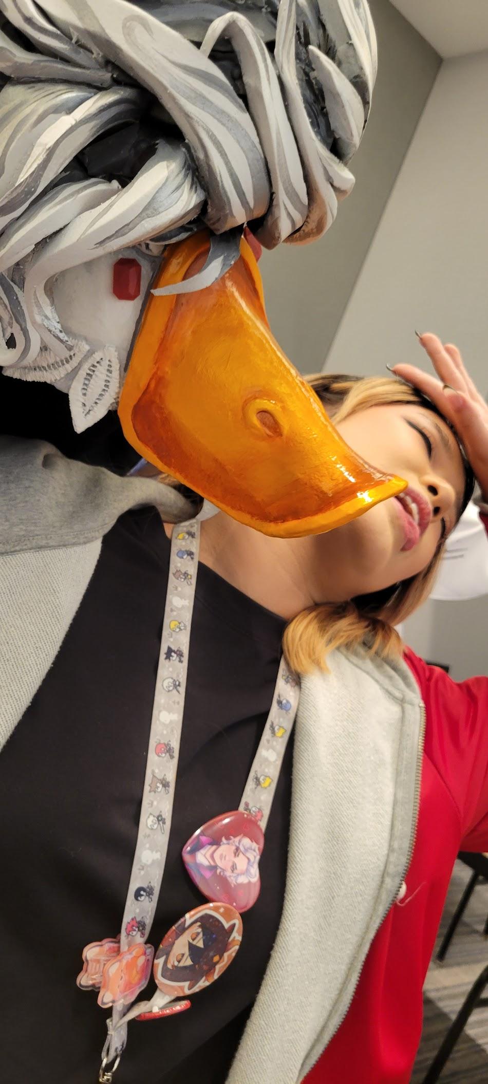

- Detached bill from ball cap.
- Used paper, thin board, plastic and duct tape to draft head and bill pattern
- Made EVA foam pieces from pattern
- Pieced together EVA foam pieces for the base bill and head.
- Laid Worbla on top of EVA foam bill and head separately as final layer.
- Made teeth out of Worbla bits
- Attached together the teeth to bill and bill to head. Worbla is naturally sticky to each other. However, I would double up on a strong adhesive in the future for parts that are touched a lot.
- Used foam clay to add facial details to mask
- Covered lace feather pieces with wood glue to add to the mask. The idea was to tie in the head to the goose suit.
- Glued feathers with e6000 to mask/head
- Primed, painted and finished out with a gloss finish
- Poured resin gems and glued on as the eyes.
- Built out the inside of of mask with foam piece before attaching to ball cap
- Wanted underside of mask to absolutely push into the background. All fous is to be on the mask. Used Black 3.0 from Culture Hustle (www.culturehustleusa.com). It is a black that is super matte and it does not reflect any light. No matter how strong the flash or light source is, it will never reflect

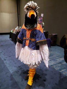

Step 12: Finished Piece <3
I love this thing so much. Best build to date. IG: @kieshareme
