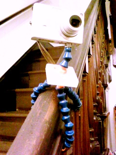

Screw the four connectors into the base and attach the three legs to the connectors. Because of the modularity, it is possible to have legs of any length (even unequal length if that makes sense). I settled on eight segments for the leg and four for the longer neck. The eight seem long enough to give the tripod some height and allow the legs to wrap around things and the four is just long enough to get a 90 degree bend (see pictures in next step).
Loc-Line is hard to attach by hand. The assembly pliers make it much easier. Use the pliers to attach the legs and make sure the mounting pieces as screwed in.
All done! See photographs of the finished tripod in the next step.

The tripod and Loc-Line is strong enough to hold an SLR, but I would NOT trust it. To maintain balance it is necessary to open the legs of the tripod, but this then puts weight on almost horizontal Loc-Line. The tubing cannot support weight this way and will buckle. With the legs in position to support the weight, the camera/tripod is top heavy and will tip over.
Smaller cameras, however, can be held at all different angles and make taking pictures straight down or vertically aligned easy.
