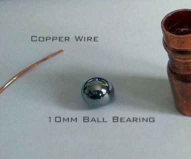

Self priming "ibble" added (hence italics above), please search for "jiggle syphon" or click above, this is a self priming syphon constructed from 10mm microbore copper.
