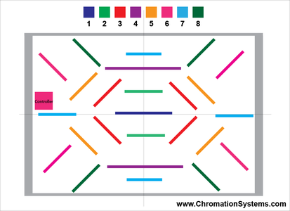

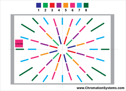

Step 2: Design & Layout
Design:
The design of one of these panels can vary greatly, my panels needed to be 44" x 30" total in 2 different designs on 3 panels. The designs were created in Adobe Illustrator. The RGB LED light strip can be cut into sections with 3 RGB LEDs every 3.5" or so. So in Illustrator I created 0.5" x 3.5" increments(3.5", 7", 10.5", ect.), rectangles. I then positioned the rectangles into my desired pattern, only half of the layout was done by hand and then copied, pasted and flipped to make the other half symmetrical to the first. The design could be anything but remember the strip can not make rounded shapes and wiring can be tedious so avoid using too many individual strips.

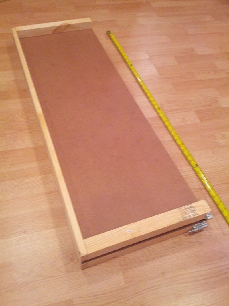

Step 3: Build the Frame
Frame:
The frame is made out of two sizes of pine boards, standard 2x2s (1.5" x 1.5" actual) and 0.75" x 1.5" pine strapping(it is a 2x2 split in half)
The included diagram tells it all, each half is made up of two 1.5" x 1.5"x 14.25" boards and a 0.75" x 1.5" x 44" board the long way.
With two pieces of 44" x 15" piece of 1/4" hardboard for the backing, it is most important to make it flush to the inside edge where the seem will be, don't worry about the outside edges as much.
Two halves are combined(each half is a mirror of the other, not the same) and connected on each side, from the back, with 3" strap hinges, for a total size of 44" x 30" x 1.75" that will fold into 44" x 15" x ~4"

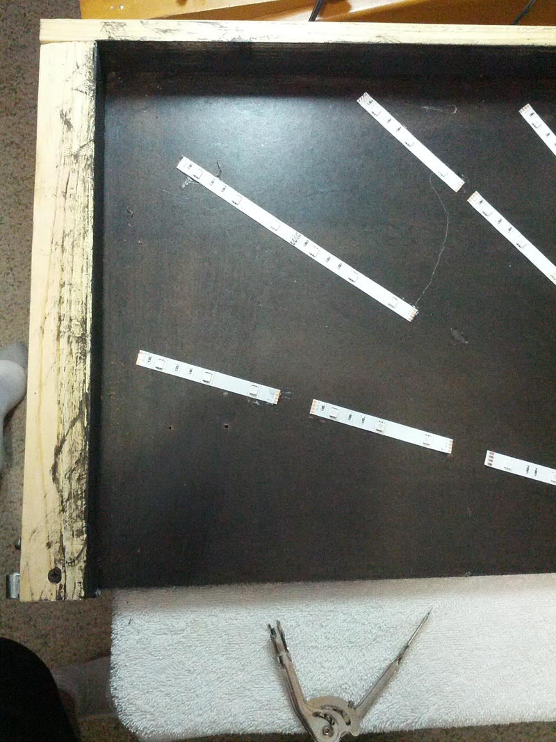

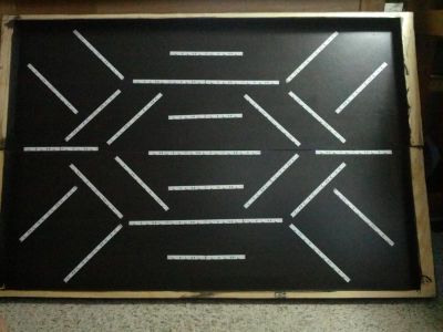

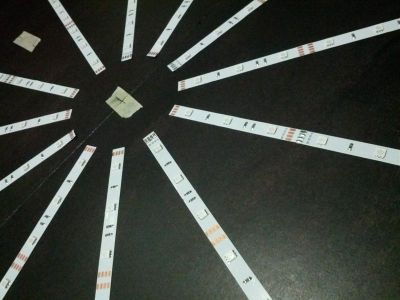

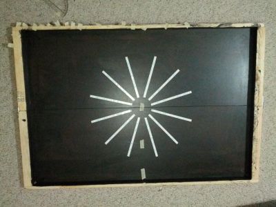

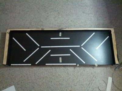

Step 4: Place the LED Strip
Layout the LED Strip:
This can either be easy if you are doing a simple design or get pretty complicated if you have a complex design. There are many ways to go about this and some might be better than others. But I started by marking the center with masking tape, then used the marks on the LED Strip, such as a LED or strip cut separation point, to layout the simple horizontal and vertical strips. Once the easy ones were placed I used a square, tape measure, ruler, 45 degree ruler, and even a protractor to position and attach the LED strips in their place. There was a fair amount of estimating and guessing, but it all turned out close enough.

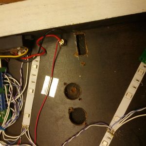

Attach The Electronics:
Once the 24 Channel High Current LED Controller is finished and any additional circuits are built, such as a DMX interface, DC/DC Converter, ect, screw the controller and any other circuits down to the panel. I used some VHB tape to secure the DC/DC converter to the side.
My panels used, a 24 Channel High Current LED controller, a 12v to 5v DC/DC converter, a DMX-512 to Serial Adapter, XLR In and Out, and a panel mount DC Jack. The circuit boards were attached first and the positions for the interconnects(XLRs, PWR) were marked and were installed last, so they wouldn't get in the way during wiring.
Shown in one of the images, but after the rest was constructed, I flipped the DMX-512 to Serial Adapter upside down, mounted on standoffs, with a cutout to reach the DIP switches from the backside.

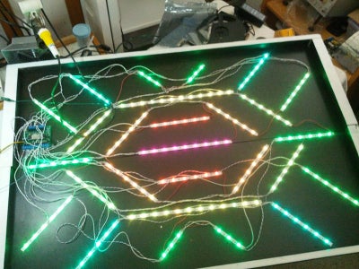

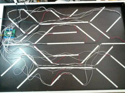

Step 5: Wiring
3-strand twisted, Red-Blue-Green, tinned, 22 AWG wire is available for purchase, which is perfect for this type of project. Find it Here
LED Strip Anode Wiring: Note: it is easiest to work on one half at a time and connect them together last.
All the LED strips anodes(+12v) are all connected together in parallel (The Red wires in the first image) Doing so will simplify wiring and overall there will be a lot less wires. The color chosen for the anodes should be different from the colors used by the RGB Channels, I didn't have the Red-Green-Blue twisted 3-strand wire available when I built these panels, otherwise I would have chosen White for the Anode wires, but for the panels shown, the red wire are the anodes.
Simple enough, start connecting all the anodes in parallel, try to distribute the power path so all the power is not going though a single strip of LEDs, even though the strip PCB can handle up to 20 meters worth of power going through it. Keep the wires to a minimum and be sure to try and keep the wires tight between points, with very little slack.

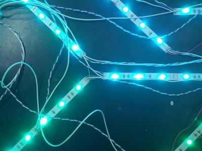

RGB Channel Wiring: This is the bulk of the project, it can get tedious but overall it is not that difficult. Only wire one half of the panel at once, so each half has its own wires that connect to the controller, that will prevent the folding of the panels from tearing the wires off solder pads. The main idea is to start on the side of the panel farthest from the controller, solder wires on and run them to the next closest LED strip that is in the same channel, ensuring the wire can be out of the way later. And work your way across essentially daisy chaining multiple sections of LED strip together as you work your way towards the controller position.
Final Wiring: The only wiring left should be wiring the last LED strip in the daisy chain to the controller. Solder some 3-strand wire to the LED strip and run it to the controller, see diagram for terminal pinouts. Leave a very small amount of slack on the wire, if the wire is coming from the other half of the panel it will need more slack so the panel can fold in half. Cut the 3-strand and strip off 1/8" of insulation and insert into the proper terminal block and/or insert the wires for the same channel from the other side of the panel and tighten the screw-down.
- Figure out roughly how your wires will travel across the panel for all 8 channels.
- Go through and tin all the pads you think you will be using, plans will probably change once you get started.
- Take the end of your 3-strand wire, strip all 3 ends 1/16" - 1/8" on insulation.
- Solder the wires on correctly(wires R-G-B to solder pads R-G-B), make sure it is a good joint.
- Without cutting the wire, run the wire to the next strip of the same channel's solder pads.
- Make sure the wire is long enough so it can be attached to the hard board later and be out to the way of the other LED strips.
- Leave a little bit of slack and cut the 3-strand wire.
- Strip off a little bit of insulation off all 3 wires and solder them onto the strip correctly.
- Work your way across the panel daisy chaining all the LED strips that belong in the same channel together. Leave the wires for the final connection to the controller til last.

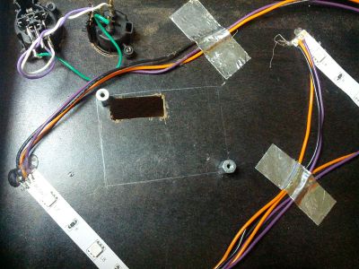

Step 6: Secure the Wires & Interconnects
Secure the Wires: The wires need to be attached to the hardboard so they won't obstruct the light coming from the LED strips. So I used two methods.
- Larger bundles of wires, a 1/16" holes were drilled on either side of the bundle and a small zip tie was looped through and secured tightly.
- Single or a few wires were secured with a small piece of aluminum duct tape, not all of the pieces held as well as I hoped once humidity and transportation got to them, so I would recommend more zip ties then tape.

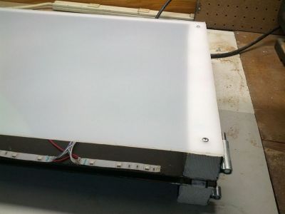

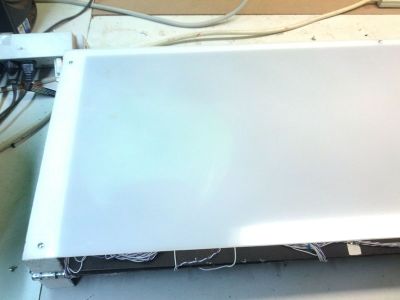

Step 8: Finished
Front Diffuser:
After the correct firmware has been programmed and everything is working correctly, the front diffuser can be attached. These were W2447(acrylic opaqueness value) cut to 44" x 15", same as half of the frame. Cut to size, pilot holes drilled and screwed on with some pan head style screws.
Optional:
All done and ready to be enjoyed.
