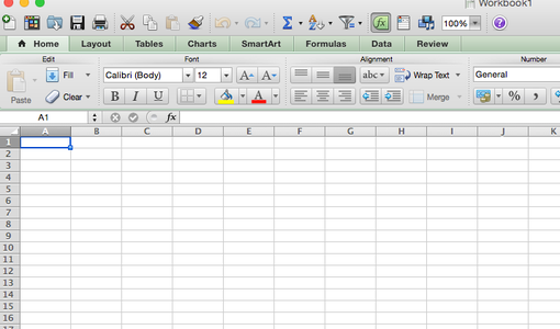

Open your Excel paste the list into a column labeled '@images
Add in a ' in front of all the file names so InDesign will be able to know where the images are saved.
Copy this column over to the CAP column and remove the file name extension. This will be the name of our card.

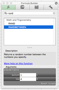

Next create the other columns you will need on your card. I have Attack, Defense, Score and Flavor (ad some other columns I thought I would like to play with)
Check out the images to see how I created the random numbers for the attack, defense and score values.

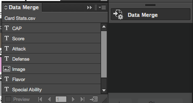

The first thing I do in InDesign is create all the boxes I need based on the columns I created in the Excel Doc.
Then open the Data Merge Window and click on the add data source to link my .csv file. once you have the source linked you will see all of the columns appear in the Data Merge area. Now you can simply click and drag the data to the windows you would like them to appear.
Once you have all the data in the document you can start designing your cards to look however you would like.
