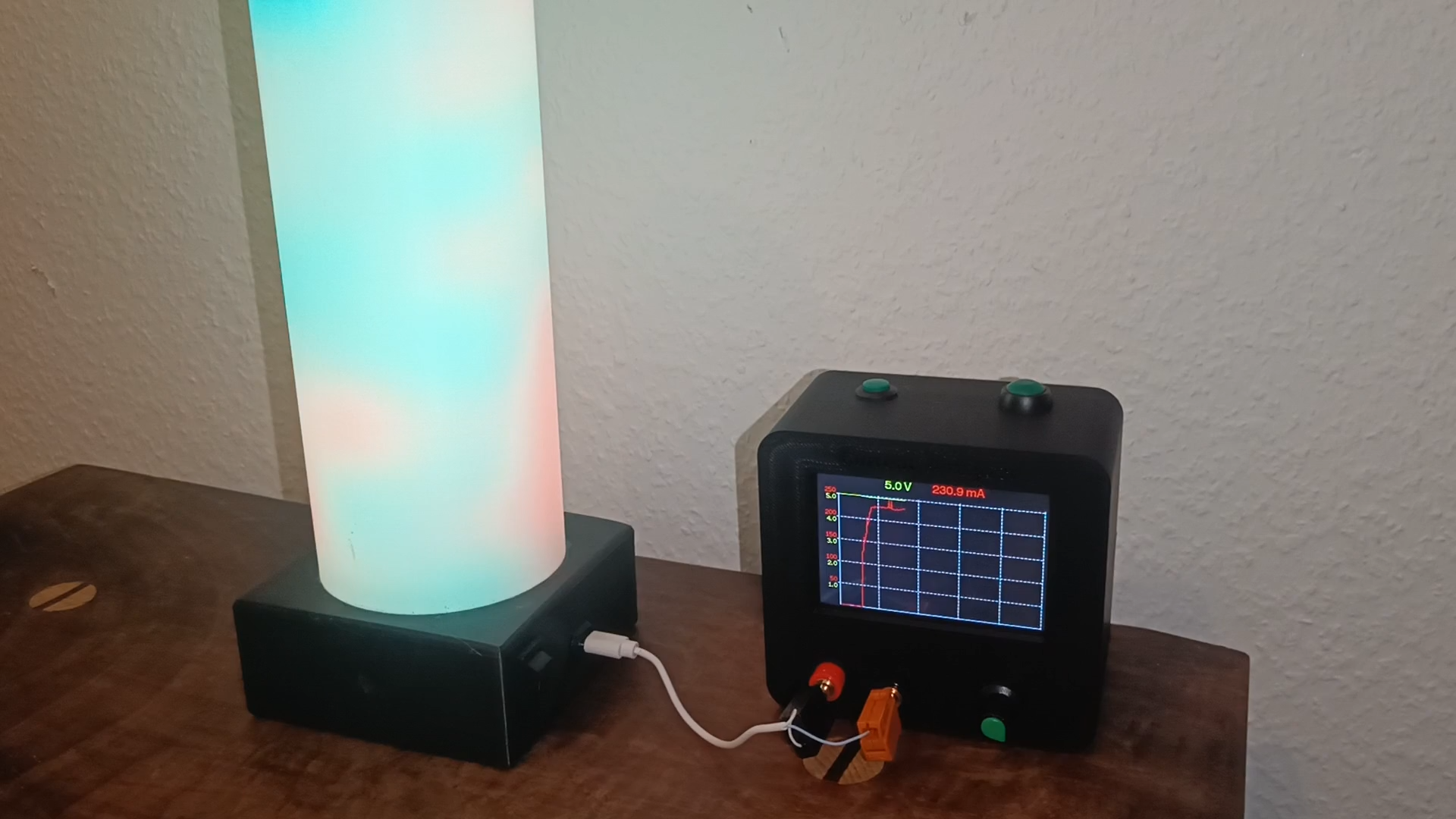

Step 1: Functionality
I tried to keep this device simple. It is powered via a USB C port at the back, as this is normally always available. If the circuit being tested requires a higher current, you should use a suitable USB power supply that can deliver this current.
The switch can be used to turn the device on and off. The ZK-4KX is used to set the desired voltage (0.5V - 30V). The consumer can be connected to the banana sockets. The current curve can be observed on the graph in the display. Pressing the button resets the device, deletes all recorded data, and the graph starts again from the beginning.
When the graph reaches the end, the data is updated as in a FIFO shift register. The scaling of the graph is regularly adjusted to the largest value in the data.
