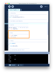

Right now our coordinate pairs are tied up into a single string. In order to use them, we need to pull them apart. This is called tokenization, and we have a handy function that will take care of that for us!
In the first picture, you can see that I've added a section called "Data", where I create an array of strings called "token", as well as some integers: i, x, and y*.
In the second picture, I use the splitTokens() function to split the "inBuffer" string into an array of strings. This array is stored in "tokens".
Then I use my integer i to step through each of my tokens in a for loop. I print each one to terminal, and you can see that down below!
*Don't worry about x and y for now. We'll use those in the next step.
