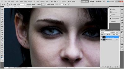

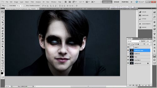

Step 1: Zombie Eyes

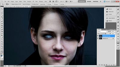

1. Open the image of a person's face in Adobe Photoshop CS5. First, we will start with the eyes.
2. Use the Healing Brush Tool and while holding down the Alt key, sample a part of the white in the eye. Blot out the iris and the pupil.
3. Next, copy the current layer (for backup) and use the Burn Tool (Range: Midtones, Exposure: 80%) to darken the edges and corner of the eye.
(Eye manipulation continued in Step 5)

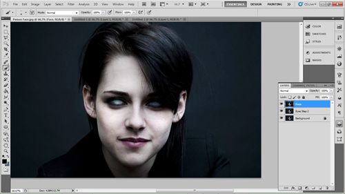

Step 2: Pale Skin
1. Replicate the current layer and name it Face.
2. Using the Dodge Tool (Range: Midtones, Exposure 50%) lighten the skin on the face to make it pale.
3. Next, on the main navigation bar click Image >> Adjustments >> Hue/Saturation and set Saturation to -40.

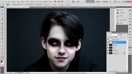

Step 3: Sleepless Shadows
1. Replicate the current layer and name it Eyebrows.
2. To darken the eye/eybrow area, we will use the Burn Tool (Range: Shadows, Exposure 40%) around the eyes.
3. Create a new layer and underneath each eye paint a stripe of crimson. Fade out the edges using the Eraser Tool (Hardness: 35%, Opacity: 75%, Flow: 100%) and set the layer Blending Option to Soft Light.
4. Merge this layer with the Eyebrows layer.

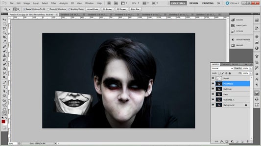

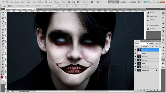

Step 4: Sinister Grin
1. Duplicate the current layer.
2. Using the Patch Tool and the Healing Brush Tool blot out the person's real mouth.

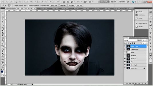

3. Drag the your creepy mouth image (see needed materials) onto the canvas. Using the Image >> Adjustments >> Color Balance tool, color the new mouth to the approximate hue of the current skin tone.
3. Use the Eraser Tool (Hardness: 35%, Opacity: 20%, Flow: 100%) to fade out the edges of the new mouth. Merge the current layer and the new mouth layer.
4. Finally, using the Burn Tool (Range: Midtones and Shadows, Exposure: 50%), darken the mouth to make it appear realistic.

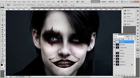

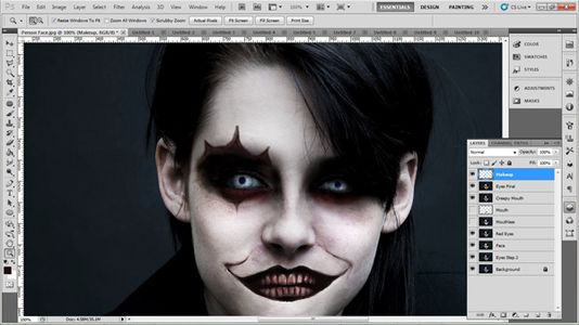

Step 6: Dark Makeup
1. Make a new layer called Makeup.
2. Using the Brush Tool with a dark color, draw small triangles around the eyes.
3. Using the Smudge Tool, smooth out the triangles so that they fade into the skin.
4. To blend the makeup into the dark eyes, use the Burn Tool around the makeup edges.

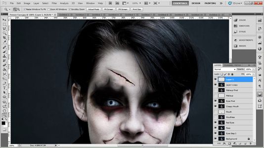

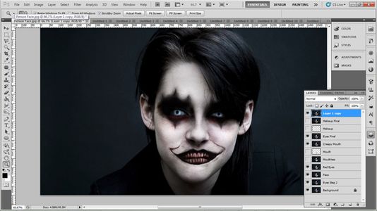

Step 7: Bloody Scar
1. Use your photo of the scar (see needed materials), paste it on the canvas, and erase the edges with the Eraser Tool.
2. Place on the person's face and set the Opacity in the Layers Palette to 90%.
3. Merge the scar and the person's face layer.
2. Darken the skin around the scar using the Burn Tool.

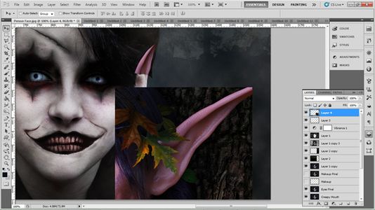

Step 8: Long Ears
1. Use your photo of the elf ear (see needed materials), scale it down to the proper size, and erase the image around the ear using the Eraser Tool.
2. Color the ear to the person's skin tone by using Image >> Adjustments >> Hue Saturation and manipulating the Lightness and Saturation to negative values.
3. Copy the layer and flip it for the other ear using Edit >> Transform >> Flip Horizontal.
4. Position the ear layers over the person's ears.
5. Using the Eraser Tool fade the ears into the person's ears.
