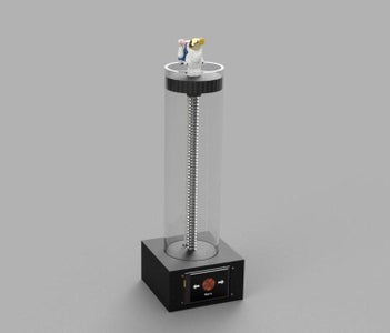

Space is vast, empty, cold, and seemingly infinite. However, everything within it, from the smallest asteroids to the largest galaxies, all obey the same invisible force, which is gravity. Among the four fundamental forces of nature, gravity stands apart as the weakest in strength. Yet controls everything at the largest scale, shaping stars, bending light (black holes), and is also the reason we are not flying out of buildings right now. But despite its "universality," I feel it is somewhat unappreciated, and that we take it for granted. So, for this project, I wanted to bring gravity in a form that we can see and control. A machine that physically simulates the pull of different celestial bodies, being the free fall an object would experience if it were in that body's gravitational field.
And it does it quite simply by using a motor-driven platform and calibrated spring system. It shows the gentle gravity of the moon and crushing pull of a neutron star (ok, haha, that was exaggerated, if I could simulate free fall of a neutron star in my room, Im pretty sure I would have won an award a long time ago [ it's a 100 billion g's]

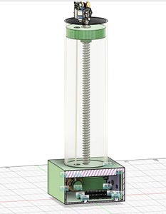

Of course, every build may or may not start with a concept design. I generally do it to help me later on when modelling on CAD to give me a general idea of where things should go and whatnot. Here, I also did a lot of the calculations to determine if each concept would work, and they would; however, I don't want to bore you with that. But to put it simply, I just determined if I would be able to generate enough acceleration to simulate the free fall on other plants/celestial bodies using the RPM of the motor.
Step 2: CAD Design

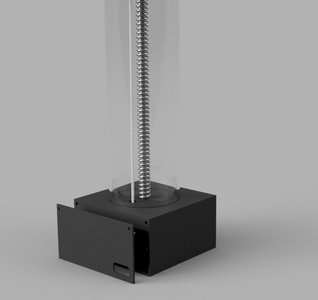

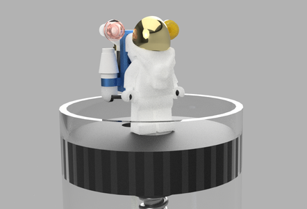

Here, I just made the different parts for this build, including the housing for the electronics and assembly of the free-fall chamber. In this project, I actually had a lot more space to work with in terms of fitting the electronics in the housing. But this was also due to my picking to use an ESP32 rather than your larger and slightly more conventional Arduino. I also added a cute LEGO astronaut I found online. This is just a decoration you can use, for example, to show an object in its free fall on different celestial bodies.
link for the LEGO astronaut :) https://grabcad.com/library/lego-6457-1-astronaut-figure-1

Sorry, but right now I can't 3d print anything due to not having access to 3d printer right now, but if you want to print the parts needed, I will attatch the files. But all the parts needed for 3d printing are just the platform, housing, and winder. As shown by the bright green parts.

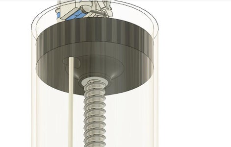

  1. Insert the 8mm metal shaft into the hole on top of the housing, along with the spring that goes around the shaft itself
  2. Insert the linear bearing into the platform, then slide it onto the shaft with the spring wrapped around it
  3. Slide the acrylic tube into the housing; there is a hole for it
  4. Fit the electronics inside the housing. There should be scres for each component, including the motor, screen, and ESP32 (a pretty good idea to do the wiring before screwing everything in place)
  5. wine the string through the platform and also wine it through the winer that would be attached to the brushless motor
