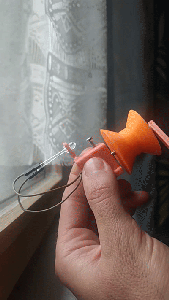

Step 1: Mounting the Component Together
- Solder the LED to the DC motor with two wires
- The orientation doesn't matter as you'll choose it when rolling the rope around the spool
- Put the DC motor inside the holder and tighten it with the M3 screw
- The DC motor have one side empty between the pieces of metal, the screw need to be in between just to avoid horizontal movement
- Don't screw until the end as you'll break the motor's gears
- Make a knot by going through the spool with your rope
- Fix the holder to a wood
- Assemble the spool on the shaft of the DC motor
Step 2: Trying Your Gravity Battery
- Knot your weight to the other side or the rope
- Check the direction of your motor by turning the spool manually, you should see the LED lighten up
- Roll up the spool in the opposite direction
- Drop the weight and watch it making light!
Your Gravity battery is ready !
