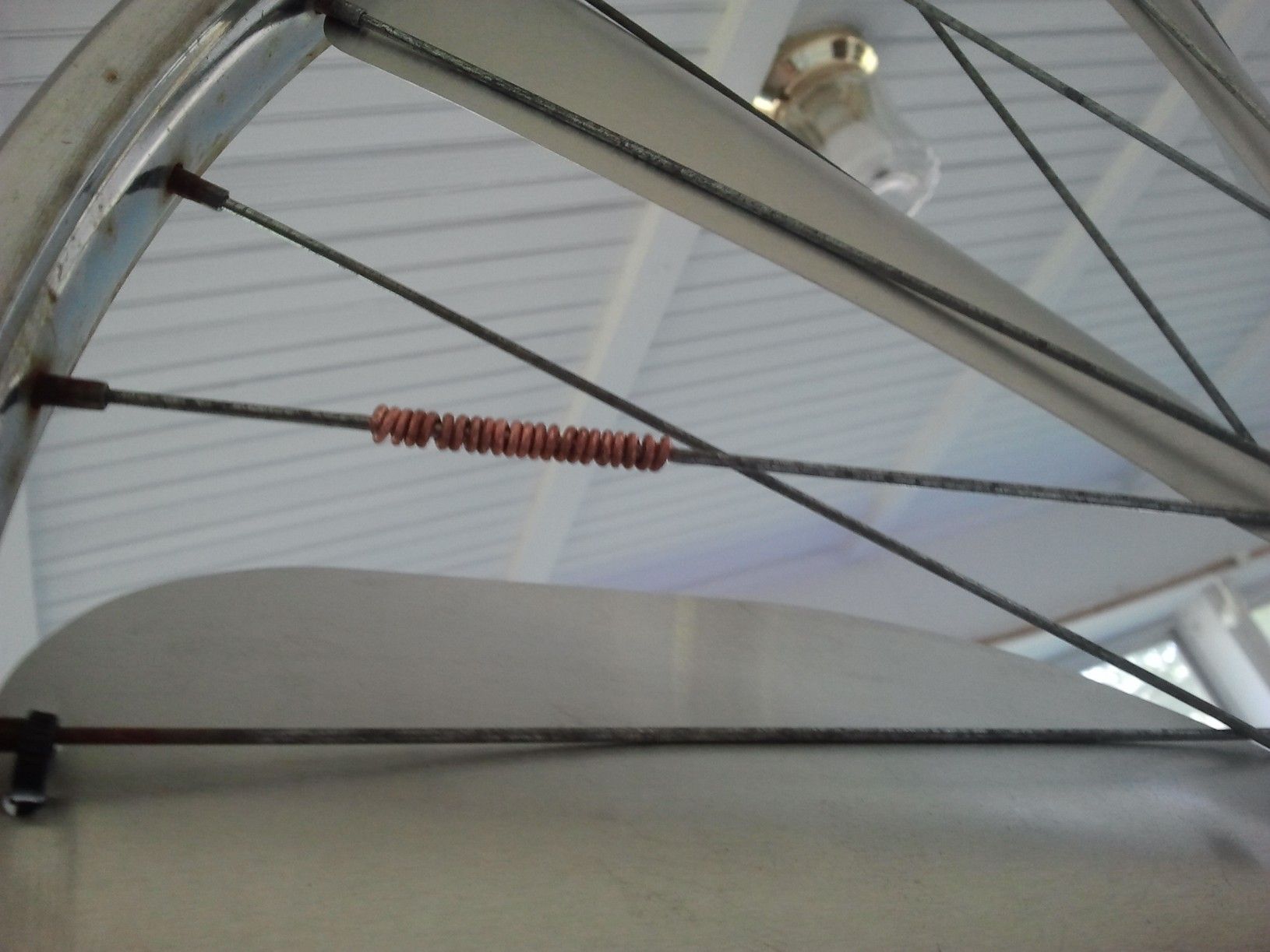

Step 28: Propeller: Mount It and Balance It
Materials:
  • 2-3 ft 12- or 14-gauge copper wire, bare or insulated.
  • blue tape.
Mount the propeller on the arm. Is it balanced? If not, some copper wire will fix it. The balance doesn't have to be perfect, but the better it is, the more readily the propeller will turn in light winds. The length of time the wind turns the propeller, not the speed it turns at, is what governs the rate of water disposal.
Do this step indoors, or on a day with no wind at all. Measure from the wheel axle to the rim, and cut a wire to that length. Coil it to make a compact bundle. With the unbalanced wheel at rest (heavy side down, in other words), use blue tape to stick the wire bundle to the top spoke or blade. Move the wire bundle in toward the axle, or out toward the rim. When the wheel's balanced, it will come to a stop in any orientation, more or less. That's the situation described in the picture. Striving for perfection is unnecessary.
If the wire coil, moved out to the rim, isn't heavy enough to balance the wheel, use it anyway. Wrap it permanently around the rim's light spot and a nearby spoke. Start by bending over one end to make a hook that will catch on a spoke. Wrap the wire around the rim. Finally, bend the wire end into the rim or around the spoke so that it's not sticking out. Now start balancing again with another length of wire.
When the wheel balances, more or less, measure from the wheel axle to the middle of the coil and cut the wire to that length. Wrap it around the rim and a nearby spoke.

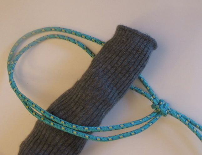

Step 29: Make the Drive Belt
Materials:
One pair sheer panty-hose.
10 ft. soft clothesline rope.
The drive belt is made of one sheer panty-hose leg and about 8 or 10 ft. of clothesline rope, tied together with fisherman's knots. Why clothesline? Nylons alone are too stretchy; a strong wind can blow a belt of nylons off the drum. Use more rope than needed: temporarily tie excess rope alongside the nylon leg.
The panty-hose will supply a leg; the remainder supplies the material for a bucket filter. Tie a tight overhand knot at the top of one leg and cut the leg off just below the knot.
Join leg and clothesline with a fisherman's knot, no tighter than necessary: Tie a loose overhand knot close to an end of the rope; slip the end of the nylon leg through, and tie an overhand knot in it that encloses the first leg. Tighten the knots a little by pushing each overhand knot closer to its leg's end. Avoid pulling on a short end.
Wet the belt and give it a stretch. Tie the remaining nylon end and a portion of the rope, to make a loop around the drum and pulley. Adjust the belt length to get the lowest tension that will turn the drum.
If the belt (with some simulated playa wind) isn't turning the drum at all, lengthen it it by sliding apart the fisherman's knots. If the belt is lifting the drum's underside, it may be tighter than needed and will lift the drum fabric away from the water in the tray.

Examine the panty-hose for holes, and tie a knot above any holes in the legs or feet. Turn the panty-hose inside out. (You may find, as I do, that looking down at the inside of panty-hose is disturbing. It's surprising what a difference reversing it makes.)
Stretch the waist over the bucket rim, and tie it in place with twine. A good knot to use is the lark's head noose ( https://www.instructables.com/id/Larks-head-noose-an-easy-useful-knot-that-tig/ ) It requires about 8 ft of twine. Be sure to "lock" it by adding a shoelace knot. If you need to adjust or replace the panty-hose, pull out the shoelace knot and slide the lark's head sideways to loosen it.
A sand filter is often used when processing graywater for reuse.  But we just want to get rid of it, starting by removing the chunks.  A fine mesh filter does this well -- playa dust doesn't clog it, and it's much easier to transport.
