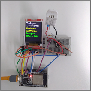

Today we’ll discuss about SPIFFS (SPI Flash File System). These essentially are file systems. Inside the Flash memory, the program is recorded in one piece and the other is free for its own program to save and access files. In this case, Flash is divided by a Lib. This is helpful because it prevents complete dependability on an SD Card, meaning less hardware. And yes, 1.3 megabytes is enough to save a lot. I’ll also discuss an application with fixed records on file using SPIFFS of ESP32, and present the assembly and source code used.

· ESP32 WROOM Dev Board
· Display SPI TFT 1.8 ''
· DHT22
· 4k7 ohm resistor
· Button
· 10k ohm resistor
· Jumpers

void showAvailableSpace() { long prevMillis; if(!eventButton && timeout(10000, &millisRefShowSpace, &flagShowSpace)) { Serial.println("Space: "+String(ObjFS.getTotalSpace())+" Bytes"); Serial.println("Used: "+String(ObjFS.getUsedSpace())+" Bytes"); resetDisplay(); showDisplay("Total space:"); showDisplay(String(ObjFS.getTotalSpace())+" Bytes"); tft.setTextColor(ST7735_YELLOW); showDisplay("Used space:"); showDisplay(String(ObjFS.getUsedSpace())+" Bytes"); tft.setTextColor(ST77XX_GREEN); showDisplay("Free space:"); showDisplay(String(ObjFS.getTotalSpace()-ObjFS.getUsedSpace())+" Bytes"); // Registramos 4 vezes enquanto a mensagem aparece no display for(int i=0; i<4; i++) { // Lê temperatura e umidade do DHT String values = readDHTValues(); // Escrevemos no arquivo e exibimos erro ou sucesso na serial para debug if(values != "" &&!ObjFS.writeFile(values, &errorMsg)) Serial.println(errorMsg); else Serial.println("Write ok"); prevMillis = millis(); while(prevMillis+2500 > millis() && !eventButton); if(eventButton) { eventButton = false; // aguarda exibição "FILE DELETED" delay(500); break; } } //fim do for } //fim do if(timeout) } //fim da função
