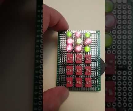

Introduction: Green Double Die
This project is a Double die build with CMOS Technology from its counters to its gates. Beginning by the double counter 4518, its OR, AND and NOT gates 4071, 4081 and 4049 respectively while a 555 timer generates a variable frequency for completing the whole project.

Step 2: The Project's Diagrams
Revise carefully your project before beginning with the same.
Step 3: Installing the LEDs
Once revised the diagram of your project, install the green LEDs by leaving free the common cathode and the positive outputs of each digit display.

Step 8: Probing the First Digit
For probing the first digit, install the IC 4049, 555 timer, and the IC 4518, 4071 and 4081 from the column that corresponds to the proper digit. Once installed the respective ICs, connect the 9V battery so that you can probe it by manipulating the switch.

Step 11: Completing the Project
For completing the project, instal all of ICs and 9V battery. Next, manipulate the switch so that you can observe the results on the respective displays of LEDs.
