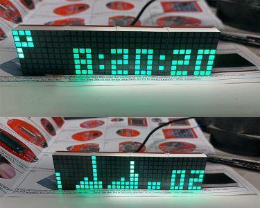

This soldering project is about a DIY Electronic Clock kit with 18 LED Spectrum Effects. It automatically display the music spectrum when there is sound; Display the current time when there is no sound. Users can choose to switch between 18 music spectrum display modes and so on.

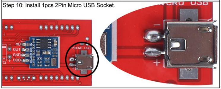

Step 10: Install 1pc 2Pin Mirco USB Socket

Kit includes everything you need to build an electronic clock with spectrum effects! The finished clock will be a good addition to your collection of digital timepieces. Very relaxing project. They are fairly easy as far as surface mount goes, you will want some tweezers for the smaller ones. Ready to start building? Click here to get your clock kit from us!
