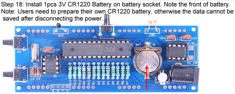

Before the installation, you need to prepare 1pcs 3V CR1220 Battery, and some basic soldering tools such as soldering iron, solder wire, tweezers, pliers.

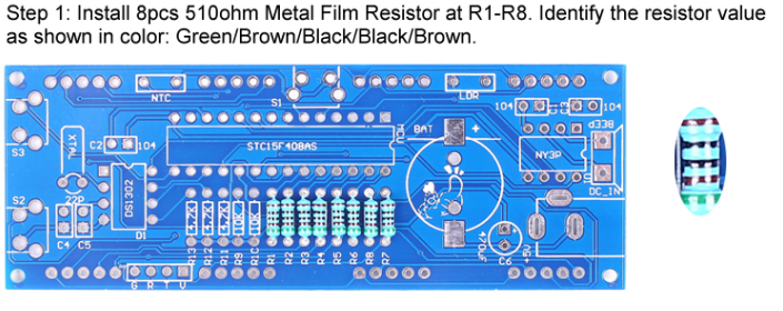

Step 1: Install 8pcs 510ohm Metal Film Resistor at R1-R8
Install 8pcs 510ohm Metal Film Resistor At R1-R8
