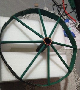

Now it’s time to make the central axis of the wheel. On a white poster board, draw the following rectangle. As shown in image 2, the measurements are 10 cm wide by 30.5 cm long. Once you’re done, cut out the rectangle and roll the poster board into a hollow cylinder using hot glue.
  1. Now it’s ready! I’ll paint it black, inside and out, and decorate it with a strip of rope. (Figure 3)

To form the outer circle, we considered that the radius of the wheel is 15 cm based on the length of the wooden sticks; we used the formula c = 2π·r
c = Circumference
Ď€ = 3.1416...
r = 15 cm
I calculated it: c = 2 x 3.1416 x 15 = 103.62 cm
So, the circumference of my wheel will be approximately 103.62 cm, and I added another 7 cm as a tab to close it, so I cut the cardboard strips to a length of 110 cm and painted them on both sides (Images)
Centered position and close together
To finish, I kept the central axis in place between two blocks using a few drops of temporary silicone. (Make sure to use just a little so you can remove it later.)
And I positioned it leaving half of it sticking out (5 cm), to center the circumference around the painted wooden sticks and glue everything together. First side of the wheel, done. (Images 3 and 4)
  1. Once it is completely dry, carefully remove the silicone drops and glue the remaining 8 sticks on the other side.
