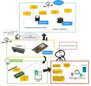

A mind map is a diagram that visually represents ideas and concepts related to the development of a project. It expands through multiple branches, with each branch breaking down aspects of the main concept. These maps often use different elements and colors to create a visually intuitive structure, making information easier to understand.
The following mind map illustrates key ideas and concepts behind this project.
At the core of the project, we have the ESP-WROOM-32, a programmable board with Wi-Fi and Bluetooth capabilities, compatible with the Arduino platform. This board interacts with both sensors and actuators through programming.
Sensors:
  1. An oxygen sensor
  2. A carbon dioxide (CO₂) sensor
Actuators:
  1. An LCD screen to display information
  2. An LED strip for visual signaling
All these components are integrated into a junction box, which serves as the enclosure for the project. This setup allows for efficient organization and protection of the electronic components while ensuring smooth interaction between the different elements.

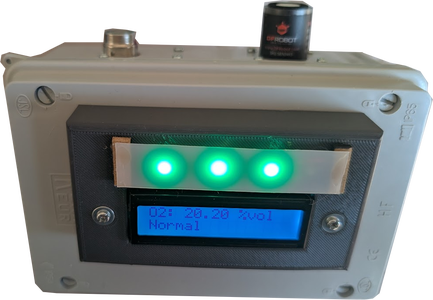

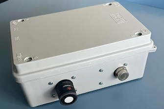

Step 2: Construction
Ok, make the holes to mount the sensors from the inside out, create the socket for the ESP32, and place it inside the box. Take a look at Thingiverse to choose a case for the display and assemble everything using screws.

  12. LCD Display
  13. The LiquidCrystal_I2C library controls a 16x2 LCD at address 0x27.
  14. The program displays three different types of information on the LCD in a round-robin manner:
  15. CO2 level (ppm) and its classification (Normal, Moderado, Alto, or Perigoso)
  16. O2 level (%vol) and its classification (Normal, Baixo, Muito Baixo, Perigoso)
  17. Temperature in Celsius.
  18. This rotation is managed by the lcdState variable in atualizarLCD().
  19. NeoPixel LEDs
  20. Three RGB LEDs (NeoPixel) provide a color-coded status.
  21. When displaying CO2 data, atualizarNeopixelCO2() sets the color based on the ppm level:
  22. Green for normal
  23. Yellow or orange for moderately high levels
  24. Red for dangerous levels
  25. When showing O2 data, atualizarNeopixelO2() uses a similar approach but with different threshold logic.
