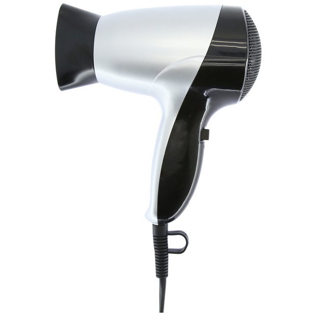

- 2x hairdryers;

As electricity and humidity do not go well together, I've put a couple of towels at the bottom of each enclosure in order to trap any moisture coming down the sides of the enclosures, and I also wrapped the electric parts of the hairdryers (the handle with the controls) in some plastic film. I also wrapped the relays in some bubble wrap plastic so that the high voltage contacts won't accidentally touch other parts of the system, and damage it.
