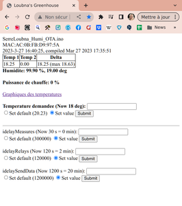

My daughter ask for a heater for her mini-greenhouse. We found a 20W heater mat, and i made the regulation.
The data is send to a ThingSpeak channel:
https://thingspeak.com/channels/2058475
Temp1, sensor in substrate
Temp2, sensor in the greenhouse.
The heater mat is switched with a S202T2 static relay .
Rename the code as you want, but with .ino extension.
In the code, type your channel and API.
There is two DS18b20 and a DHT22, so 3 temp and 1 humidity sensor.

The regulation is made with the average of the DS18B20 temp.
I use a printed circuit with predrilled holes, and solder the components , let says, freely. All resistors are under the NodeMCU, because the wires are directly soldered to the pins of the connector.
