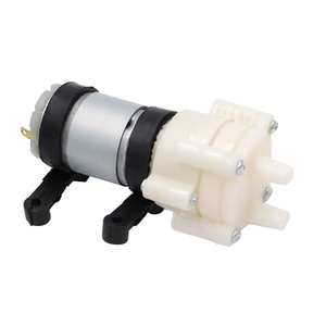

4) DC 12V water pump (in the link similar to what i use)

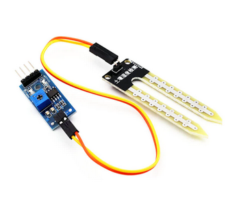

2) Connecting Moisture sensor to the arduino
Moisture sensor Arduino
GND ---------------------------- GND
DATA --------------------------- A0
VCC ---------------------------- 5V

The fan and the water pump are both 12V and connected to the L298N

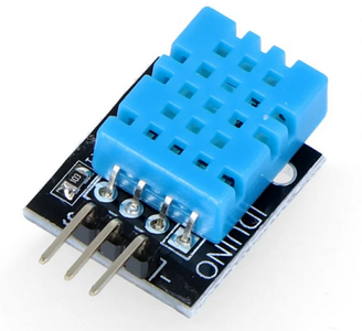

5) connecting the DHT11 temperature sensor to arduino
DHT11 Arduino
GND -------------------------- GND
DATA ------------------------- A3
VCC -------------------------- 5V
