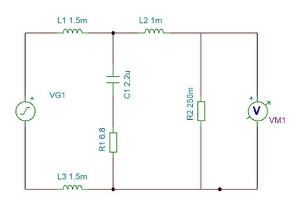

The LCL filter has taken time for me to understand but I think I have it worked out now. It's job is to pass 50Hz content and reject all the high frequency PWM switching frequencies.
I have attached a picture of the filter schematic used in this inverter iteration (R2 represents the ~grid impedance). It involves:
- Inverter side inductance, Li. Comprising 2 x 1.5mH inductors but you can think of it as single 3mH inductor
- The grid side inductance Lg = 1mH
- The filter capacitor, C = 2.2uF
- The filter resistor R = 6.8R

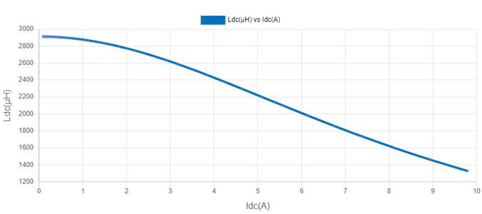

You can use the calculations in the video. I also played around with this online ripple calculator. With a Vbus = 400V, output Vo = 200V and 40kHz switching frequency you can see you need 2.1mH.
Inductors tend to loose their inductance with a DC bias applied. We need to choose our inductor such that it still has 2.1mH even with a DC bias current of 6A.
I chose to build the inductors using this core (FS-185090-2 from power magnetics). I used the Inductor Analyzer tool on the Micrometals website. This tool allows you to select the FS-185090-2 core and input the number of turns applied. I configured the tool for "AC inductor with ripple" and selected 2 series inductors in the "stack". With 102 turns on each core and 2 in series we get a 2.9mH inductor. However with 6A applied the tool tells us that our overall inductance will have decreased to 2mH. Excellent - that's about right.

Step 2 - Ensure that the filter resonances are clear of any frequencies we shall be applying.
I simulated the LCL filter network on Tina. The grid presents an approximate impedance of 250-500mOhm at a socket outlet. Tina plotted the filter attenuation for us and shows a damped resonance at 3.8kHz. I experimented with different filter resistors and 6.8ohms seems to give us a good enough amount of damping.
