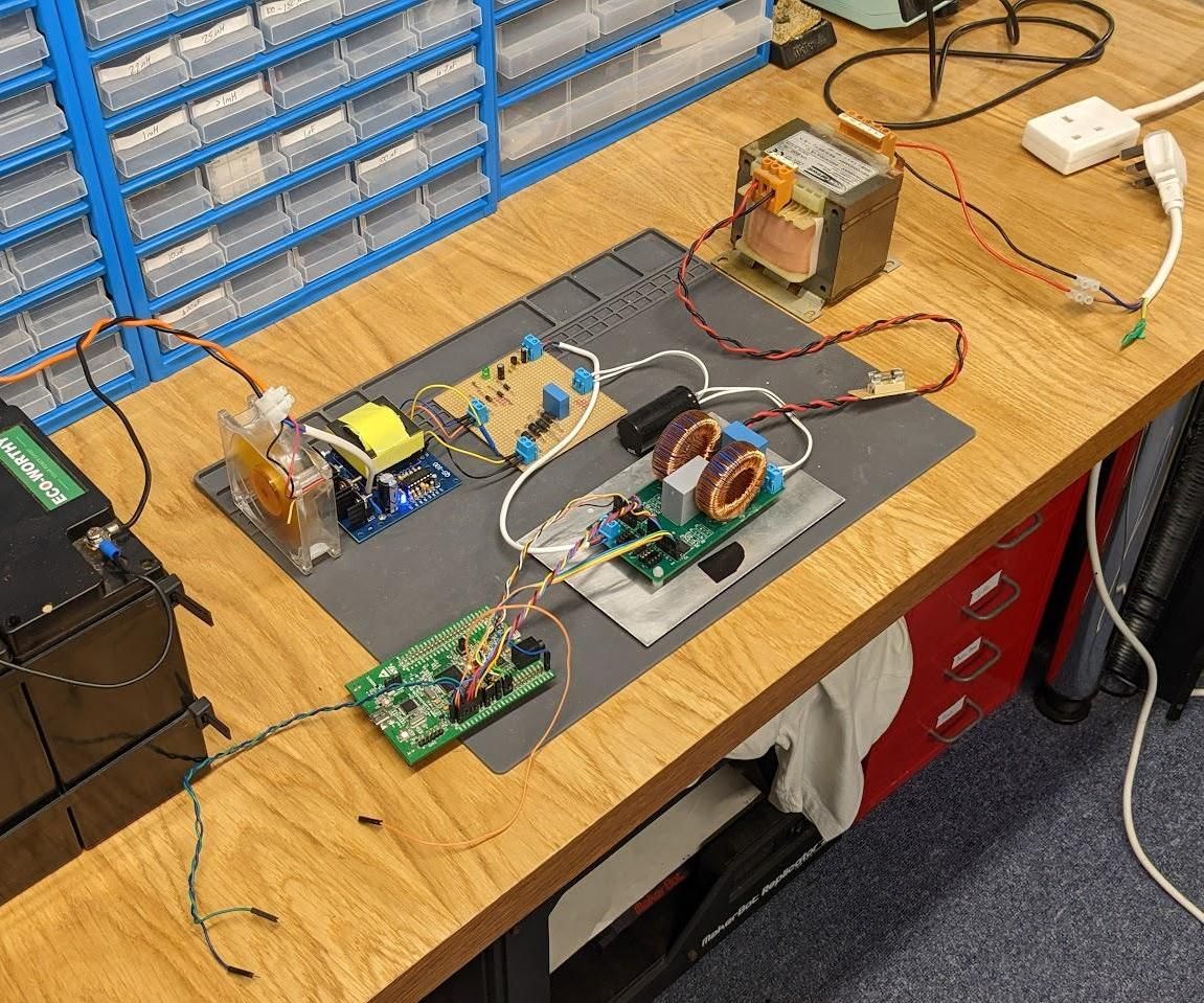

Grid tie inverters enable you to push power into a mains socket which is an awesome ability. I find the power electronics and control systems involved in their design interesting so I built my own. This report shares what I learnt and documents how I did things. I’d be interested in any comments you had (apart from the ones about not messing with mains electricity).
All the concepts are scalable but this setup had a maximum output of 40 watts before the filter inductors began saturating. The output current was sinusoidal with THD < 5%.
See the software on my GitHub
  • I used the STM32F407 development board. It runs at 168MHz and has 3 built-in ADCs capable of 12bit resolution at over 2.4MSPS (Million Samples Per Second) each. That’s insane!
  • I used the DRV8301 development board. This houses a 60v H-Bridge along with the necessary gate drivers, current shunts and current shunt amplifiers. Super nice!
  • I used a 230-25v toroidal transformer with 2 output taps. This meant I didn’t have to directly produce mains voltage but could work with peak voltages of 40 volts instead. Much safer!
  • I connected a load of inductors and capacitors together to get the L and C values I wanted for the filter.
  • An oscilloscope and differential probe is key for a project like this. I have a Picoscope

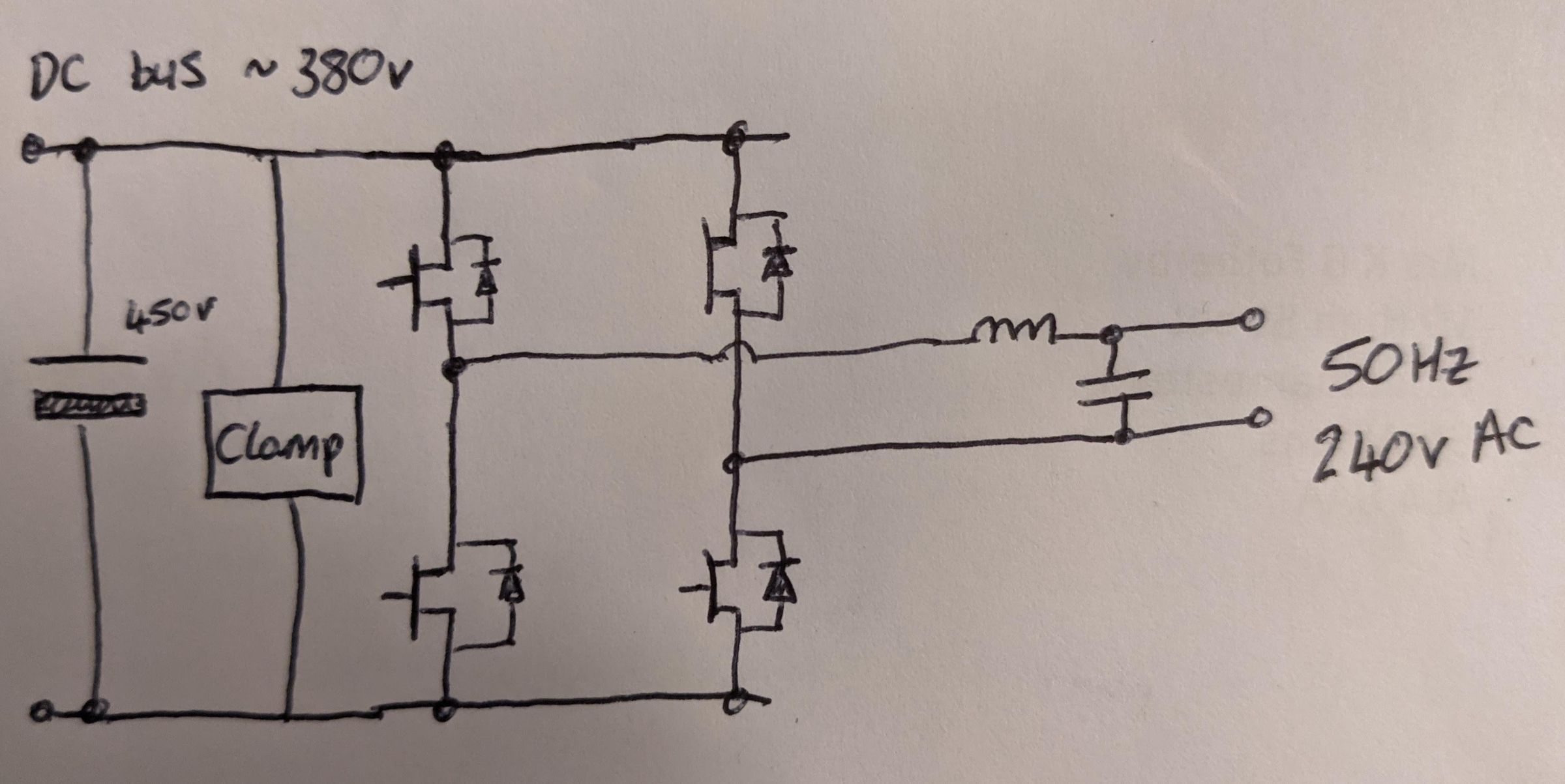

Step 3: Producing the Output Voltage Using PWM
Although we are indirectly controlling the output current, it is an output voltage that we are generating at any given moment. We use PWM (Pulse Width Modulation) to produce our output voltage. PWM signals can easily be produced by microcontrollers and they can be amplified using an H-Bridge. They’re simple waveforms characterised by 2 parameters, the frequency F, and the duty cycle D.
A PWM waveform switches between 2 voltages, in our case 0v and Vsupply
  • With D = 1.0 the PWM waveform is simply DC at Vsupply
  • With D = 0.5, we get a square wave with an average voltage of 0.5 x Vsupply, (ie D x Vsupply)
  • With D = 0.1, we get a pulsed waveform with a period average of 0.1 x Vsupply
  • With D = 0.0, the output is a flatline (DC at 0v)
The average voltage is what’s key. With a low-pass filter we can remove everything but the DC average component. So by varying the PWM duty cycle D, we are able to make any DC voltage desired. Sweet!
Employing an H-Bridge
An H-Bridge is made up of 4 switching elements. These can be BJTs, MOSFETs or IGBTs. To produce the first half (0 - 180 degrees) of the sine wave, we set phase B low by turning Q3 off and Q4 on (ie. applying PWM with D = 0). We then perform our PWMing on phase A. For the second half, where VAB is negative we set Phase A low and apply our PWM to phase B. This is known as bipolar switching.
The MOSFETs in the H-bridge must be driven by a gate driver. This is a topic of its own but a simple chip can take care of it. The DRV8301 dev board conveniently houses the H-Bridge, gate drivers and current shunts for us making this project a hell of a lot easier.

Step 8: Testing
I tuned the PID parameters to get a good control response. The images above show the output with the blue trace representing the grid voltage and the red our output current. You can see on close inspection that there is a small phase shift between the output current and voltage. This is a result of our PI controller having some lag.
It’s hard to measure the efficiency but when pumping out 38 watts the H-Bridge only felt warm. The transformer is lossy, you can see in the IR image that it was 35 degrees with it just connected to the mains and doing nothing! I measured a 85% conversion efficiency of the inverter when outputting 38 watts not including the transformer losses.
Step 9: What’s Next? What Can Be Improved?
Next I want to build 250w transformerless system! We’ll neaten up the horrible mess that was this prototype and build something more rugged.
The limiting factor on the output power is caused by the low saturation current of the filter inductors. I suppose we have a few choices:
  • Choose bigger inductors with higher saturation currents
  • Increase our filter frequency and possibly PWM carrier frequency
  • Use higher voltages and lower currents
The last 2 points here are the way to go. I used a transformer to step up the output voltage as a last step. This meant our filter was dealing with low voltages ~25v RMS and high-ish currents ~2Amps. This limits our power to about 40w.

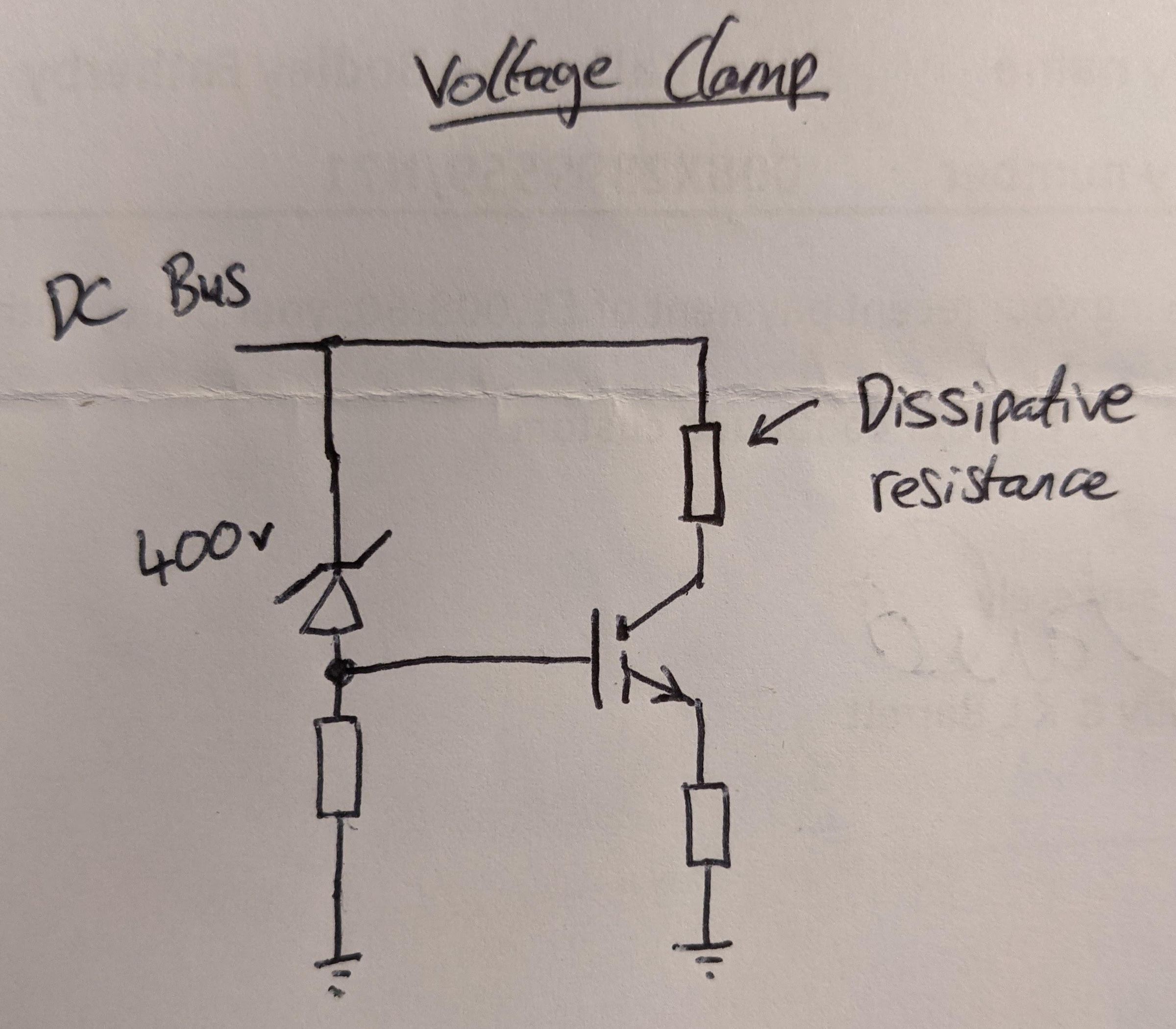

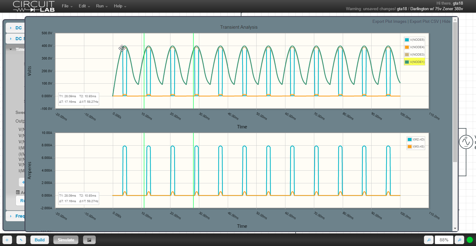

Higher voltages are better. Our capacitors are rated for up to 450v. If we directly produced mains voltage of 230v RMS we could still use the same inductors and get nearly 500w output power. This is how most commercial inverters do it. They avoid output transformers altogether to save bulk and expense.
Using higher voltages necessitates H-bridge transistors with appropriate voltage ratings too. At low voltages, MOSFETs win by having a lower VDS when conducting. At higher voltages (450 or 600v) IGBTs start to come into their own. It’s also important to ensure the gate drivers can function at high switching voltages and to take care over properly isolating everything too. But other than that not much else changes.
Not having an output transformer introduces the issue of DC current injection. If our circuit’s output current doesn’t quite swing symmetrically then we’re pushing a small DC component into the grid. That’s bad since DC currents wreck havoc on motor efficiency and transformers etc. A non symmetrical current swing could occur if there is any offset in our current shunt amplifiers. We perform a self calibration routine at startup to measure the offsets with no current flowing. This allows the error to be compensated for. It’s possible to suppress DC current injection but not eradicate it entirely.
I think we have also been overly conservative when it comes to the filter. We could probably get away with a filter frequency more like 3-4khz which would allow for smaller inductors or ones with greater saturation currents. LCL filters are more commonly used on commercial GTIs. I believe they offer better performance but complicate the design a bit more.

    Hi, I currently have a grid tied solar system and was thinking of building an inverter that can simulate the grid during a power outage. I'll be isolating and plugging in my simulator to get the Grid Tied inverter running.
    The issue I want to address is the backfeeding of power from the Grid Tie inverter going to my pure sinewave inverter or maybe a generator.
    I'm thinking to solve this issue by installing a dummy load that would be maybe Arduino controlled or Raspberry PI if hopefully fast enough..... That it will basically dump the extra power from the Grid Tie inverter if my house is not using enough to the dummy load by sensing the 240v mains and controlling using the 240v voltage level.
    What are your thoughts on this?
    fotherby
    fotherby
    Reply 1 year ago
    Hi, I think I understand what you are trying to do:
    - Use a battery powered sine wave inverter (SWI) to power your island
    - Have your solar GTIs supplementing the island so the SWI does less work
    - If the solar GTIs are producing more power than the island's total load, have something that dumps the excess power.
    I've had a few ideas. The SWI will have a ~380V DC Bus. The 12V to 380V DC/DC converter in the inverter will likely be unidirectional. ie. if the DC Bus voltage rises it won't be able to convert it back into 12V. (Bidirectional inverters can, they can charge batteries etc from the grid or discharge batteries into the grid. But a typical SWI won't have this ability). If you apply an AC voltage to the output of a SWI the H-Bridge MOSFETs inside will effectively rectify this into the DC Bus raising the voltage until the inverter cuts out.
    So I'd expect the SWI may actually naturally absorb any excess AC voltage into its DC bus. If you could clamp the DC Bus voltage and stop it rising then the inverter may not detect a fault. It may not know it's actually absorbing power rather than outputting power. Clamping the DC bus to say 400V (Or just above it's normal maximum value but below any cut-out thresholds) wouldn't be too hard to do. You could have a couple MOSFETs that proportionally switch on above 400V and dissipate power through a resistor bank. I've attached a picture of how this could be done.
    Say you have a 3kW total load. 2kW supplied by the solar GTI and 1kW from a battery powered SWI. If a 1.5kW oven then switched off the solar GTIs would still be trying to push out 2kW so there'd be a 0.5kW excess of power to dump. I'd expect the island grid voltage to jump up a little and for power to start shooting into the SWI. As long as it's DC bus was clamped to ~400V and all this excess power dissipated in a resistive load it may not detect a fault. It may carry on providing the reference 50Hz signal that the solar GTI locks onto, and the microgrid may carry on working.
    Would love to know if I'm right on all this and what you think. I don't know how smart SWIs are. They may detect output current and stop this idea from working but I wouldn't be surprised if all they measure is their own DC bus voltage.

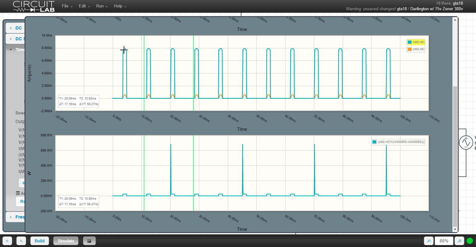

    Hi @Fotherby Here's a circuit I came up with. I plan on connecting a bridge rectifier outside of the inverter because the SWI I have is only rated at 300w and think that it might not be able to handle the current from the GTI when it backfeeds alot of power.
    Looks like from my design, the transient analysis is showing that there will be a pulse of almost 800watts on the N-ch Mosfet for about 0.2ms for every cycle of the Sinewave. Do you think the Mosfet will be burning hot during operation when It is dumping the excess power from the GTI?
    Does the circuit I came up with looks ok or acceptable? Do you have any suggestions? I used a 75v zener and added the resistor below it to achieve the higher voltage at the breakdown. Not sure if I was doing it correctly.
    Thank you

    Hey. I may be wrong but I don't think that circuit will work for a number of reasons.
    1) It doesn't really work as a voltage clamp does it? The circuit I drew dissipates no power until a certain voltage threshold is reached at which point lots of current starts flowing and power is dissipated.
    2) I don't think an external rectifier clamp will work because as you have pointed out it's power factor is horrible. It'll introduce significant harmonic content that I would have thought would trip the solar inverter anti-islanding.
    I was suggesting a voltage clamp directly on the DC bus internally on the SWI because the inverter will actively rectify the line voltage with power factor close to 1 via its filters.
    2) Your SWI will need to have a rated power equal to solar inverters since it needs the potential ability to absorb all the solar inverter power.
    I think what you are trying to do is a little tricky but good effort

    According to the simulation, it will clamp at voltages over 380 but you're right that this will introduce a lot of noise in the system since I'll be doing it at the AC side.
    I maybe fork in $400+ bucks to get a SWI at 3kw (Ouch).
