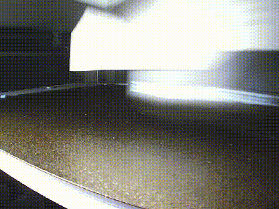

Step 2: Printing the Adapter
Step 2: Print the Adapter
Load the included STL files into your favorite slicer software and 3D print the adapter. For best results:
  1. Use PLA or PETG.
  2. Print at 0.2mm layer height.
  3. Use at least 30% infill for durability.
  4. Support Material is needed
Once printed, check for a snug fit with your grinder and portafilter.
