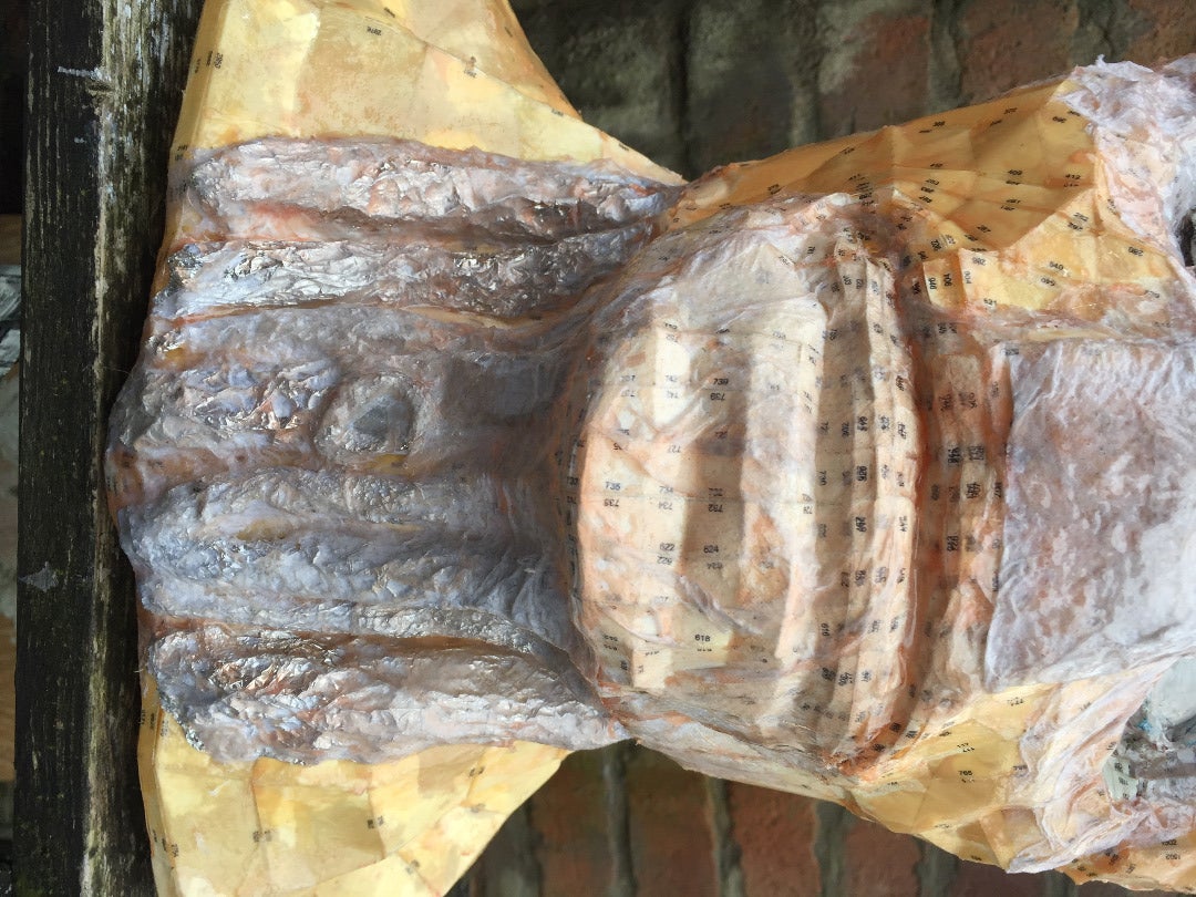

Careefully Cut out each part (I opted to starte with the underside and worked up from there) . i also used the back of the knife to score alongh the fold lines. ( --- for mountain fold. -.-.- for valley fold). Glue the tabs and continue .
Due to size and complexity of this model, I used fiber glass resin on the inside of the shoulder and neck area before continuing with the face and crown. this helped streanthen the model.
Once complete coat the ouside in a cvouple of coats of fiberglass resin. you can also fiberglass the whols base unserside to makle iot more stable.

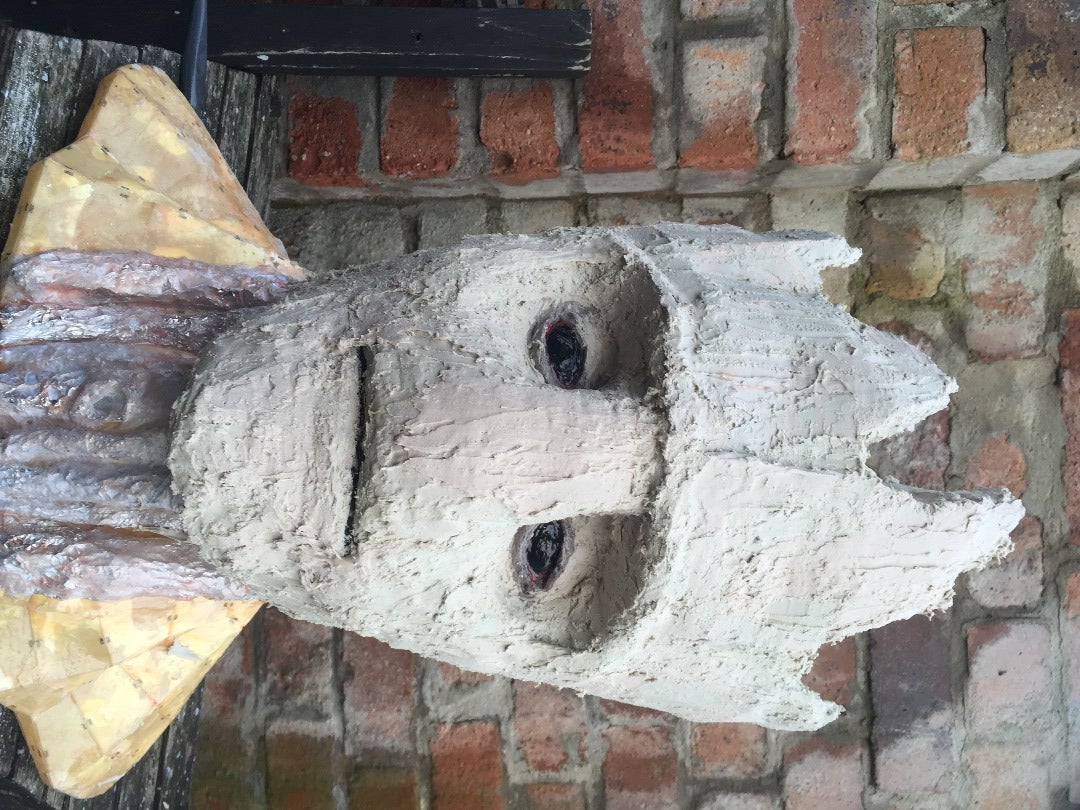

Step 3: Bondo
Now for the fun part.
Mix car body filler (Bondo) in small workable amounts. Apply to designated area and sculpt. I found iot easier to apply a relatively thin amount, allow to cure slightly and then work in the bark effect with a scraper. Don't overwork as this stuff seems to be designed to do the oposite of what you want. (All of the youtube videos i watched showed people struggling to get it smooth, believe me if you want a rough finish it smooths itslef lovely.) just tease the curing filler with the scraper, typically in the direction of the grain.
Once the basic structure is completed, sand and file as required. Apply more Bondo and repeat.

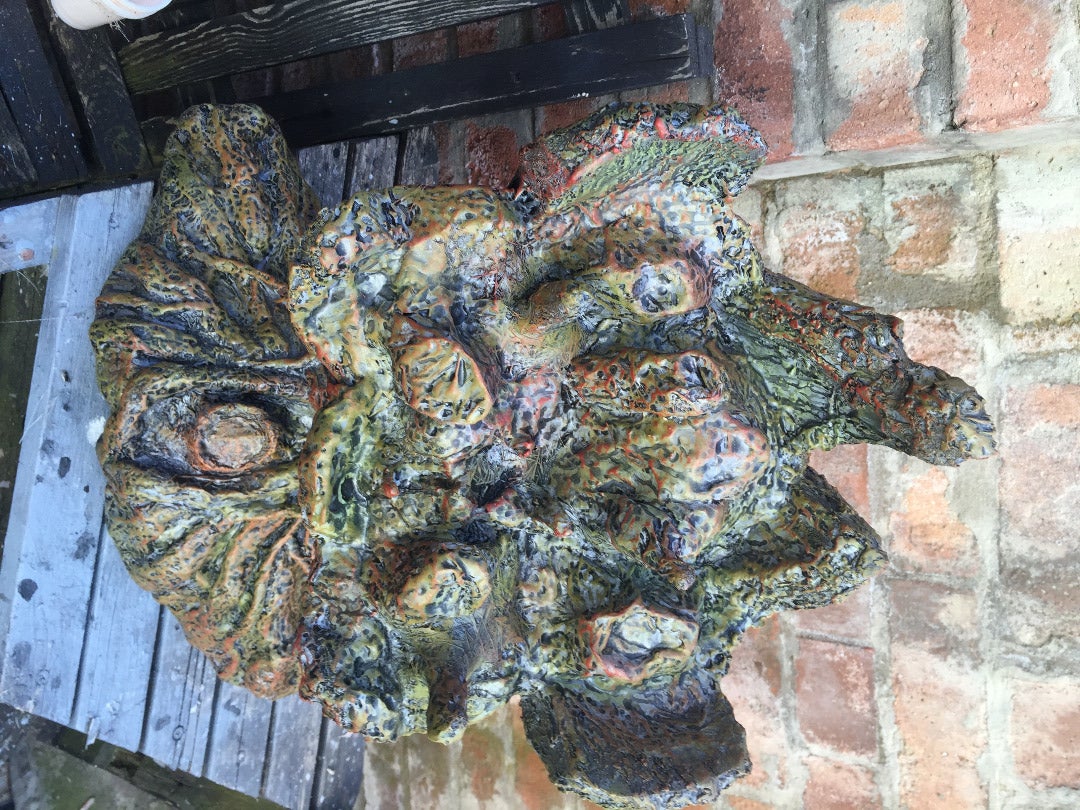

For those of you familliar with the film, you will have already noticed the top forehead area is wrong. its too simetrical and not split. I used a rotary tool to carve into Bondo and then resculped the crown adding much needed texture and height. the initila hollowness was filled with tin foil that was hot glued in place.
I wanted a branch like effect on the shoulders and crown area. fotr this i opted to use crumpled tim foil, to form the basic structure. this was then coated with watered down pva glue and tissue paper overlayed as a papemache to gie the final structure. I spenmt quite alot of time making these appear to overlap and give it a natural branche effect. especiually where they merge or separate. some tightly twisted tin foil was used for the smaller branches.
The same technique was used for the crown. I dabbed tyhe papermache into the join with the bondo to make it seamless.
The papermache was then coated with two coats of fiberglass resin.

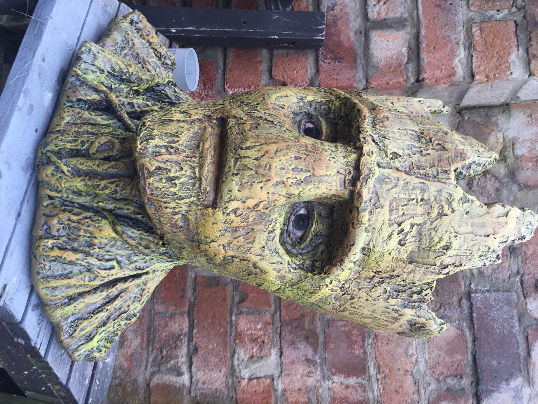

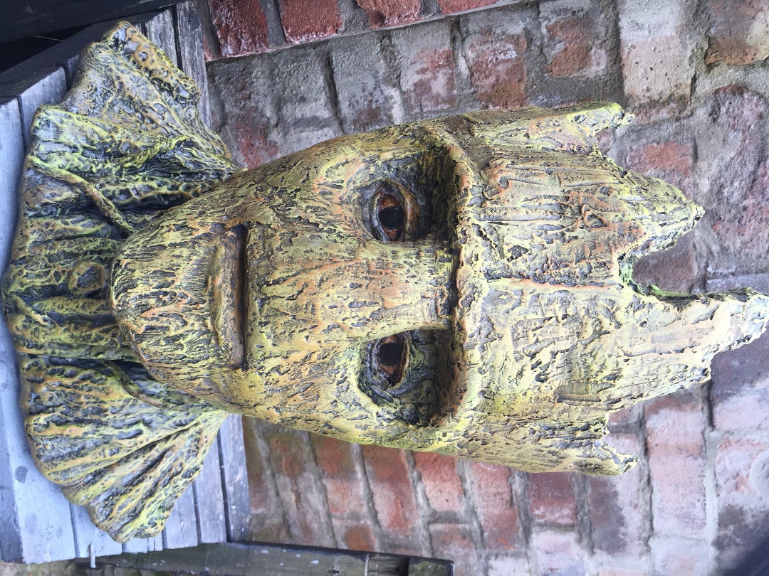

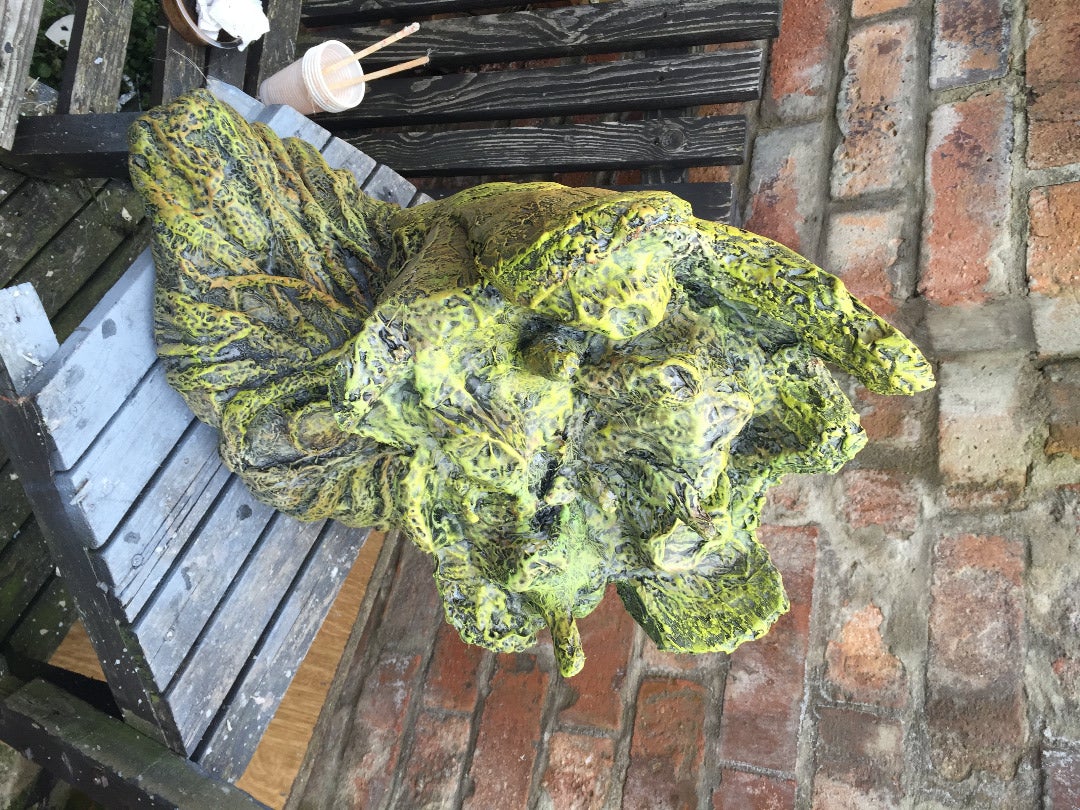

Once i was happy with the overall look and the resin and Bondo were cured, i coated the entire model in grey primer.
Once this was dry, I mixed a small amouint of black satin wood paint with water. (i just had it spare so thought i'd try it) This was then coated over the entire model. To my surprise, the paint did not stick to the high areas and gave an instant wood effect which i could work with without too much effort.
I allowed this to dry and then used an assortment of model paints with a 1 inch brush to "dry brush" colour onto the model. Contrary to what you'd expect ,(and, yes it did cause an argument wuith my 13 year old daughter), there is relatively little brown on a tree. As such i layered up the effect using a combination of greens, yellows, blues and red with a hint of white as needed. Overall this gave a mottled bark efect which i think is more natural to a tree based lifeform.

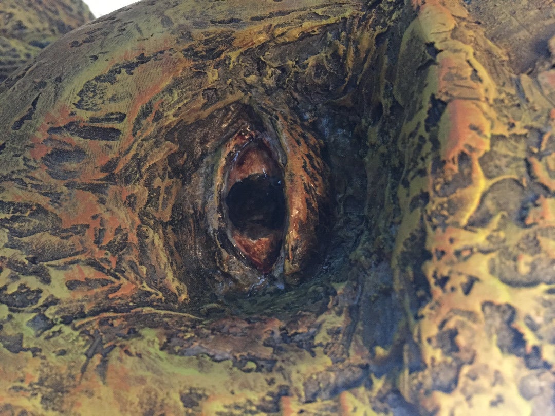

For the eyes i simply pained them white, applied a circle of black to the centre and then used a combination dark oak and clear gloss varnishes. this is a trial and error approach to get the final look. ( i think i resarted ity about ten times before i fially got it right
The whole model was then coated in a matt finish (eyes masked out to keep them glossy)
