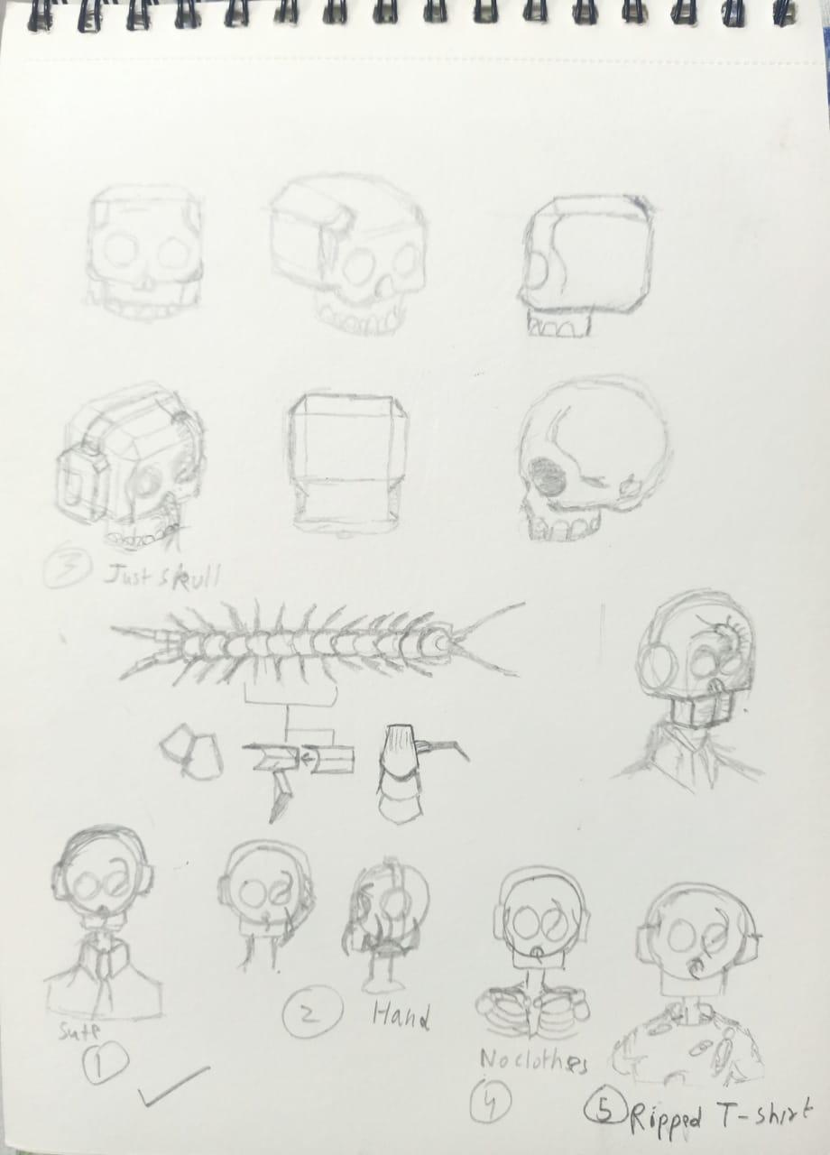

Step 1: Sketching and Brainstorming
I got my inspiration from an artwork I found on Pinterest. Using it as a base, I sketched a few variations — changing the clothing, accessories, and details — before finally deciding on a simple skeleton wearing headphones with a centipede crawling on it.

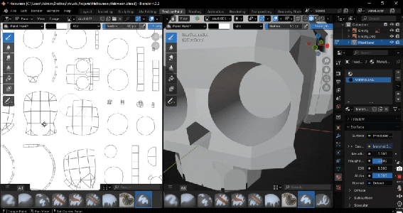

Step 4: Texture Painting the Model
After finishing the 3D model, it was time to paint it and bring it to life. I switched to the Texture Paint tab in Blender and, in Edit Mode, selected everything using the shortcut ‘A’. Then, I created a UV map by pressing ‘U’ and choosing Smart UV Project.
Once the UV map was ready, I created a new image and started painting different sections — the skull, the headphones, and the centipede — each with its own details and colors. When I was happy with the result, I exported the texture as a .PNG file to use later in Pepakura.

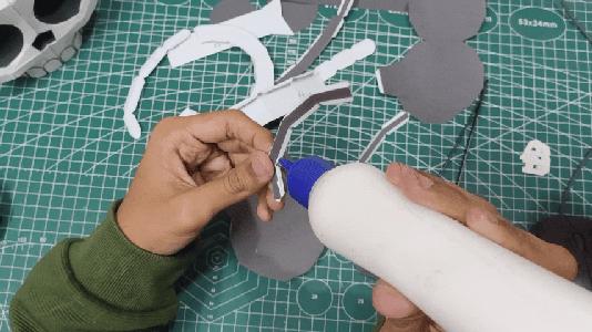

Similar to the previous two parts, I started by cutting out all the pieces and grouping them according to their sections so they wouldn’t get mixed up. I first assembled the head sections, labeling them as H1 and H2, and then the tail sections, marked as T1, T2, and T3.
Next, I cut out the pieces for the 12 identical body sections that make up the main part of the centipede.
To achieve articulation, I connected all 16 sections using thread. I glued one end of the thread to the first piece, passed it through each section, and glued it in place to keep them linked while still allowing movement.
Since I didn’t model the legs, teeth, or antennae, I made them out of colored craft paper. I cut small triangular pieces and folded them into cones for the legs and teeth. For the antennae, I simply used thin paper strips, and for the eyes, I cut out four small circular pieces. Finally, I applied super glue to the eyes to give them a shiny, reflective appearance — just like real insect eyes.

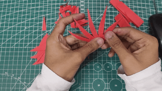

Even after putting everything together, it still felt like something was missing. I wanted to add a unique touch — something that would contrast with the dark, decayed look of the skull. I’ve always liked combining elements of life with symbols of death, similar to what’s seen in Día de los Muertos celebrations or floral horror art.
So, I decided to add a Red Spider Lily (also known as Higanbana) to my model. This flower is often associated with death, farewells, and the afterlife — a perfect match for the theme.
To make the flower, I used the same red craft paper, cutting it into strips of various sizes — some thick and some thin for the petals. I arranged and layered them to capture the rough shape of the flower. For extra detail, I added a few small yellow paper pieces to act as the anthers or pollen, giving it a more natural and complete look.
