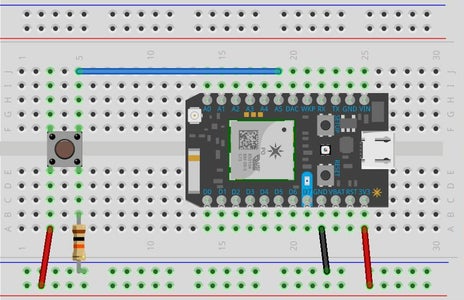

Step 4: Particle - 2 of 4 :: Button Hardware
Put your electronic together using this schematics image above.
Pop your Particle Photon (w/Headers), button, and resistor onto the breadboard as shown on the image. Place your jumper wires as shown. Power it up with your micro USB cable connected to your computer.

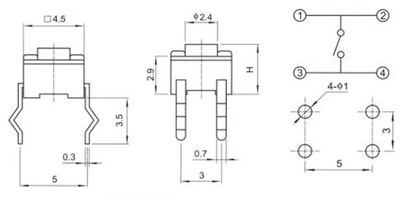

Notes: Make sure your momentary push button is connected properly. The button has four header pins but it's really just like a two pin button (see image)

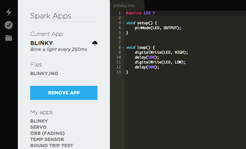

Step 5: Particle - 3 of 4 :: Button Sketch
Your Photon button's light should be "Breathing cyan" indicating that it is connected to the internet.
Now we can use the Particle Build online IDE to upload a sketch to it.
This link is a quick pass at how to 'Flash' your app/sketch

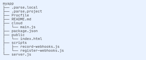

- Confirm the files were created in the directory Terminal is pointing to
The directory structure should look like the image. Instead of it saying 'myapp' it should say 'SMSbutton'. Now find the file: cloud > main.js. ...
