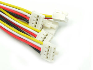

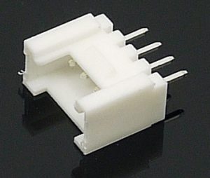

So what is a Grove Connector?
A Grove connector is a four pin standardized size connector used to plug into base units and Grove modules. The picture above shows the male Grove Connector. The male connectors come in flat 90 degree versions and vertical versions as in Figure 2. Seeedstudio has the exact dimensions in this specification ( http://www.seeedstudio.com/http://www.seeedstudio.com/wiki/images/6/69/3470130P1.pdf). These standardized connectors (common to all types of Grove Connectors) are the key to making this system work. They are keyed to prevent plugging them in backwards, and the four types of connectors (see below) are all designed so that if you plug the wrong type of device into the wrong type of base unit, there is no problem. They just won’t work. This is a good thing.
The one exception would be if you plugged in a 3.3V I2C Grove module that is non-5V tolerant into a 5V I2C Grove connector you could fry the device.

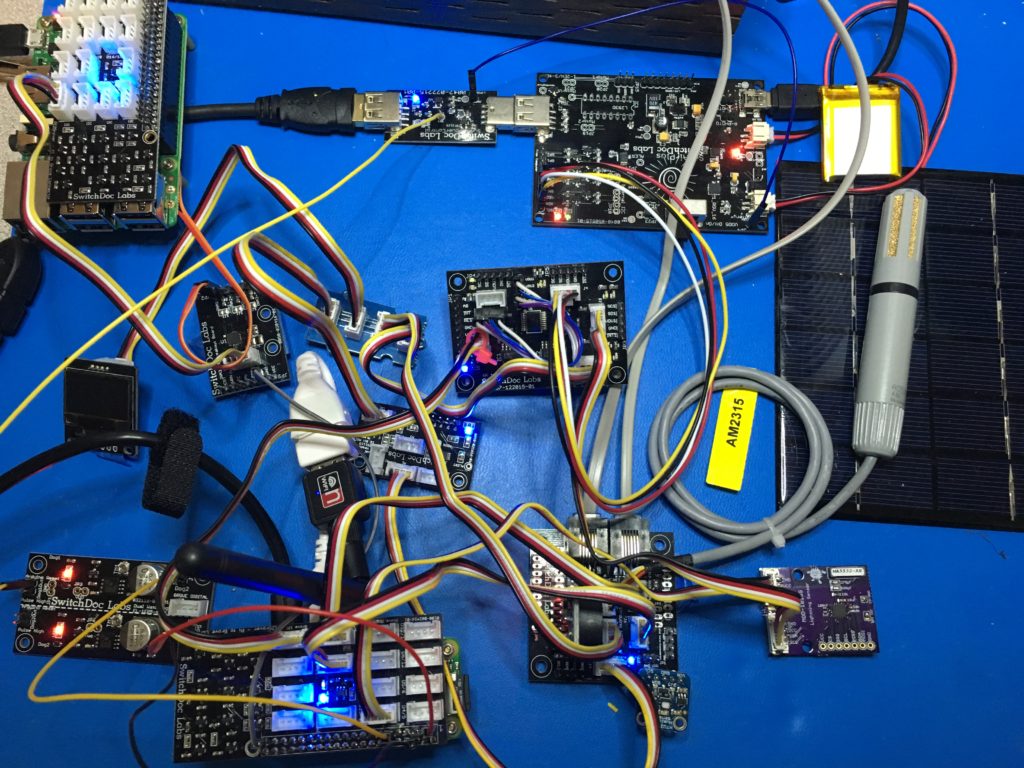

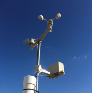

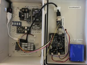

Description of the Weather Pi Project

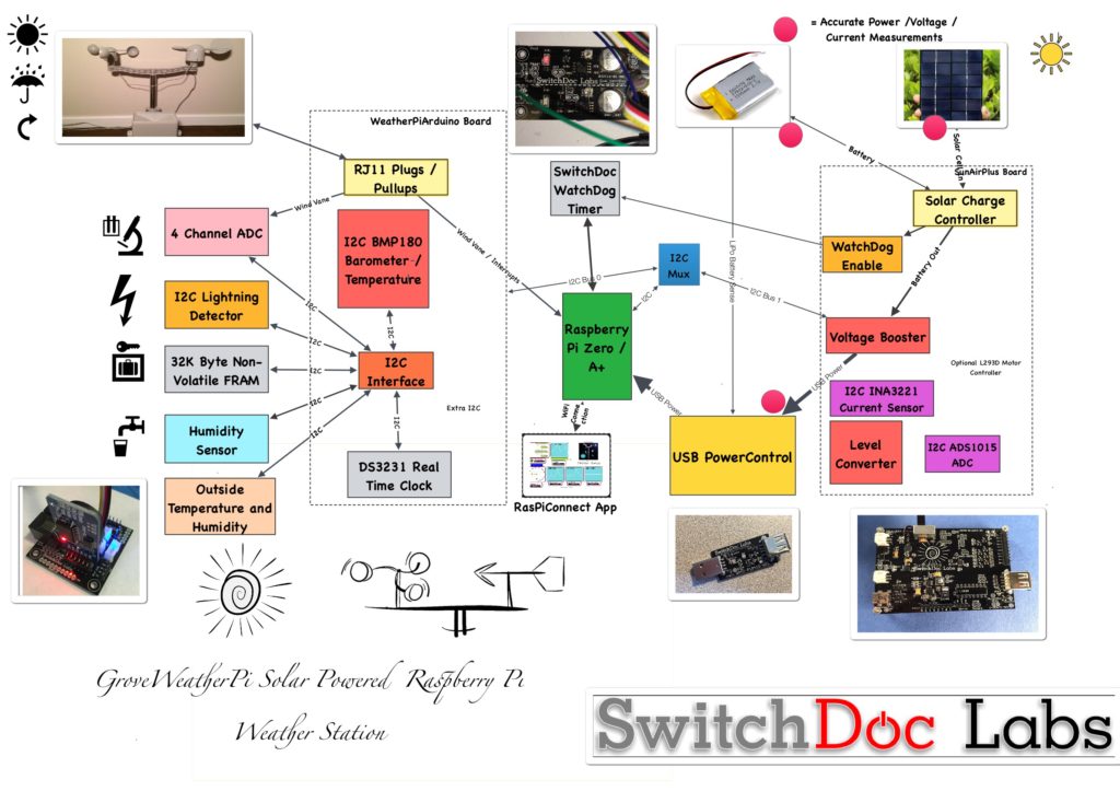

GroveWeatherPi Block Diagram
The GroveWeatherPi Block Diagram looks a lot more complicated than it actually is.
The first thing to notice that the dashed lines are individual boards (Weather Board and SunAirPlus) which contain a lot of the block diagram and the second thing is that all of the sensors to the left of the diagram plug into the Weather Board board which simplifies the wiring. Don't be intimidated!
Virtually all of these wires are based on Grove Connectors.
The Subsystems

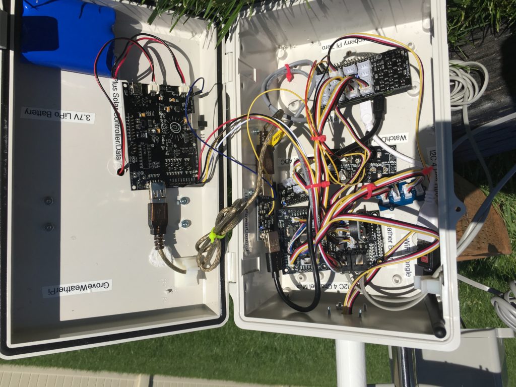

The Sensor Subsystem of GroveWeatherPi uses a WeatherBoard as the base unit and then plugs in a bunch of optional sensors such as wind speed, direction and rain and lightning detection (how cool is that!), inside and outside temperature and humidity as well as barometric pressure.
The Software Subsystem of GroveWeatherPi runs in Python on the Raspberry Pi. It collects the data, stores in in a MySQL database, builds graphs and does housekeeping and power monitoring.
The Solar Power Subsystem of GroveWeatherPi uses a SunAirPlus Solar Power Controller which handles the solar panels, charging of the battery and then supplies the 5V to the Raspberry Pi and the rest of the system. It also contains sensors that will tell you the current and voltage produced by the Solar Panels and consumed by the batteries and the Raspberry Pi. Gather that Data! More Cowbell! It also contains the hardware watchdog timer and the USB PowerControl that actually shuts off the power to the Raspberry Pi during a brownout event (after the Pi shuts gracefully down under software control).
If you are not building the optional Solar Power system, then you can just plug in a normal Raspberry Pi power supply and then you have a fully functional powered weather station.

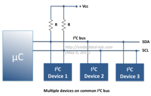

Pullups on the I2C Bus
One import thing to consider on your I2C bus are pullup resistors. The Raspberry Pi has 1.8K ohm (1k8) resistors already attached to the SDA and SCL lines, so you really shouldn't need any additional pullup resistors. However, you do need to look at your I2C boards to find out if they have pullup resistors. If you have too many devices on the I2C bus with their own pullups, your bus will stop working. The rule of thumb from Phillips is not to let the total pullup resistors in parallel be less than 1K (1k0) ohms. The GroveWeatherPi has build in pullup resistors on all the I2C buses.

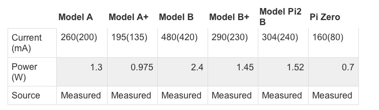

The table below contains estimated power consumption for models of the Raspberry Pi, including a Wireless USB dongle. We are assuming in each of these that you turn the HDMI port off which saves ~20ma.
All of the above measurements include about 60ma for the USB WiFi Dongle! Parenthetical numbers are without the 60ma.
Based on the above, first we will lay out our assumptions for our Raspberry Pi Model A+ based design. The LiPo batteries chosen will store 6600mAh. Why choose the Model A+? It's the lowest current consuming raspberry Pi that doesn’t require soldering.
SOLDERING NOTE: If you want to use a Raspberry Pi Zero, you will need to solder a 40 pin connector on the board. Choosing a Model A+ reduces the need for soldering.
What is mAh (milli Amp hours)? 6600mAh means you can take 100mA for 66 hours, theoretically. In actuality, you will not be able to get more than about 80% on average depending on your battery. How fast you discharge them also makes a big difference. Slower the discharge rate, the more mAh you can get out of the battery. For comparison, an AA battery will hold about 1000mAh ( http://en.wikipedia.org/wiki/AA_battery ) and a D battery will hold about 10000mAh ( http://en.wikipedia.org/wiki/AA_battery ).
In a system like this, it is best to charge your LiPo batteries completely and then hook up the computer and see how long it takes to discharge the battery and die. We did this test on the GroveWeatherPi system. The results are on switchdoc.com ( http://www.switchdoc.com/2015/04/figuring-out-when-to-shutdown-your-solar-powered-raspberry-pi-weatherpi/ ).

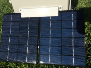

The power system in Weather Pi consists of four parts:
- Two Solar Panels
- One 6600Ah LiPo Battery
- SunAirPlus Solar Power Controller, Pi Power Supply and Data Gathering system
- USB PowerControl board for Raspberry Pi Power Control

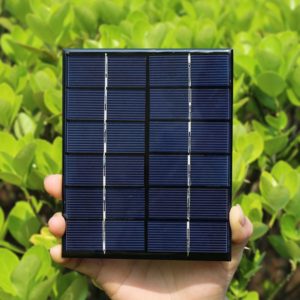

We are using 2 2W/330mA Solar Panels from SwitchDoc Labs. You can use virtually any solar panel as long as they are 6V solar panels. And if you find that your unit is still not getting enough power during the day, then add another 2W panel!. The Voltaic Systems panels will run you about $40 a piece where the SwitchDoc Labs Panels will cost about $12 per panel. We have a lot of experienced with the Voltaics panels in the tropics and they are good panels.
We selected a 6600mAh battery from Adafruit for this design. See the "Sizing your Solar System" step above. We are using a SunAirPlus Solar Power Controller in this design.
SunAirPlus includes an I2C INA3221 3 Channel Current / Voltage Monitor and a I2C 4 channel 12 bit Analog to Digital Converter (ADS1015). The INA3221 allows you to monitor all of the major currents and voltages in the system (Battery / Solar Panels / Load - Computer ). You can tell what your solar power project is doing in real time.

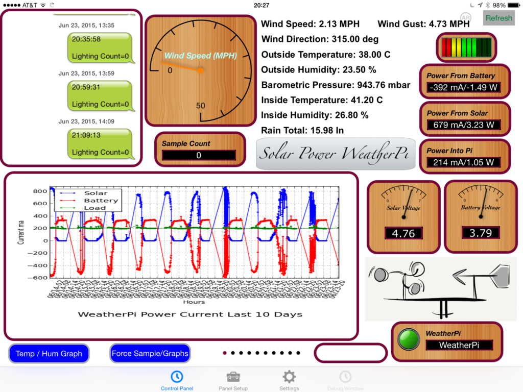

SunAirPlus Results

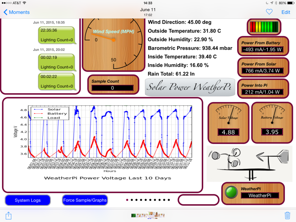

Here are some results from the SunAirPlus board using the onboard INA3221. You can see that the battery is almost fully charged and the solar cell voltage (actually a variable power supply on the test bench) is 5.19V and it is supplying 735mA.Test SDL_Pi_INA3221 Version 1.0 - SwitchDoc Labs Sample uses 0x40 and SunAirPlus board INA3221 Will work with the INA3221 SwitchDoc Labs Breakout Board ------------------------------ LIPO_Battery Bus Voltage: 4.15 V LIPO_Battery Shunt Voltage: -9.12 mV LIPO_Battery Load Voltage: 4.14 V LIPO_Battery Current 1: 91.20 mA Solar Cell Bus Voltage 2: 5.19 V Solar Cell Shunt Voltage 2: -73.52 mV Solar Cell Load Voltage 2: 5.12 V Solar Cell Current 2: 735.20 mA Output Bus Voltage 3: 4.88 V Output Shunt Voltage 3: 48.68 mV Output Load Voltage 3: 4.93 V Output Current 3: 486.80 mA
You can use this board to power your projects and add a servo or stepper motor to allow it to track the sun using photoresistors to generate even more power. We ran a test on tracking the sun to prove our point ( http://www.switchdoc.com/2016/05/sun-tracking-solar-power-part-1/ ).

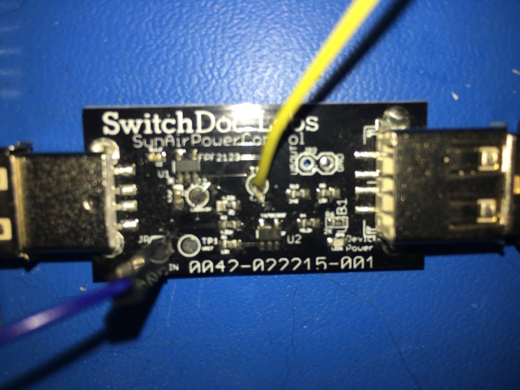

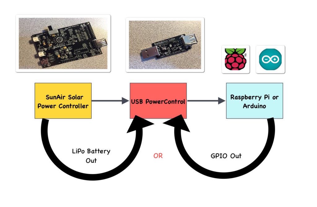

Controlling the Raspberry Pi Power
The USB PowerController Board is basically a controlled Solid State Relay to turn the power on and off to the Raspberry Pi. This board sits between the Solar Power Controller (SunAirPlus) and a Raspberry Pi Model A+. The input to the board was designed to come directly from a LiPo battery so the computer won't be turned on until the LiPo battery was charged up above ~ 3.8V. A hysteresis circuit is provided so the board won't turn on and then turn immediately off because the power supply is yanked down when the computer turns on (putting a load not the battery). This really happens!!!! You kill Raspberry Pi SD Cards this way. We will talk about this in our next step in this tutorial.
USB PowerControl
Step 3: Turning Your Raspberry Pi on and Off Safely
Safely Turning the Pi On and Off
The Brownout Problem
In this important step, we are going to discuss the problem of powering down and up your Raspberry Pi. In Solar Powered systems, this is called the "Brownout Problem". We will be showing how to use a simple device, the USB Power Control from SwitchDoc Labs to solve this problem.
One of the most important issue in designing a Raspberry Pi Solar Power System is turning on and off. The "Brownout Problem" is a real issue. Why worry? If you have a long string of cloudy days, you may run your battery down. You can compensate for this in your design by adding more panels and more batteries, but that can get really expensive and your system might still run out of power, just a lot less frequently.
Shutting Off the Pi

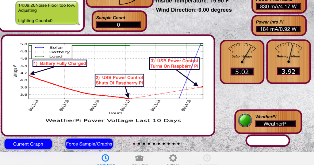

Shutting a Raspberry Pi off is pretty easy. When the battery voltage falls below some value, you just do a “sudo shutdown -h now” and your Raspberry Pi will shutdown cleanly. After doing the test talked about here ( http://www.switchdoc.com/2015/04/turning-the-pi-on-and-off-weatherpi-solar-power/ ) , we chose 3.5V as the voltage to shut down the Raspberry Pi.
Note that in most solar power systems, you need to monitor the battery voltage and not the 5V power supply because with most modern voltage booster systems, the circuitry will work very hard to keep the 5V going and then just give up crashing to a much lower voltage when it runs out of power.
Showing Shutdown Voltage and Startup Voltage on the Raspberry Pi
That means your computer would have little or no warning when the voltage is about to drop. By monitoring the battery voltage, you can tell when the battery is getting low enough and then shut down your computer safely. For LiPo batteries, this will be when your voltage gets down to about 3.5V or so. This can all be monitored with the SunAirPlus solar charge controller that we are using in GroveWeatherPi.
Starting the Pi
Enough about shutting down the computer. What about starting it up?
The Issue
You can’t just let the controller power up the computer. The problem is that the supply voltage will move up and down until there is enough charge in the battery to fully supply the computer. When the computer turns on (connecting a full load), you will pull the battery down hard enough to brown out the computer causing the Raspberry Pi to crash. This constant rebooting cycle can corrupt and ruin your SD card and cause your computer to never boot at all, even when the power is restored. We had this VERY thing happen to us 3500 miles away with Project Curacao. Arduinos are more tolerant of this, but Raspberry Pi’s do not like a ill-behaved power supply. You just can’t be sure of what state the computer will power up at without a good power supply.
This issue can be handled in a number of ways. The first is to use another computer (like an Arduino made to be very reliable by using a WatchDog - see the Reliable Computer series on switchdoc.com - http://www.switchdoc.com/2014/11/reliable-projects-watchdog-timers-raspberry-pi-arduinos/ ) to disconnect the Raspberry Pi’s power through a latching relay or MOSFET when there isn’t enough power. Project Curacao ( http://www.switchdoc.com/project-curacao-introduction-part-1/) used this approach.
We didn't want to add an additional computer to GroveWeatherPi, so we chose a second solution.

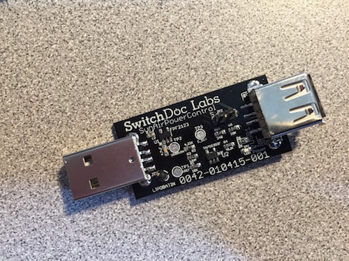

Power Your Pi Up and Down with the USB Power Control
A second (and cheaper!) way of handling the brownout and power up problem is to use a dedicated power controller that will shut the power off to the Raspberry Pi and restore the power when the battery voltage is high enough to avoid ratcheting the supply voltage up and down because of the load of the Raspberry Pi. This is called Hysteresis. We have designed a board to do just this (called the USB Power Controller) that will plug between the USB coming out of the SunAir Solar Power Controller and the Raspberry Pi as in the picture to the below.

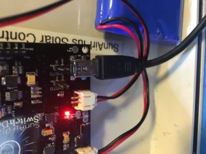

[caption id="attachment_13452" align="aligncenter" width="930"] SunAIrPlus Plugged into the USB Power Control Board[/caption]
The USB Power Controller Board
The USB PowerControl board is a USB to USB solid state relay.
Anything you can plug into a USB port can be controlled with USB PowerControl. It's easy to hook up. You connect a control line (a GPIO line or the output of a LiPo battery) to the LIPOBATIN line on the USB Power Control device and if the line is LOW (< ~3.3V) the USB Port is off. If it is HIGH (above 3.8V) the USB Port is turned on and you have 5V of power to the USB plug.
There is a hysteresis circuit so the board won't turn on and then turn immediately off because the power supply is yanked down when the computer turns on (putting a load not the battery).
There is little software for this device. You connect it directly to your LiPo battery for automatic control! The only software used detects the battery voltage and decides when to shut down the computer. The USB Power Control takes care of shutting the power to the Raspberry Pi when the battery voltage gets low enough. Note that a shutdown Raspberry Pi still draws current (according to one quick measurement, about 100ma).
One More Scenario
One last point. After thinking about the power down sequence, we came up with one more scenario. What if:
- The battery voltage reaches 3.5V and the Raspberry Pi is shut down.
2. The USB PowerController will turn the power off when the battery reaches about ~3.4V.
However, what if the sun comes up at this time and the battery starts charging again?
Then the USB PowerController will never reach ~3.4V and will never turn off. And the Pi will never reboot. Not a good scenario!
We fixed this problem by adding a hardware watchdog timer.
For a tutorial on hardware watchdog timers, read the SwitchDoc series starting here. http://www.switchdoc.com/2014/11/reliable-projects-watchdog-timers-raspberry-pi-arduinos/
We used a Dual WatchDog Timer Board to fix this problem. We set the RaspberryPi python to "pat the dog" (preventing the watchdog timer from triggering) every 10 seconds. The timer is set to trigger after about 200 seconds if it isn't patted. The timer is connected to pull the "COut" point down to ground on the USB PowerController which shuts off the Raspberry Pi.
SOLDERING NOTE: If you choose to add the USB PowerControl you will need to solder a single wire to the COut Test Point. The next version of the USB PowerControl will have two Grove connectors to eliminate this wire.
Because of the hysteresis circuit on the USB PowerController the Raspberry Pi will stay off until the battery voltage reaches ~3.9V and then the Pi will reboot. Now the above scenario will never happen. By the way, there is no real way of using the internal Pi Watchdog to do this. You don't want to reboot the Pi, you want to shut off the power in this scenario.
If you don't want to solder the one wire required (which will be replaced with a jumper pin and Grove connector in the next version of the USB PowerControl board), you may leave this board out. You may have to go out and hand reset your solar power station when the above scenario occurs, but hopefully not too often.
Block diagram of USB/SunAirPlus

Step 5: The Wiring List for the GroveWeatherPi
The Wiring List
Fully Wired GroveWeatherPi
Here is where we install all of the Grove cables, the 7 jumper wires and the one optional jumper cable to a SOLDERED joint on the USB Power Control Board.

Raspberry Pi Power Micro USB | USB PowerControl USB Out | Uses USB cable - A/MicroB |
USB PowerControl USB In | SunAirPlus 5V USB Power Out | |
USB PowerControl LIPOBATIN | SunAirPlus JP4 Battery Out | Female to Female Header Jumper Wire |
SunAirPlus - From Computer / SCL | Yellow Female Header Pin on Grove Connector | SCL |
SunAirPlus - From Computer / SCL | White Female Header Pin on Grove Connector | SDA |
SunAirPlus - From Computer / SCL | Red Female Header Pin on Grove Connector | VDD |
SunAirPlus - From Computer / SCL | Black Female Header Pin on Grove Connector | GND |
Grove Connector (Previous 4 Items) | 4 Chan I2C Mux / Grove J4 - Bus 2 | Female Pin Header to Grove Connector |
SunAIrPlus Battery Female Plug | LiPo Battery JST-2 Plug | |
SunAIrPlus Solar Panel Female Plug | Solar Panel JST-2 Plug - Note: If you have two solar panels, you will need to solder + to + and - to - on the back of the solar panels. A VoltaicSystems Solar Panel will require an adaptor plug |

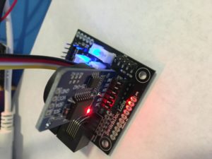

DS3231 Real Time Clock
Plug the included DS3231 Real Time Clock into the provided socket on the Weather Board. Align the GND pins! The battery faces the inside of the board and the LED side faces the outside of the board.
Now before you power anything on, go back and check every connection!
Step 6: Building the Box
Building the Box
As with most projects, we tend to "breadboard" the circuitry before we put it into the enclosure. With GroveWeatherPi, we spread out the parts, wired them up, made sure each of the major paths worked (and of course, took the obligatory nighttime geek shot) and then started placing them in the box, attaching them velcro to the sides, bottom and top of the box.
Once you have it breadboarded you can run the following test.
On your Raspberry Pi install the github archive github.com/switchdoclabs/SDL_Pi_GroveWeatherPi .
Do the following:cd SDL_Pi_GroveWeatherPi cd SDL_Pi_TCA9545 sudo python testSDL_Pi_TCA9545.py Test SDL_Pi_TCA9545 Version 1.0 - SwitchDoc Labs Sample uses 0x73 Program Started at:2016-08-13 18:52:00 -----------BUS 0------------------- tca9545 control register B3-B0 = 0x1 ignore Interrupts if INT3' - INT0' not connected tca9545 control register Interrupts = 0x0 0 1 2 3 4 5 6 7 8 9 a b c d e f 00: -- -- -- -- -- -- -- -- -- -- -- -- -- 10: -- -- -- -- -- -- -- -- -- -- -- -- -- -- -- -- 20: -- -- -- -- -- -- -- -- -- -- -- -- -- -- -- -- 30: -- -- -- -- -- -- -- -- -- -- -- -- 3c -- -- -- 40: 40 -- -- -- -- -- -- -- 48 -- -- -- -- -- -- -- 50: -- -- -- -- -- -- -- 57 -- -- -- -- -- -- -- -- 60: -- -- -- -- -- -- -- -- 68 -- -- -- -- -- -- -- 70: -- -- -- 73 -- -- -- 77 ----------------------------------- -----------BUS 1------------------- tca9545 control register B3-B0 = 0x2 ignore Interrupts if INT3' - INT0' not connected tca9545 control register Interrupts = 0x0 0 1 2 3 4 5 6 7 8 9 a b c d e f 00: 03 -- -- -- -- -- -- -- -- -- -- -- -- 10: -- -- -- -- -- -- -- -- -- -- -- -- -- -- -- -- 20: -- -- -- -- -- -- -- -- -- -- -- -- -- -- -- -- 30: -- -- -- -- -- -- -- -- -- -- -- -- -- -- -- -- 40: -- -- -- -- -- -- -- -- -- -- -- -- -- -- -- -- 50: -- -- -- -- -- -- -- -- -- -- -- -- -- -- -- -- 60: -- -- -- -- -- -- -- -- -- -- -- -- -- -- -- -- 70: -- -- -- 73 -- -- -- -- ----------------------------------- -----------BUS 2------------------- tca9545 control register B3-B0 = 0x4 ignore Interrupts if INT3' - INT0' not connected tca9545 control register Interrupts = 0x0 0 1 2 3 4 5 6 7 8 9 a b c d e f 00: -- -- -- -- -- -- -- -- -- -- -- -- -- 10: -- -- -- -- -- -- -- -- -- -- -- -- -- -- -- -- 20: -- -- -- -- -- -- -- -- -- -- -- -- -- -- -- -- 30: -- -- -- -- -- -- -- -- -- -- -- -- -- -- -- -- 40: 40 -- -- -- -- -- -- -- 48 -- -- -- -- -- -- -- 50: -- -- -- -- -- -- -- -- -- -- -- -- -- -- -- -- 60: -- -- -- -- -- -- -- -- -- -- -- -- -- -- -- -- 70: -- -- -- 73 -- -- -- -- ----------------------------------- -----------BUS 3------------------- tca9545 control register B3-B0 = 0x8 ignore Interrupts if INT3' - INT0' not connected tca9545 control register Interrupts = 0x0 0 1 2 3 4 5 6 7 8 9 a b c d e f 00: -- -- -- -- -- -- -- -- -- -- -- -- -- 10: -- -- -- -- -- -- -- -- -- -- -- -- -- -- -- -- 20: -- -- -- -- -- -- -- -- -- -- -- -- -- -- -- -- 30: -- -- -- -- -- -- -- -- -- -- -- -- -- -- -- -- 40: -- -- -- -- -- -- -- -- -- -- -- -- -- -- -- -- 50: -- -- -- -- -- -- -- -- -- -- -- -- -- -- -- -- 60: -- -- -- -- -- -- -- -- -- -- -- -- -- -- -- -- 70: -- -- -- 73 -- -- -- -- -----------------------------------
If your display matches the above, you have correctly wired your GroveWeatherPi. If some devices are missing, look up the devices above in the I2C Address chart and check their wiring. Always shut down and turn your Raspberry Pi off before changing wiring.
Putting the GroveWeatherPi into the BUD Industries box is pretty straight forward. We chose to put the solar power part of the circuit on top and the Raspberry Pi and the WeatherPiArduino Sensor array in the box bottom. The parts were all placed and then all the screw holes and outside screws were sealed with silicon caulking.

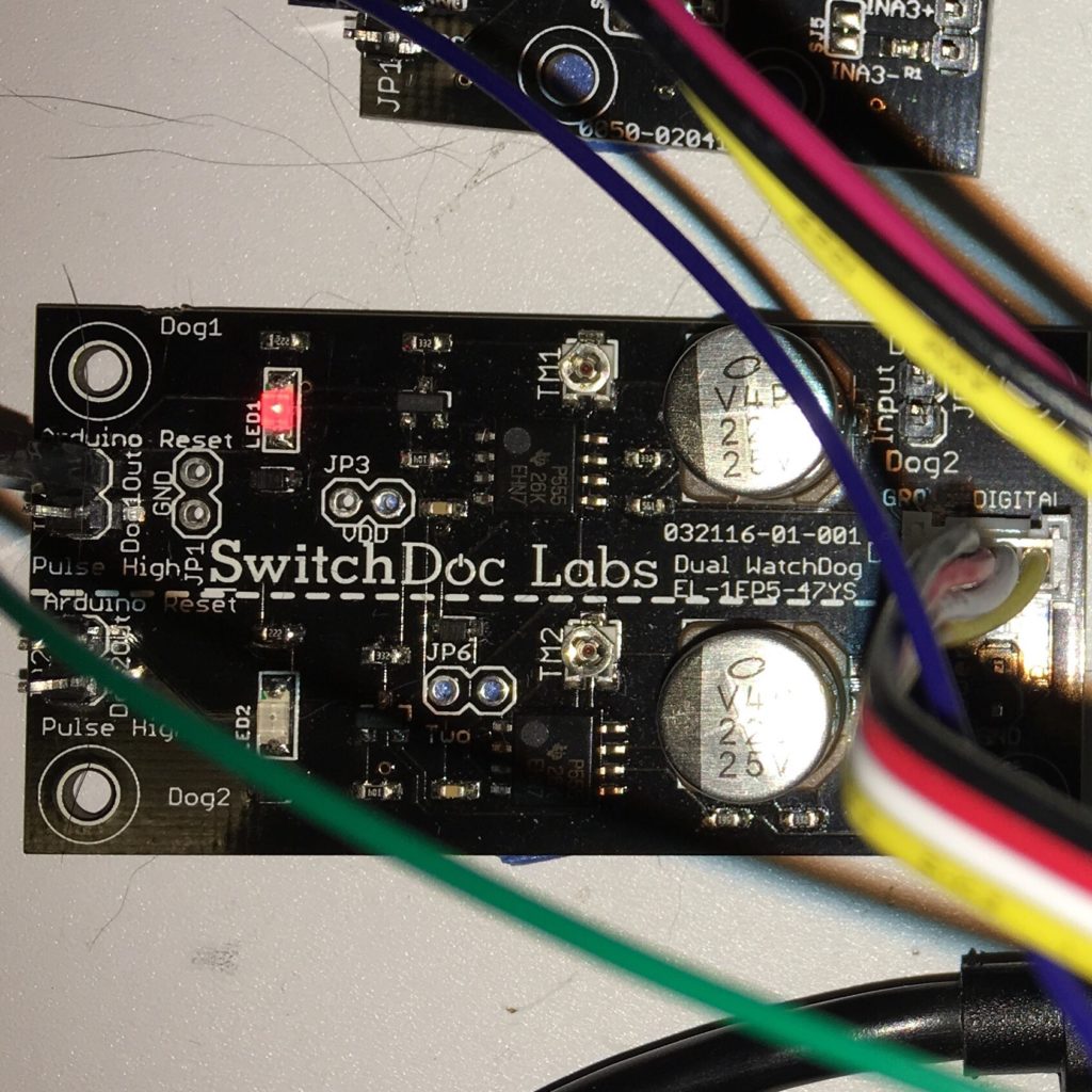

Step 7: The Hardware WatchDog Timer
Optional Section - Dual WatchDog Timer
The addition of the external watchdog timer improves the reliability of your solar powered weather station by removing the scenario talked about in the Watchdog section earlier in this chapter. To add this board, one wire must be soldered on the TP3 (COut) on the USB Power Control part as shown below. This wire is connected to a female jumper header that connects to the DOG1_ARDUINORESET (unfortunately named) on the Dual WatchDog Timer.
FYI, the next version of the USB PowerControl Board will add pins to both of the TP pads so even that soldering part is going away!
] USB Power Control with Wire soldered to TP3
Setting the WatchDog Timer Length
To get your WatchDog timer to wait for 240 seconds before rebooting you must take a small screwdriver and set the timeout internal on the board.
Timer Interval Setting Potentiometer
The timeout interval for each WatchDog timer is set by turning the TM1 single turn potentiometer. It can be set from 30 seconds to 240 seconds. It is set by turning it over a 270 degree range. Turn the small screw to face the 240 second mark in the above figure.
We used strong Velcro with adhesive to mount the parts in the box.
Make sure you place the battery toward the bottom as it is heavy and the heat of the summer could make it come loose.

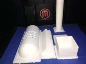

Step 8: 3D Printed Parts for GroveWeatherPi
3D Printed Parts
One of the big changes in the way people build prototypes is the availability of inexpensive 3D Printers. It used to be difficult to build prototype cases and stands for various electronic projects. Now it is easy to design a case in one of many types of 3D software and then print it out using your 3D Printer. For the GroveWeatherPi, we used OpenSCAD ( http://www.openscad.org ) to do the design. OpenSCAD is a free 3D CAD system that appeals to programmers. Rather than doing the entire design in a graphical environment, you write code (consisting of various objects, joined together or subtracted from each other) that you then compile in the environment to form a design in 3D space.
We have three 3D Printed Parts. These can be ordered from store.switchdoc.com if you don’t wish to build your own.
GroveWeatherPi 3D Print Complete
Solar Panel Mount
The Solar Panel Mount is attached via 4 screws to the door of the BUD enclosure. The solar panels are then slid into the slot at the top, holding the panels at a 45 degree angle which is optimal for the latitude at SwitchDoc Labs. If you are building GroveWeatherPi elsewhere in the world, you may want to adjust it to match your latitude. We are currently rethinking this friction fit bracket. It loosens up in the hot sun and we had to apply some glue to make sure it will stay connected.
Solar Panel Mount
Following is the openSCAD code for the Solar Panel Mount.// // WXPi Solar System // // SwitchDoc Labs - 08/08/2016 // // // WXLink outside Solar // include include difference() { union() { cube([30,70,30]); translate([0,-10,0]) cube([30,90,2]); } rotate([0,45,0]) translate([0,-5,10]) cube([3,90,40]); translate([-5,-5,20]) cube([40,80,30]); rotate([0,45,0]) translate([-15,-5,5]) #cube([10,90,40]); translate([19,-5,15]) #cube([15,90,6]); // screw holes translate([5,-5,-10]) #cylinder(h=15, r=2.8); // screw holes translate([25,-5,-10]) #cylinder(h=15, r=2.8); // screw holes translate([5,75,-10]) #cylinder(h=15, r=2.8); // screw holes translate([25,75,-10]) #cylinder(h=15, r=2.8); }

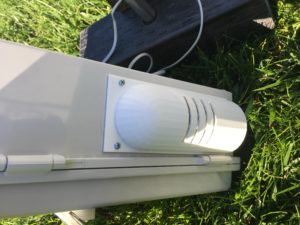

Radiation and Water Shield for AM2315 Outdoor Temperature/Humidity Sensor
The AM2315 is encased, but not totally water proof. It needs to be protected from direct rain and also from direct sun. If the device is in the direct sun, then the temperature will read too high and eventually the humidity sensor on the AM2315 will die. The jury is still out whether we need to put a sun shade above the radiation shield.
Following is the openSCAD code for the Radiation and Water Shield:// //GroveWeatherPi Solar System // // SwitchDoc Labs - 04/01/15 // // //GroveWeatherPi AM2315 Outdoor temp cover // include include module Tube() { // tube difference() { // cylinder(h=130, r=28); cylinder(h=130, r=28); translate([0,0,-2]) cylinder(h=132, r=26); translate([-30,-90,-2]) #cube([231,90,135]); // vents translate([-20,100,100]) rotate(90,[1,0,0]) #cube([40,3,200]); translate([-20,100,90]) rotate(90,[1,0,0]) #cube([40,3,200]); translate([-20,100,80]) rotate(90,[1,0,0]) #cube([40,3,200]); translate([-20,100,70]) rotate(90,[1,0,0]) #cube([40,3,200]); } } module OutdoorCover() { // sphere difference() { sphere(r=28); sphere(r=25); translate([-45,0,0]) #cube([90,90, 100]); translate([-45,-45,-100]) #cube([90,90, 100]); } // tube translate([0,130,0]) rotate(90,[1,0,0]) Tube(); // mounting plates difference() { translate([-30,-35,0]) cube([60,165,2]); translate([-20,-15,0]) cube([40,145,2]); // screw holes translate([25,-24,-2]) #cylinder(r=2,h=15); translate([-25,-24,-2]) #cylinder(r=2,h=15); } } difference() { OutdoorCover(); translate([-50,105,-10]) #cube([100,100,100]); }

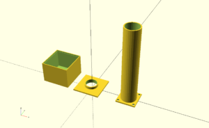

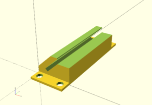

Lightning Detector Pylon
The lighting detector pylon is to move the very sensitive MOD-1016G Lightning Detector away from the noisy electronics within the GroveWeatherPi. We noticed early on that we were getting a lot of spurious lightning detection from the device. Moving it about 30cm from the electronics in a separate pylon fixed that problem.
Following is the Lightning Detector Pylon openSCAD code:// // WeatherPi Lightning Sensor Block Extension // // SwitchDoc Labs 5/18/15 // // module sensorPylon() { // tube difference() { union() { cylinder(120, r=12); // flanges translate([-15,-15,0]) cube([30,30,2]); } translate([0,0,-10]) cylinder(150, r=10.5); // screw holes translate([-12,-12,-5]) #cylinder(h=10,r=2.0,$fs=6); translate([-12,12,-5]) #cylinder(h=10,r=2.0,$fs=6); translate([12,12,-5]) #cylinder(h=10,r=2.0,$fs=6); translate([12,-12,-5]) #cylinder(h=10,r=2.0,$fs=6); } } module sensorBox() { difference() { translate([-16.5,-16.5,0]) cube([43,43,33]); translate([-15,-15,-2]) cube([40,40,32]); translate([-15.5,-15.5,-1]) cube([41,41,3]); } } module sensorPlatform() { difference() { union() { translate([-17.95,-17.95,-1]) cube([40.9,40.9,2]); translate([2.5,2.5,-5]) #cylinder(5,r=10.4); } translate([2.5,2.5,-5]) #cylinder(10,r=9.0); } } /* sensorPylon(); translate([0,0,180]) sensorBox(); translate([0,0,160]) sensorPlatform(); */ translate([60,0,0]) sensorPylon(); rotate(180,[0,1,0]) { translate([50,0,-33]) sensorBox(); translate([0,0,-1]) sensorPlatform(); }

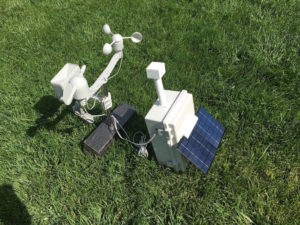

Step 9: Mounting the Outside Parts on the Box
Mounting the AM2315 and Radiation Shield
Drill a hole on the right side (wihtout the clips) of the BUD enclosure and route the Grove plug on the AM2315 inside to the hardware. Using the mounting hardware clip provided, screw the clip down to the base. Clip the sensor into place. Then place the radiation shield over the sensor and screw it down to the BUD enclosure. Note: After some consideration and experience, it might be better to mount this on the bottom of the box to keep the whole assembly and the radiation shield out of the direct sunlight.
Mounted Radiation Shield
Mounting the Solar Panels
Mount the Solar Panel Bracket on to the door of the BUD enclosure and attach it with four screws and bolts to the enclosure. Drill a hole in the door to route the cables with the JST connector into the box.
Mounted Solar Panels

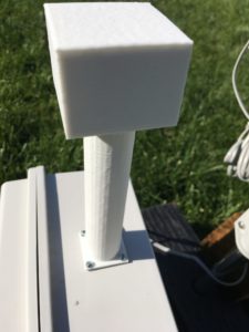

Mounting the Lightning Detector
Drill a hole for the Grove connectors in the top side of the BUD enclosure. Screw the Pylong down, route the wires up through the hole and then place the pylon top onto the pylon. Secure the wired MOD-1016G on the pylon platform and then snap the top box onto the assembly.
Mounted Lightning Detector Pylon

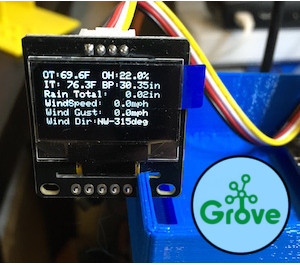

The version 2.8 release of GroveWeatherPi.py contains additional support for new hardware and a number of different improvements in the software.Addition of Grove HDC1080 Support
The original GroveWeatherPi design used a HTU21D-F for sensing inside the box temperature and humidity. It was an expensive device and required soldering. We have now developed and inexpensive Grove based temperature and humidity device based on the I2C HDC1080 IC and you can find the device and documentation here.The HDC1080 is a HDC1000 compatible temperature and humidity sensor. It is located at I2C address 0x40.
Grove - Temperature and Humidity Sensor (HDC1080) utilizes a HDC1080 sensor, from Texas Instruments. It is a digital humidity sensor with integrated temperature sensor that provides excellent measurement accuracy at very low power. The device measures humidity based on a novel capacitive sensor. The humidity and temperature sensors are factory calibrated. The innovative WLCSP (Wafer Level Chip Scale Package) simplifies board design with the use of an ultra-compact package. The HDC1080 is functional within the full –40°C to +125°C temperature range, and 0-100% RH range.
The HDC1080 driver software is also pure Python rather than a C based program called by a Python system call.
You can buy this product on the SwitchDoc Labs store.

- - Support for the upcoming GroveControl device that allows the Raspberry Pi to shut off the power to specific Grove devices for power savings. For example, the OLED display. Since Project Curacao2 is 3500 miles away from SwitchDoc Labs, not very many people will be able to read the display very often.

Running on AC Power
Want to run inside on AC power? Plug a 5V Mini USB power supply into SunAirPlus.
Plugging in a Power Supply to SunAirPlus
Remove OLED Display
Turn off the power now and remove the OLED display from the box, as we won’t be looking at it once we shut the box. Alternatively, you can leave the display in (it takes about 15mA) and put a small plexiglass window on the side of the box to read it.
Step 13: The Final Assembly Step and the Control Panel
The Final Step
Your final step is to connect the wire shown in the table below. This wire allows the WatchDog timer to turn off the power to the Weather Station if the WatchDog expires. The reason you haven’t connected this wire yet is that you haven’t been running GroveWeatherPi.py which “Pats the Dog” and keeps this form happening. If you are are going to be doing a lot of development or changes, it is a good thing to remove this wire or run another program that “Pats the Dog” while you are developing.WatchDog Board JP5/ArduinoReset | USB PowerControl TP3/COUT - Soldered To Pad (DO NOT CONNECT THIS WIRE UNITL YOU ARE DONE TESTING AND MODIFYING THE SOFTWARE!) | Cut one end of 12 inch Female to Female Header Jumper Wire and solder it to TP3/COUT pad as shown below |
Building A Control Panel Using RasPiConnect
We use RasPiConnect ( www.milocreek.com ).to build our control panels for our projects. It allows us to put graphs, controls, buttons, sliders, etc. up on our iPad/iPhone screens without having to write apps. RasPiConnect works on Raspberry Pi's and on Arduinos. We have used this software on 5 different projects, with GroveWeatherPi being the latest.
How to build a control panel for GroveWeatherPi is beyond the scope of this Chapter, but here is the tutorial ( http://www.switchdoc.com/2014/07/build-control-panels-tutorial-raspiconnect/ ) we wrote for doing what we are doing for GroveWeatherPi. We are using the same command passing mechanism in GroveWeatherPi that we used in MouseAir. RasPiConnect comes with an excellent, comprehensive manual here ( www.milocreek.com ) .
All the RasPiConnect code that we used in this project is on github under github.com/switchdoclabs. Note that only the directory local is in the repository as that is the only places changes to the code are made as explained in the RasPiConnect manual.
RasPiConnect Control Panel Showing Solar Current Graphs
RasPiConnect Control Panel Showing Solar Voltage Graphs

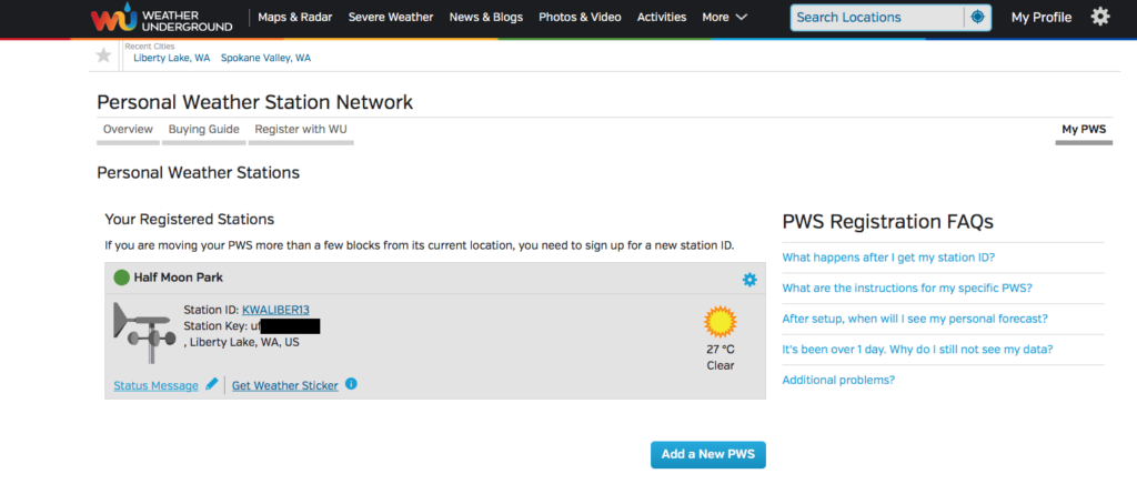

- Go to weatherunderground.com and register your PWS (Personal Weather Station) on the site. You will need to sign up to be a user.
2. When you have registered your station, put your station name and key in the config.py file and enable the WeatherUnderground_Present by setting it to True.
# WeatherUnderground Station WeatherUnderground_Present = False WeatherUnderground_StationID = "KWXXXXX" WeatherUnderground_StationKey = "YYYYYYY"
Then you can start the software normally. The software is set to report to the WeatherUnderground every 5 minutes, so wait a bit before checking.
Status
Our development system is up and down as well as sensors being disconnected and connected, but if you want to see it, here is the link:
https://www.wunderground.com/personal-weather-station/dashboard?ID=KWALIBER13
We will be adding another full station that will be running all the time in the near future. The box is built, but has to be shipped to England for photographing for a new book that features the GroveWeatherPi Solar Powered version.
Step 15: Results and Conclusions
Results!
The GroveWeatherPi has been outside for about 2 weeks now. Working perfectly. You can see the box being charged up and then going to battery power as the sun moves behind the house. We have had hot days and cold nights as we are just starting to move out of Summer into Fall. It is not quite generating enough electricity to run 24 hours at the moment (because it is in the shade until 9am and after about 3pm - not quite 8 hours of sun). This will be fixed when we move it up to the top of the house where it will have sun about 12 hours a day on average (when the sun is not behind clouds!).
WeatherRack on PVC Pole
The cheap RT5370 Wireless Adapter WiFi dongle we are using is shutting itself down occasionally. The Raspberry Pi keeps running, collecting data, etc., but we are locked out of the system. When we look at the WiFi adaptor when it has shut itself down, it is no longer blinking blue, but the Raspberry Pi and all the external hardware is still running. Looking at the web shows some people having had similar problems with this dongle. We have now replaced it with a WiPi USB Dongle which works well. Interestingly enough, the WiPi USB dongle reports it is using the RT5370 also, but the WiPi works.
Full GroveWeatherPi Ready for Installation
