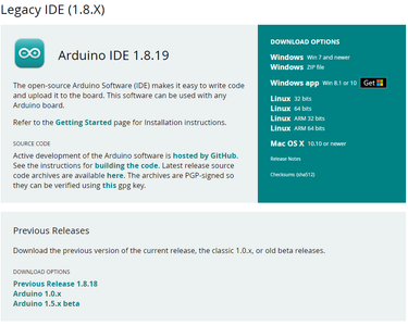

If you have never used Arduino IDE, you will need to download and install it. We'll need to download and install Arduino IDE to upload the code into a microcontroller.
ATTENSION!!! Do not download 2.x versions, at the moment of 10/6/2023 there are still a lot of bugs. It better to download a 1.8.19 version.
Download it here - https://www.arduino.cc/en/software

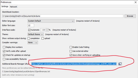

  • After Installing, navigate to File > Preferences
  • Find Additional Boards Manager URLs, and paste this link into a text field - https://github.com/earlephilhower/arduino-pico/releases/download/global/package_rp2040_index.json

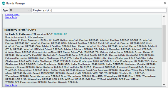

  • Then, navigate to Tools > Board: > Boards Manager
  • Type the "Raspberry Pi Pico" in a search field, find and Install.

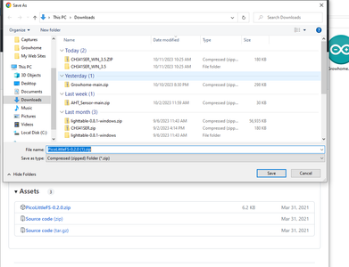

Step 2: Install Arduino-Pico-Littlefs-Plugin
The primary purpose of the arduino-pico-littlefs-plugin is to let you upload the files into the RPI's flash memory. In this tutorial, the purpose of this tool is to format the RPI's flash.
Download the file called PicoLittleFS-0.2.0.zip from https://github.com/earlephilhower/arduino-pico-littlefs-plugin/releases/tag/0.2.0
And then extract the content of the archive into the "...\Arduino\Tools\" folder.
After that, restart the Arduino IDE.

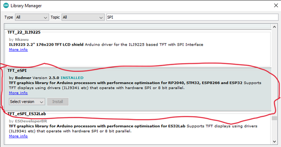

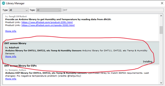

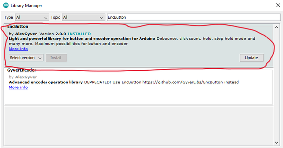

Step 3: Install Libraries

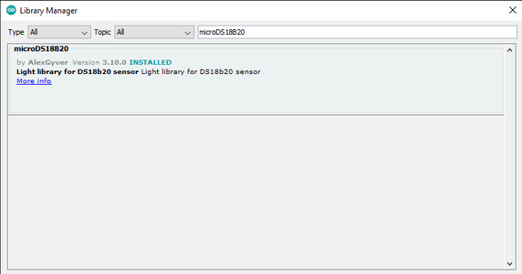

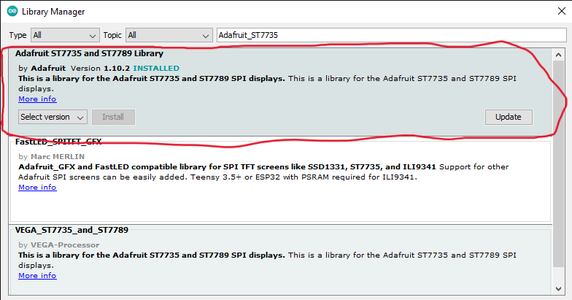

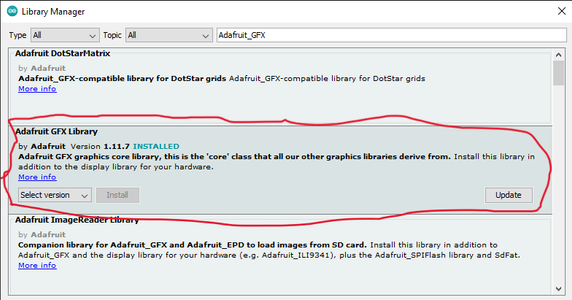

Install libraries is necessary to work with the microcontrollers, encoders, displays, thermometers, other components, and get the information from there.
  • Navigate to Sketch > Include library > Manage Libraries
  • Type every single library one by one and download:
  1. Adafruit_ST7735
  2. SPI
  3. EncButton
  4. Adafruit_GFX
  5. microDS18B20
  6. DHT

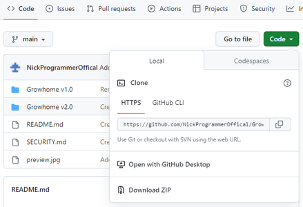

GitHub Growhome v2.0 Repositoryhttps://github.com/NickProgrammerOffical/Growhome
  • Download the .zip on my GitHub.
  • Extract the Growhome folder, then open Growhome v2.0/Firmware.ino file with Arduino IDE.

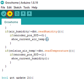

Step 6: Upload the Firmware
The last step of assembling is upload code into microcontroller.

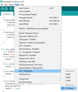

  • Navigate to Tools > Board: > Raspberry Pi RP2040 Boards > Raspberry Pi Pico;
  • Hold BOOT button on Raspberry Pi Pico board and plug it to the computer;
(The step is necessary to be able to see the boot port)
  • Navigate to Tools > Port > UF2 Board;
  • Click upload button in the left top corner;

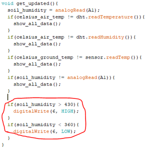

!!!! Everybody has different type of soil.
Different type of soil makes Soil Moisture Sensor v1.2 feel the humidity by different.
So you can find these values in void get_updated() method and change it to your own. !!!!
