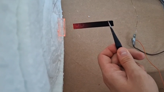

Prepare your wafer by cleaving it into appropriately sizes pieces. For my experiment, I wanted one long strip of around 7cm and 11 smaller pieces of approximately 4x8mm. To cleave a wafer reliably, use sharp metal tweezers (a razor blade or similar will also work well) and press at the edges where you would like the wafer to fracture. Remember that <111> wafers will fracture along a square grid, so only attempt to fracture pieces along a perpendicular to an edge, otherwise the wafer will shatter or split unreliably.
My wafer pieces were to be used in two experiments to characterise the performance of my DIY furnace, these were:
> To verify that the furnace tube was being heated evenly, by baking the long silicon strip for 30mins and checking that the oxide growth on it was uniform.
> To characterise wet field oxide growth in my furnace, by baking the small silicon pieces incrementally at 10min intervals over a 100min period, with an extra data point taken at 120mins.
I assumed a native oxide was of a negligible height. Before putting the wafers in the furnace I rinsed them with distilled water, and arranged the small pieces in a quartz boat. When the furnace was up to temperature, I used my push rod to 'float' the quartz boat into the middle of the furnace, waited 10mins, pulled the boat out, and extracted a sample, and repeated until all the samples were used. The silicon bar was simply baked for 30mins and extracted using the rod. Your experiment will vary depending on your objective.

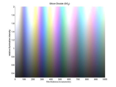

When looking at your oxides, try and use a light source with a broad spectral output (e.g. sunlight, candlelight etc). You can refer to the oxide depth chart to determine the thickness of the oxide layer.
From my results you can see that my furnace was of a uniform temperature in the centre, at the edges it was much cooler resulting in a shallower oxide growing (this can be seen by the colour gradient in the thick bar, the blue side is nearer the edge and hence has thinner oxide). The small brown stains visible on the silicon bar are from particulate matter. Dirt will have been removed by the rinsing stages, so I must have reintroduced some contaminants before placing the bar in the furnace (somehow!). I redid this test using a different sample, this time for 2 hours at 1000°C, and the temperature drop-off towards the furnace edges is clear, (evident in the gradient from purple to blue, with the purple end being much thicker).
Wet oxide growth can be characterised using the Deal-Grove model, which is a simple parabolic relationship. This simplifies further to a linear relationship when the pre-existing oxide layer is shallow. The little samples shown were taken at 10min intervals from 0min (left) to 100min (right) at 1000°C, the 120min datapoint is not shown. I have plotted the results, from which we can see that the oxide growth rate in the linear region is ~6nm/min (or ~60nm/10min as can from the samples using the chart). Note the oxide growth tends off when t is large, this is accounted for by the Deal-Grove model (i.e. we can see the x^2 term in the model ceasing to be negligible, hence the 'square-root-esque' behaviour).
