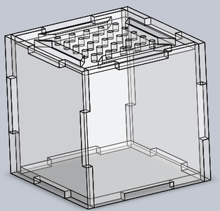

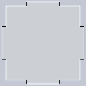

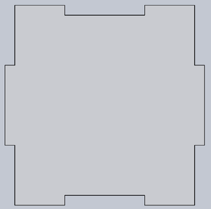

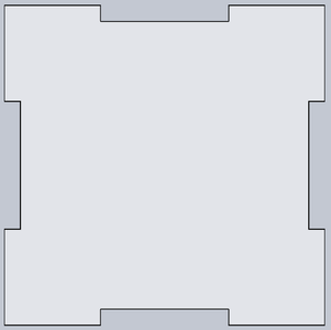

I designed 6 interlocking panels in SolidWorks that together comprise my terrarium design. My design calls for the sides to be laser-cut from 1/4" acrylic. The interlocking design gives it a cool look, makes it a lot easier to glue the terrarium in the right shape, and gives it a better seal when complete.
Step 2: Laser Cutting
I used a 100-watt Epilog laser cutter my college has to cut the panels from 1/4" acrylic. The design was intricate enough that any other cutting method would take longer and not give as nice results. Using the laser cutter, the panels came out with very clean, accurate lines. This made the final terrarium look very nice and helped the pieces interlock correctly when I glued them together.

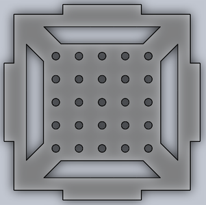

In the solid model design of the terrarium, I designed a 5X5 grid of 5mm holes in the top panel. I bought a bunch of white LEDs off eBay and glued 25 of these into the holes. By folding the leads of the LEDs down and soldering them together, I wired all of the LEDs in parallel. I wired up this circuit to a 5V phone charger I had around. It would be good engineering practice to wire these LEDs in series with the LED circuit to drop the voltage across the LEDs, but because there are so many LEDs they can handle this kind of voltage without burning out. I plugged the power supply into a timer so it automatically runs for 10 hours a day, hopefully giving the venus fly trap enough light.

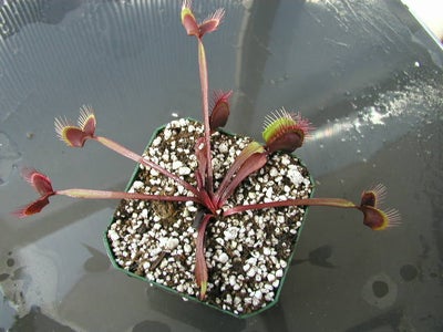

The plants from Predatory Plants seem to be a bit healthier and older, but the Fly Trap Shop has a bigger variety, so it's a trade-off. The one I got for this particular project was from the Fly Trap Shop because they were the only ones with the Akai Ryu cultivar in stock. I didn't know this until I started researching venus fly traps recently, but there are a lot of different breeds available (when referring to plants, they like to call them cultivars). The Akai Ryu (red dragon) cultivar, shown below, is red rather than the traditional green. In the pictures, you can see that mine is green, hopefully because it's still young and not because they sent me the wrong kind.
