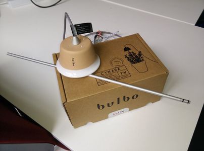

Some time ago I and my friend (Rocco88) had the possibility to know and play with a very good system, Cynara.
It's a single spot rgb LED lamp that grows medium size plants, particularly vegetables and kitchen herbs.

* Cynara Lamp

Connect all the components as described in the schema of the project. We used tinkerKit shield 2.0 because having it, was convenience. The connectors on the shield match those specified in the code. Output 04 -> pin D5 (water pump), 02 -> D9 (cynara lamp), Input I5 -> A5 (light sensor). You can also use a breadboard and set the appropriate connections.
