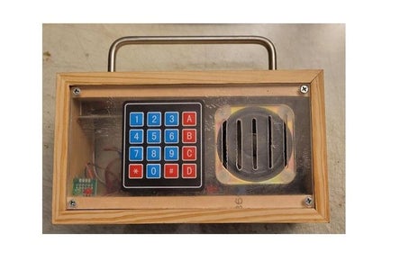

Introduction: Grumpy Box Treasure Hunt Clue
An Ardiuno powered, MP3 playing, clue box for treasure hunts all contained in a wood box. When shaken, the box turns on and in a grumpy old man voice (mine before coffee) asks for the code. If the code is correct then the clue is delivered. If the code is incorrect the user is mildly verbally abused then the unit shuts off. The creativity is in the MP3 tracks that you record and you can make it as salty as you want. My target audience was high school kids so I didn't get too spicy. This is another in the series of Arduino powered treasure hunt clues from my collection.

An enclosure - at least 4x6x3 to allow room for the parts to work. You may be able to make smaller with some work. I made a wood one.

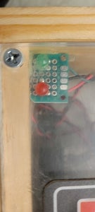

red LED and 200ohm resistor for power light
green LED and 200ohm resistor for keyboard flash light
4x4 keypad - from Amazon

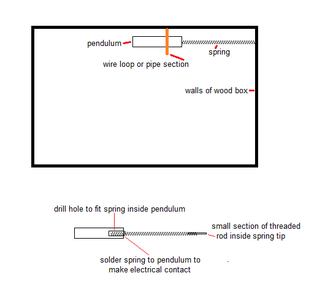

spring, and small weight to create the shake sensor.

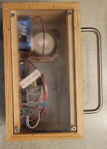

For the box you can use pretty much anything that is around 4x8x3 inches. You will need enough room for the shake sensor to move freely without being interfered with by wires, battery etc. I made a wood box but, anything available from a craft store would do. What ever you choose it will need to be of a non-conductive material.

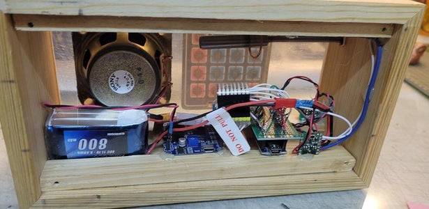

The three things that take up the most space are the battery, the speaker and the space required for the shake sensor. Figure out where you want your speaker to go. You will want it to sit flat up against the front cover so that the sound will be directed at the user. The great outside will suck up a lot of sound so you will want it to be somewhat louder than you think it should be. There is a volume adjustment on the MP3 board so you can program it quietly while the spouse is sleeping and turn it up when you're ready to use it.
You will need to cut slots in the front of the box to allow the sound to come out. You will need to strike a balance between letting as much sound out as possible and still protecting the speaker if it is dropped. I made five slots with a 1/4 inch router bit. After testing this worked well. Previous versions I drilled holes and it muted the sound so that it was hard to understand the voice.
Step 2: The Shake Sensor
The shake sensor is made using the principle of inertia. A small weight on the tip of a 3 inch long spring acts like a pendulum. When the box is shaken the pendulum moves back and fourth like the little door stop thingy that the cats like to play with. A loop of wire that is a bit larger than the pendulum is situated in a way that when the pendulum is waving back and fourth it will touch the wire loop for just a moment thus turning on the Pololu power control board. You will have to play with the size of the loop around the pendulum to get the effect that you want. The smaller the loop the less force of a shake required to trigger the board. I wanted mine to be able to ride in a car down a medium bumpy road and not be triggered. My weight is steel, 3/8 inch in diameter and 2 inches long. The spring that I have is pretty stiff so a good solid shake is required to create any movement of the pendulum. My loop is about 3/4 inch in diameter and is place about 2/3 of the way in from the tip of the pendulum. Your results will vary. You can move the loop closer or further away from the tip of the pendulum to increase or decrease the sensitivity of the assembly. The closer to the tip is more sensitive. Farther toward the spring is less. The heavier weight and weaker spring will make the pendulum vibrate for longer. You want it to shake for as short a time as you can manage and still be trigger-able without having to physically assault the box. The sensor is mounted to the side of the box by drilling a hole smaller than the threaded rod that is attached to one end of the spring. The rod is then threaded into the wood cutting threads as it goes. Just before seating the spring against the wood, wrap a wire around the threaded rod and then tighten the spring against the wood for a snug fit and a good connection.
Step 3: Do the Wiring
Connect the Arduino, MP3 board, keypad, power control and shake sensor as shown in the picture.
NOTE: the connection from the Pololu switch to the Arduino is whatever voltage your battery is. You will need to connect it to the Vin terminal of the Arduino to allow the internal power regulator on the Arduino to step it down to the 5 volts that is needed for the Arduino and the MP3 board. If you connect it to the 5 volt terminal on the Arduino you will get magic smoke from both the Arduino and the MP3 board.
You will need to create a way to cram all this stuff inside the box and anchor it with hot glue, velcro, or superglue. Understand this box will be shaken so nothing can be loose and floating around in the box. I used a piece of velcro to attach the battery so I could remove it for charging or for long term storage of the box when it was not being used.

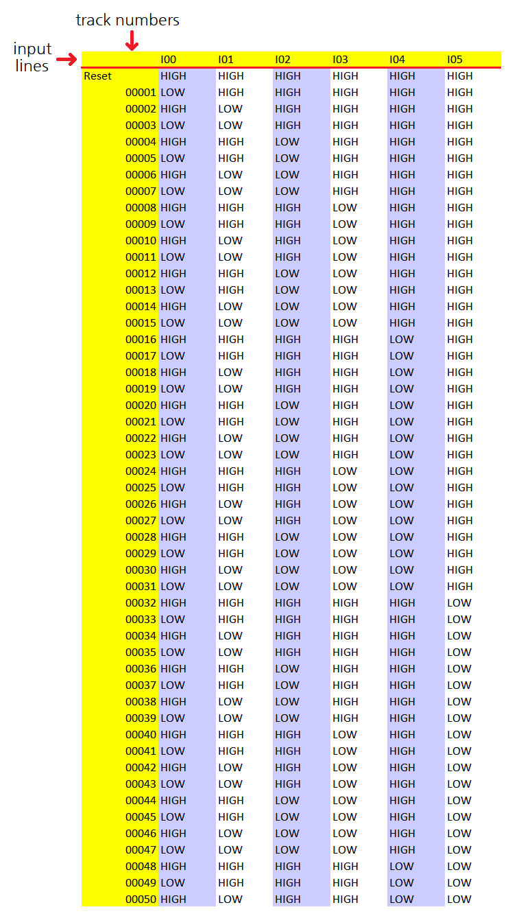

Oh one very important thing...actually two. First the MP3 board needs to have all its switches set in the off position which sets it to parallel binary trigger mode. Second when you name the tracks they must have a 5 digit number or the board won't recognize them and won't play them. (IE 00001, 00002, 00255, etc) The max number of tracks that the board can play in this mode is 00255.

  8. each time a button is pressed the red light will flash to let you know that a button has been pressed.

A little more on parallel binary trigger mode. The board has 8 inputs, We are only using 5 because we are only triggering a max of 31 tracks. If you look at the graph you will see how the Arduino is triggering each track by turning on a binary sequence then turning it off again. If you were to expand this graph all the way out to 8 inputs you would be able to trigger all 255 tracks.
