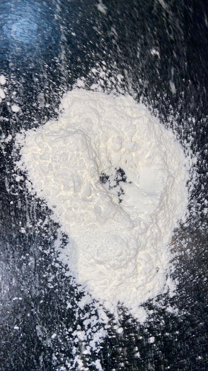

Step 1: Set 1: Make the Mixture
First, we need to create the mold. On a clean table/surface, put the cornstarch in the shape of a volcano, making sure you have a hole in the center. Once you have that ready, you need to work fast with the silicone because it dries quickly! Start incorporating the silicone with the cornstarch. Kneed it like dough to mix fully the two ingredients. To achieve good consistency, use a 1 to 1 ratio, depending on the size of the mold you want to create. The dough should feel like clay and should not stick to your hands. If it is too sticky, add more cornstarch, and if it is too stiff, add more silicone until you achieve the desired texture.

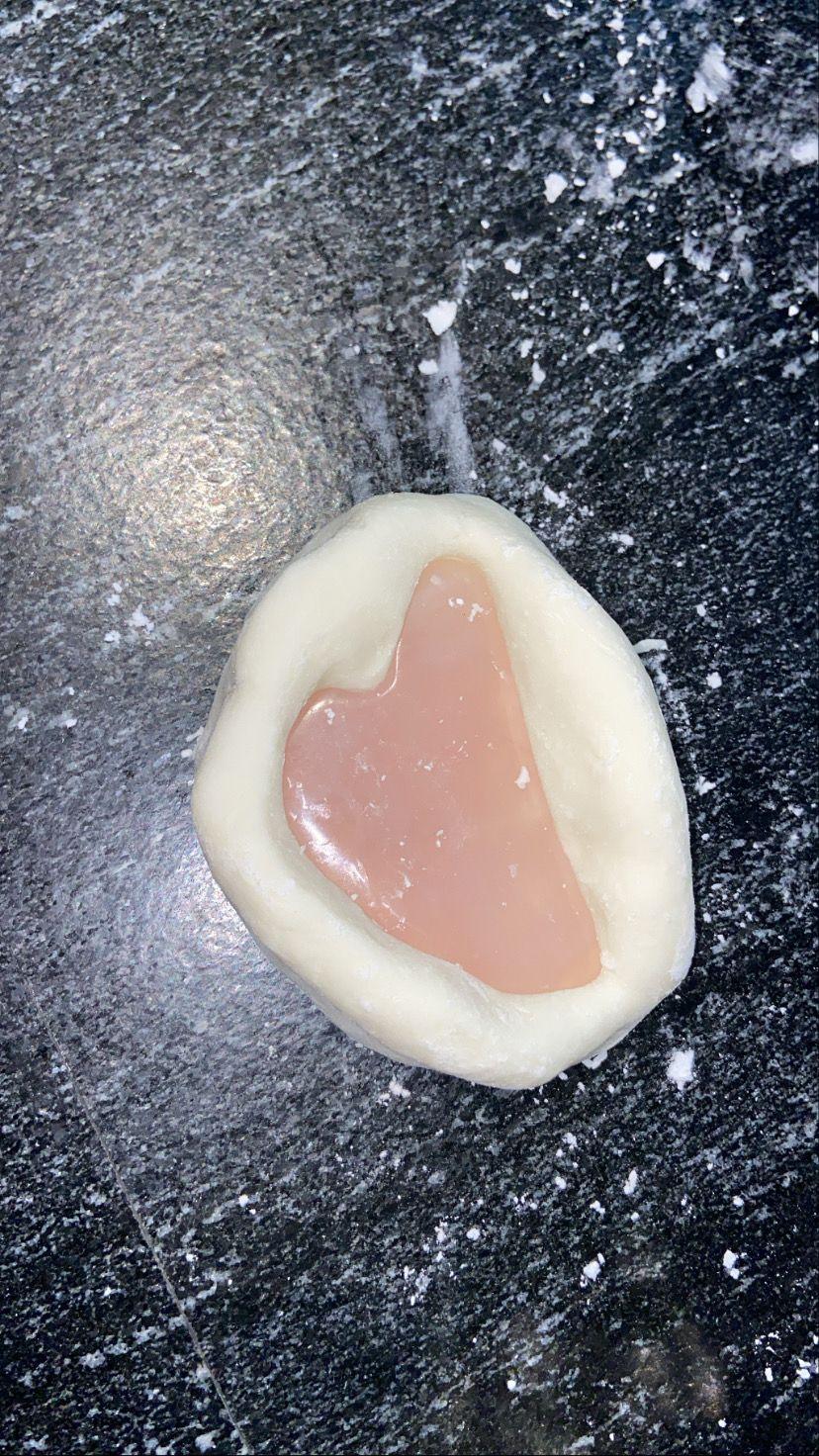

Step 2: Set 2: Make the Mold Come to Life
Second, once you have your silicone-cornstarch dough, form a ball, making sure it doesn't have any creases or air bubbles. Next, press the gua sha into the dough sphere until you can see dough coming up the sides of the gua sha.

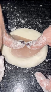

Step 4: Set 4: Out of the Mold
Once you have let the mold rest, and it is firm and cool to the touch, it is time to de-mold the quartz gua sha. Start by slowly separating the sides of the quartz with the mold, do it all the way around. Once the sides are loose, slowly take the whole quartz gua sha out of the silicone mold.
