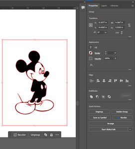

Step 4: Acrylic Cards (Part 3): Image Trace
Open Illustrator and insert the image of your choosing by going to the top of the workshop, where a bar of options are located: File > Place and select the image.
Then select Image Trace > Black and White Logo (this setting works best with the sharp cartoon lines)
  • The image must be selected for the option to pop up
  • The option is available in the black box right below the image and also on the far-right side of the workspace (make sure on the top-right, the Properties tab is selected) under Quick Actions
  • If you don't see the Properties tab, then go to the top: Window > Workshop > Reset Essentials

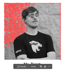

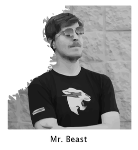

Step 5: Note for Part 3
When you have a more "complex" image, such as this picture of Mr. Beast, the option within Image Trace > Shades of Gray is best suited to capture all the details instead of Black and White Logo.
In the image above, the left is the original image, and the right is the image after Shades of Gray.
Tip: If your image is too large and image tracing is taking too long to process, select the image > go to the top > Object > Rasterize.
Step 6: Acrylic Cards (Part 4)
Now select Expand under Quick Actions on the Properties tab.
Step 7: Acrylic Cards (Part 5)
Now select Ungroup under Quick Actions on the Properties tab.
This just means that the white fill color is a separate entity from the black outlines.

Step 9: Note for Complex Images Like Mr. Beast
Right click the vector selection tool and choose the lasso tool. This will help you best separate Mr. Beast from his back group and leave only his silhouette.

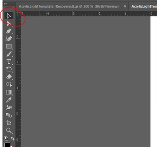

Step 10: Acrylic Cards (Part 7): Grouping
Click and drag a rectangle to select all of the black outlines. Then click Group under Quick Actions.

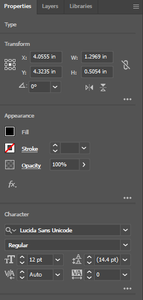

Now go to the left-hand side of the screen, there will be a bar of tools you can use. Select the rectangle tool and draw a rectangle.
To change the fill color and line color, select the rectangle >Properties tab and change Width (1.5 inches) and Height (2.25 inches), the fill color ("None"), and the line color (red) and line stroke (0.072 pt)
Step 12: Acrylic Cards (Part 9): Editing
Now resize Mickey Mouse to fit within the rectangle.
To resize, use the select tool (keyboard shortcut V) and hold the Shift key while dragging the corner of the image.
Step 13: Acrylic Cards (Part 10): Text
Use the text tool to write "Mickey Mouse." Switch between the select tool to move the text wherever you want.
In the Properties tab you can change the font. The font is up to you, but the image above shows the settings what I have for my cards. The most important settings for text design is under appearance and character.

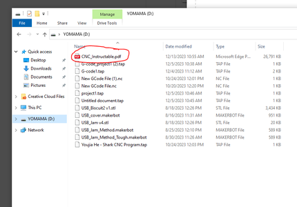

Step 16: Acrylic Cards (Part 13): Upload Into Laser
Now upload it to your machine and make sure your settings and procedures are good for the material you are cutting and the specific laser machine you are using.
I used a USB drive to upload the PDF onto the machine.

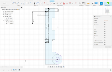

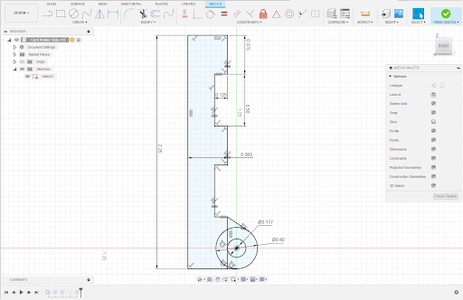

Step 18: Acrylic Card Holders (Part 2): the Backboard
There are three different parts to the acrylic card holder.
The first part is the backboard.

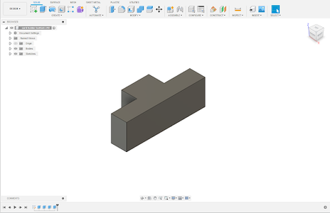

Start by creating a new part in Fusion 360.
Create a sketch of the backboard. Create a 2.25 in x 1.5 in rectangle. Add 0.125 in thick tabson the sides. On the bottom, cut out .125 squares from the backboard.
These tabs will allow for the parts to interlock with each other.
(See image for more detailed dimensions.)
When the sketch is complete, extrude the backboard to a thickness of .125 in (the thickness of the wood being cut).
Save the part.

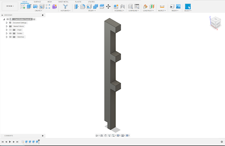

Step 19: Acrylic Card Holders (Part 3): the Sides
Create another new part and sketch the side.
Add tabs with dimensions that fit with the other parts.
Open a new design on Fusion 360. Refer to the pictures for specific dimensions.
Extrude the sketch to a thickness of .125 in. The hole should be aligned with the bottom so that when assembled with the other parts, the axle that fits through the hole will be behind the cardholder.

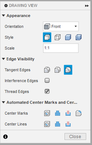

Step 23: Acrylic Card Holders (Part 7): Drawing
Create a new drawing based on the assembly model.
In the drawing, hide all of the drawing bordersso that the entire page is blank
Add in the drawings of the assembly to the page at a 1:1 ratio of size to preserve the dimensions of the assembly. Change the visibility of the different parts in the assembly and adjust the orientation of the drawing so that there is a unique drawing for each part.
Each drawing should show a different part (as shown in the image). Once complete, export the drawing as a pdf.

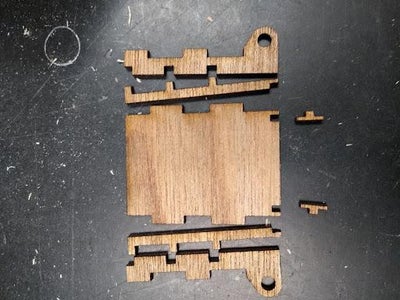

Step 26: Acrylic Card Holders (Part 10): Real Life Assembly
When all of the parts are cut out, remove the parts from the laser cutter. Use wood glue to stick the parts together, interlocking the tabs. Allow the glue to dry for a day or so, and your card holder is complete!

Step 41: Base Plate (Part 1)
1) Glue to combine the 3 similar base plate layers.
2) Glue to fix dividers in the 3 layers(shown above).
  • Only glue the side opposite of the cut hole so that the divider is flexible enough to slip in the card holders(more information next step).
3) Glue to combine the LED wiring layers underneath the 3 similar base plate layers.
Step 42: Card Holder on the Base Plate
The smaller circular pieces will act as the axles of the card holders.
Yes, you will need to glue them to the card holders for each and every one.
