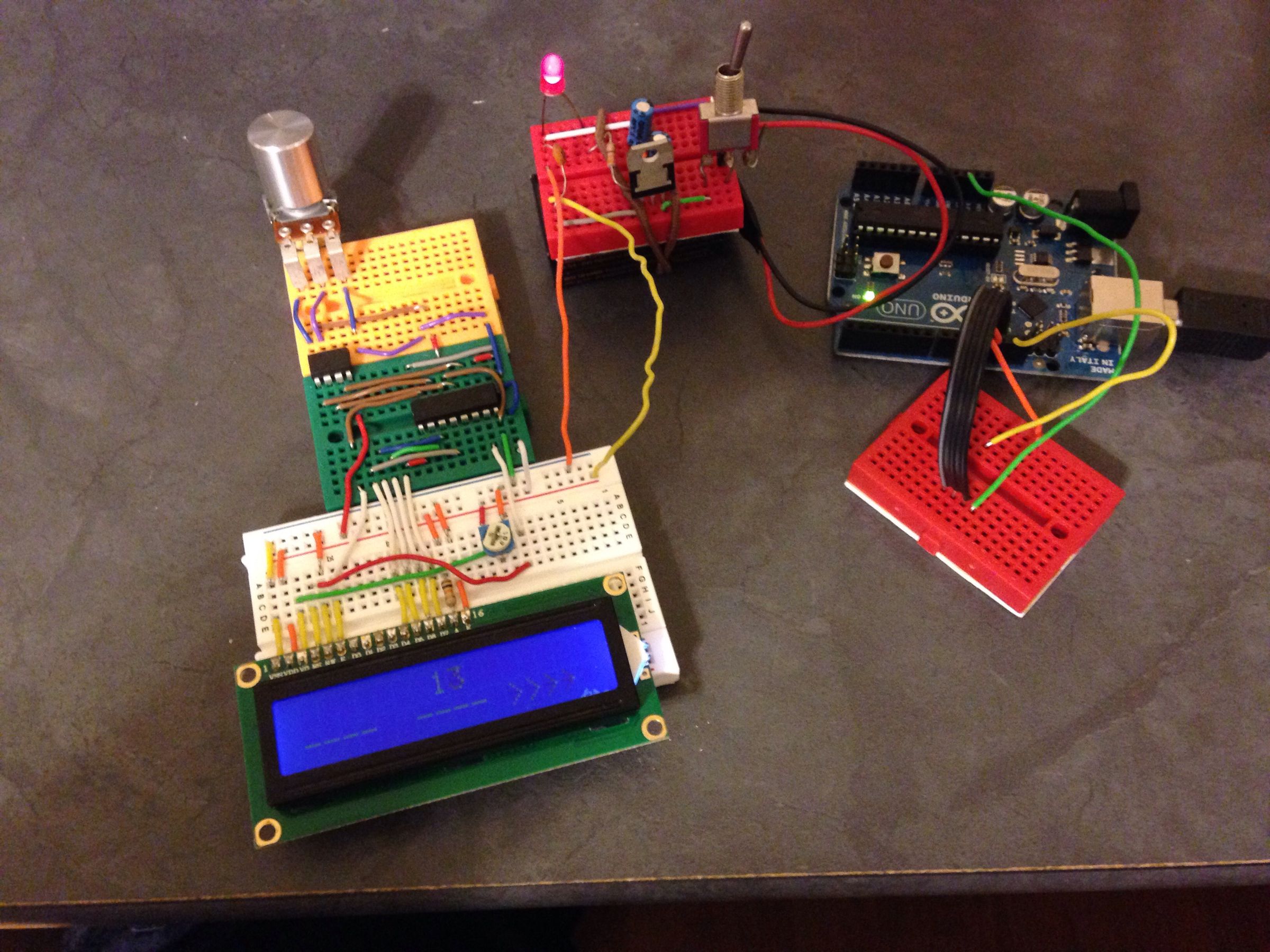

This is my second instructable using my already made 5V power supply, Attiny programmer, and LCD shift register breadboarded circuits. This is a more practical real world use of a microcontroller. Very simple. A momentary button and resistor are connected to one of the pins of the Attiny85. A greeting first displays on the screen for about 5 seconds and then the random number generator starts. Pressing the button stops the random number generator and the selected value and the corresponding card is displayed on the LCD.
